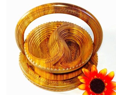

How to join this wood together?

I would probably go for a decent PVA type wood glue - pref a moisture resistant one. Both Gorilla (PU) and PVA type wood glues tend to be stronger than the wood themselves so should form a strong repair so long as the surfaces to be joined meet cleanly. Why I would avoid Gorilla (PU) glue is because it foams as it cures and you clean up after it has cured - something that could be tricky in this instance. A PVA glue on the other hand can have excess cleaned away with a damp cloth as soon as the surfaces are joined.
To make things more confusing though I've been using Gorilla wood glue, which is a PVA type glue, with good results!
Also I'd recommend wiping the surfaces to be joined with a solvent to remove any oils from the surface of the joint (in case the wood is an oily hardwood) prior to glueing.
Thanks @Chud I didn't know whether normal PVA glue would work because of the tension on the spiral.
@just pumps It would be quite fiddly to do this. Don't think normal clamps would fit.
I wouldn't use 'normal PVA' I would use a specific wood glue like Titebond 2 or 3, Gorilla Wood, Evo Stik (blue) etc...
If it really is under tension, then any of the PVA glues will allow "creep" over time. You want a glue that doesn't do that. Cascamite or epoxy I'd have thought.
Actually cascamite might be a good choice as per Dave54's comment.
Thanks for the advice. Gorilla wood glue worked perfectly. If it breaks apart again, I'll use cascamite.
