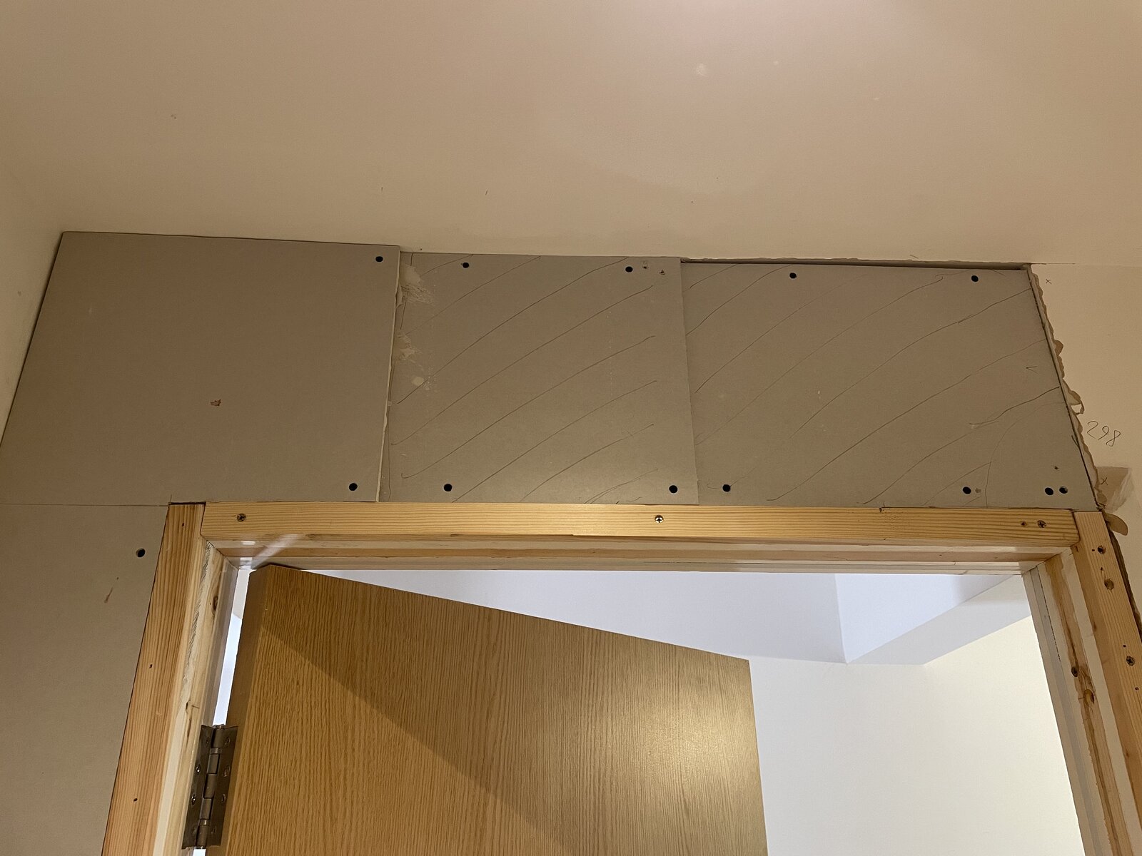

How to level stepped plasterboard?
28 Apr 2021
285
3
I have an area above a door where the plasterboard is stepped because the stud framing was off. Can I just apply bonding over the shaded bit to level it ready it for skimming? Also , do I need to prepare the joins and edge at the ceiling with mesh tape or paper tape or can I just put bonding over it? (I probably won’t skim it myself)
Why not take off the boards and put packers at the back to bring to correct level.
That sound more difficult than applying bonding…what kind of packers and how would i pack the angled timber? Would using bonding cause problems?
Those three pieces need to be removed, the studs made perfectly level, then a new piece of PB fixed in place. Failing that, make some timber packers, trimmed to size/thickness.
What would happen if I used bonding to level this area?
