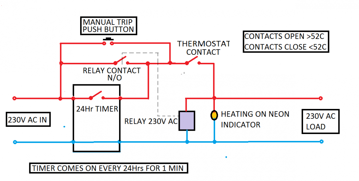

Check if I understood your requirement:
You want a 24hr timer and thermostat combination , where the timer comes on once a day at a specific time, for a very short period just to knock the heating system on, then when the water temperature reaches 52c, the system switches off until it gets kicked in again by the timer next day.
Simple solution is to uses a 24hr timer that kicks in a relay that latches on through the thermostat, if thermostat is already at 52c then it won't need to kick in, as the thermostat would be open contacts, so no heating would kick in, if the thermostat is closed i.e. water temp below 52c, the relay comes on and latches on via one of its own contacts, until the thermostat knocks it out and there after it won't kick in until the next day at the same time.
An override switch (push switch) can be used to kick in manually if the water tempt is below 52c, use a mains neon to indicate status.
diagram coming in case you are confused. The system will only latch on if thermostat is below 52c, The push button must be rated to accept full rating, so bear in mind this switch must also be able to handle mains voltage and current.
Earthing is not shown for simplicity.
(Very similar to what John D described but without the drawback of heating on for 5 minutes even if the water was already at 52c, the trick is in arranging wiring and not having to use a two pole relay or another series thermostat)
You can use the Manual Push button when for example your hot water has all been used up and the thermostat contacts are now closed asking for heat, but the timer may not have come on yet and is considerably long way from its set time and you need more hot water, so pressing this manual button momentarily will latch relay on, start heating your water again, and later on when the timer actually comes on, and if the water is colder than 52c, it will start heating again, but if it is still above 52c, then the relay will not energise and after 1 minute the time will expire and no further heating would kick in until next day kicked in by the timer or manual button.

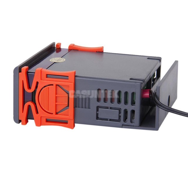

There will be a ideal run time, as said you want it to run for around 20 minutes at a time, rather than 5 minute bursts, but also you want it to always be above 60°C so no bugs multiplying in the water, so using some thing like the InkBird 308 set to maximum differential with maximum delay and no timer as such, will ensure a reasonable run time and maintaining the water over 60°C. The InkBird Instructions seem to say the compressor delay is only active on cooling, The user manual of MH1210A seems to say the delayed start works both heating and cooling, although I have not tested. The E1000 controller is replacing the STC-1000 and has touch controls, however I think again delay is only on cooling like the InkBird with no delay on heating.
The MH1210A temperature controller at under £7 from Ebay will likely do the job, but does need putting in a box
