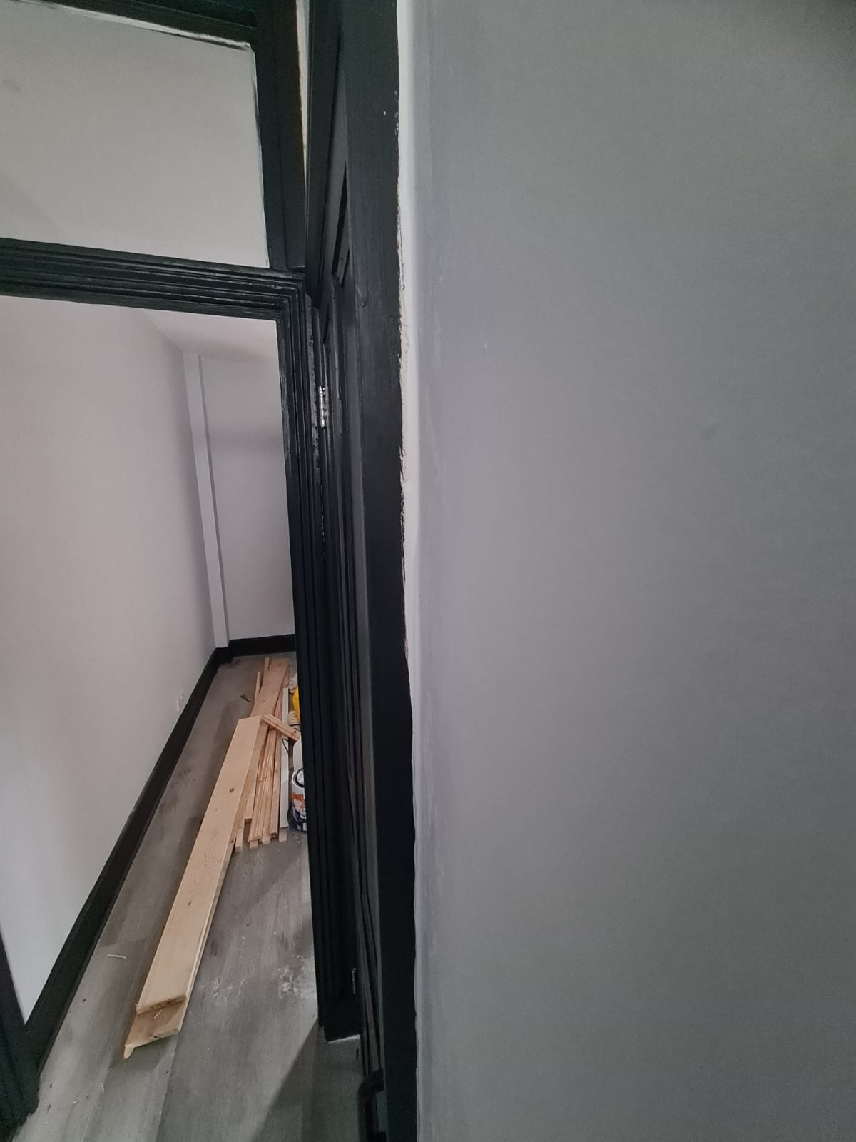

Hi All.
I am trying to get a nice straight line by door frame corners and the wall, and the technique I hvae always read about is to tape off one side, then paint and remove the tape. This way you will be left with a straight line.
I have not been so lucky, I painted the skirting dark grey which is very unforgiving with non-straight lines. Anytime I tape off the wall, and remove the tape off within 5 minutes it peels off the paint. I even went to the paint shop to ask for a low tack masking tape, same issue. Any suggestions please ?

I am working on (a bloody messy) site where the architraves are black and the walls an off white.
I prefer to cut the wall in to the woodwork. I find it easier to run a two inch or larger brush along the wall than the 18mm edge of the architrave. By eye, I can generate a straight line. I use lamps to create shadows where the two surfaces meet and follow the shadow line.
The decorator that is already on site is a fan of using low tack paint on the plaster. Unfortunately, he is also a fan of EasyFill filler and painting over it will undiluted emulsion.
He runs the tape down the wall, paints the black woodwork, pulls the tape off... it pulls the emulsion off. The paint additionally bleeds under the tape.
To make things even worse, he is also fond of painting over a particularly poor quality caulk before it has fully cured, meaning that horizontal hair lines appear which means that as you cut in, the paint, through some kind of capillary action, tries to deviate up the crack. it may only be 0.25mm but when using black and white it is noticeable.
