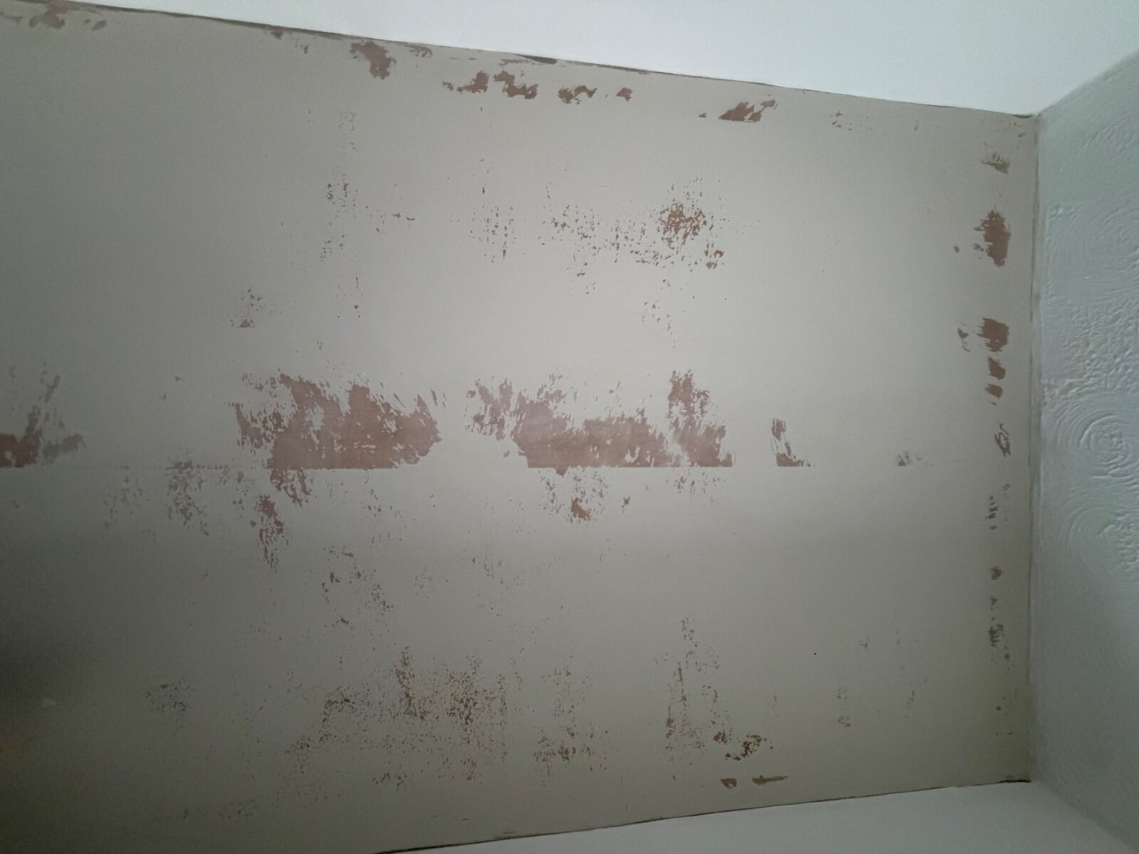

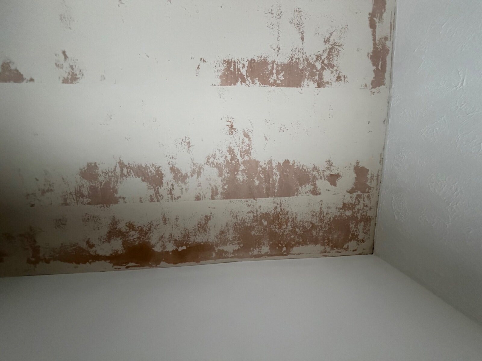

I’ve stripped previous owners wallpaper off a couple of walls in a 1st floor bedroom. Typical terrace property.
The wall surface under the wallpaper looks like a mix of paint with patches of raw plaster.
What do I need to do to prep these walls before painting with the coloured paint (top coat)?
In other rooms where there’s no wallpaper I’d fill any dents and holes and sand those areas back. And then paint a couple of topcoats over the top. Never normally prime them with white unless the colour is very dark or a specific reason.
Attached a couple of photos of the wall surface

Bodge cheap orbital sander on a vacuum with 120 grade.
That will take paste off then fill over wall with toupret powder filler.
Some use a ready mixed wall smoother but I think the toupret can be easier and cheaper if not too bad.
Orbital sander again with 180 grade.
Gardz to neutralise any remaining paste and seal the wall ready for emulsion.

The wallpaper came off very easily. Wall has been washed again. Doesn’t feel like there’s any glue residue left on the wall when touched by hand.
There are no holes in the wall that need to be filled are you suggesting to skim the hole wall with powder filler?
Wet the wall to see if there is any paste.
I've never been able to wash it off. In the early days before sanders paste was a problem at times.
Maybe gardz and paint then if it's good.
You could risk just emulsion if you want but any paste could react
Thanks.
Got some left over emulsion. Might just paint a small patch and see what happens.
How will I know if the paste is interacting with the paint? Presume it’ll bubble or flake off?
Don't paint the wall if there is paste residue on
Wet the wall and if it goes sticking there is paste.
Coat with Gardz first
