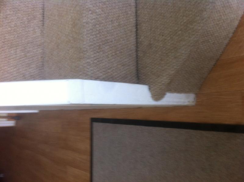

Good afternoon guys!
I am a new member so please be patient with me! :LOL:
I would like to know how I should go about putting a newel post on my staircase so I can put a hand rail and some spindles.
I have uploaded some pictures in a album format. I've named it bottom of stairs.
I would really appreciate the help.
Thanks in advance!

You could simply screw the newel to the base at the side , you will then need to increase the thickness of the edge to accommodate the base rail which holds the spindles.[A halving joint may be required which will allow you to get the post central to the edge of the stairs.]Really depends on the dimension of what you have.
