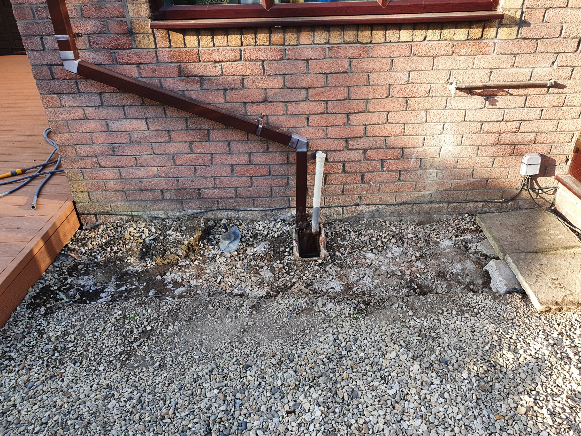

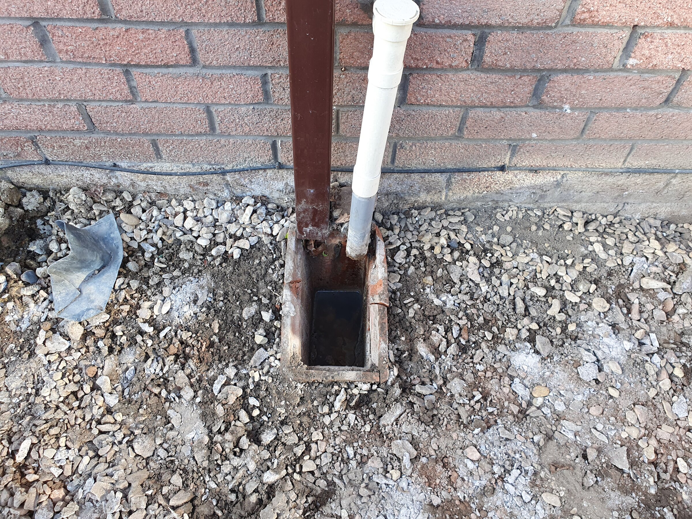

What do you experts say? Grey water and rainwater drain into a gully that needs to come up by 15cm, it used to be underneath a concrete path that was used as a hopper, now I'm going to use gravel. Is there something I can buy off the shelf? I have an idea to use a 110 plastic hopper with a concrete adapter. The cracks in the gully are only around the top where the path was chipped out, otherwise it works fine and doesn't leak.

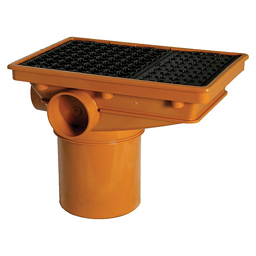

A tall plastic hopper and an AC4000 (y)
Or even better, a 4D900 with a bit of 6” pipe to raise the lid.
Bizarrely, a thing called a gully hopper extension!
Underground-Drainage-FloPlast-110mm-Rectangular-Drain-Inlet-Hopper-Terracotta~H9504_435196_00
Polythene bag around the gaps before concreting around it

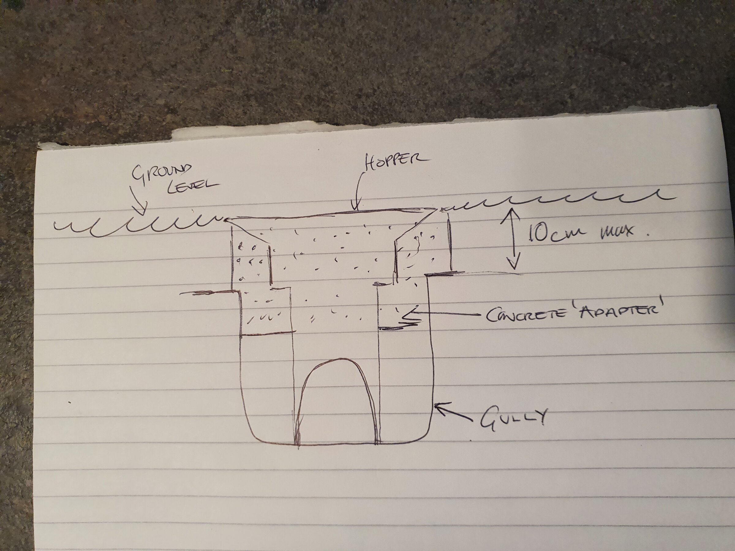

Great thanks you guys! I was just thinking about this and drew a plan.
How would I stop gravel coming in through the grate? Concrete into the holes?
