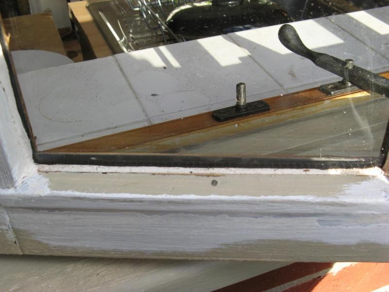

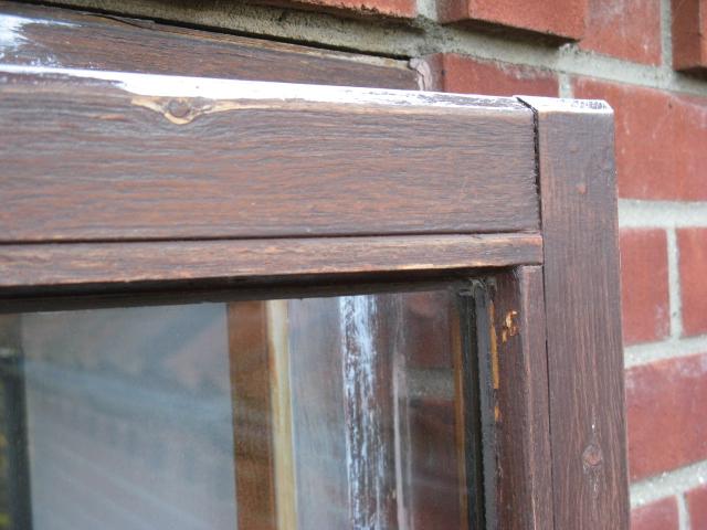

Hi all
I did not mention it above, but as part of the work our chap replaced some units that had failed and were misting up. He's changed them today.... From what I understand, the silicone should cross from the wood to the glass, but it is not doing this on our job.
Here are some pics:
Obviously the painting has not been done on top of the silicone yet. When it is done perhaps it will bridge the "gaps".
What I wondered was whether the siliconing in the pics is good, ok , bad, awful, etc etc....?
Cheers
Max

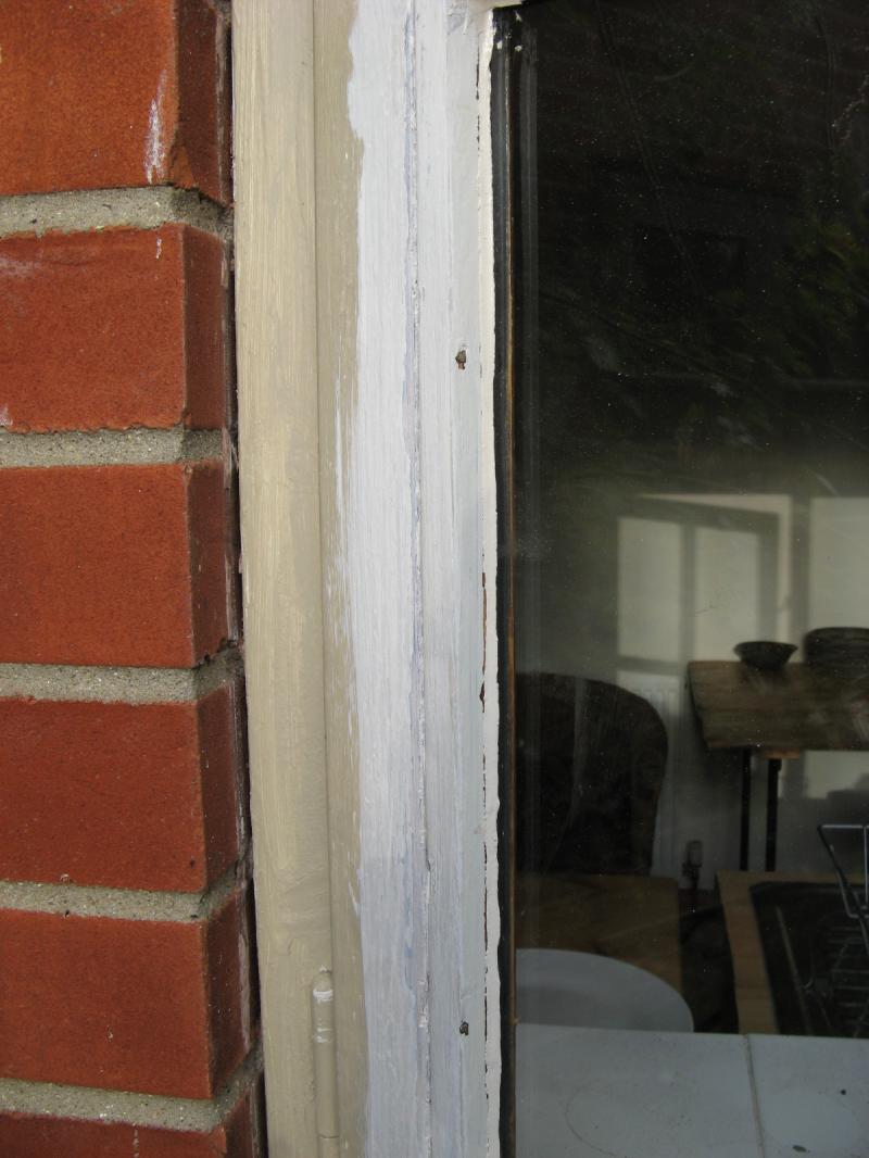

Hi again
The pics above are part of a long line of workmanship I've been less than pleased with. I'm seriously thinking of calling the guy up tonight and sacking him or at least having a very serious chat.
Turns out the stuff he's used is not silicone, it is Evo-Stik Frame Mastic (trade only). From what I can see on the internet, this stuff states it is "Not suitable for bedding double glazed/insulating glass units into frames". Do the pics above count as "bedding"? When he actually installed the units he used some kind of tape around them. The mastic was only used as per above (to ***TRY*** and seal the wood to glass join).
The mastic looks awful the way it has been applied, and if it is the wrong product entirely then I'm not a happy customer!
To help make my mind as to what to do next, would someone please be able to tell me whether I am going to be able to remove the mastic if needed so that I can apply the correct product? Will the new glass panels still be ok or is there a chance they could be damaged/not able to be re-used?

It does look like a bit of a gash job to be sure, Max :confused:
I can't comment on his choice of sealant as I've never used that one but it doesn't sound right, does it?
Double side sticky tape is commonly used to secure the glass units these days, but that doesn't help your issue.
Personally I'd get rid of that sealant, level with the glass beads, and then apply a line of masking tape on the glass, around 3mm from the edge.
A bead of clear silicone should be applied, followed by a finger smear that presses the silicone into the bead corner, and on the tape. Peeling the tape away after that gives a perfect straight edge.
I don't know how well that stuff has taken to the glass, but the edge of a chisel blade usually shifts it.
