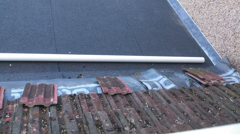

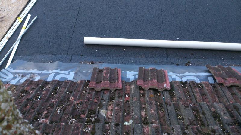

Hi there, I am due to re-tile an old tiled roof due to the fact that so many tiles are damaged, I however am unsure of how to tile over my layboard where the roof merges into a flat felt roof. Images are attached, and advice is appreciated. Thanks, Charlie.
Or do you mean the layboard is too thick to tile over? If so then you will have to cut some of it away to allow the tiles to fit.
Keep the tails of the tiles from sitting on the flat roof felt though.
