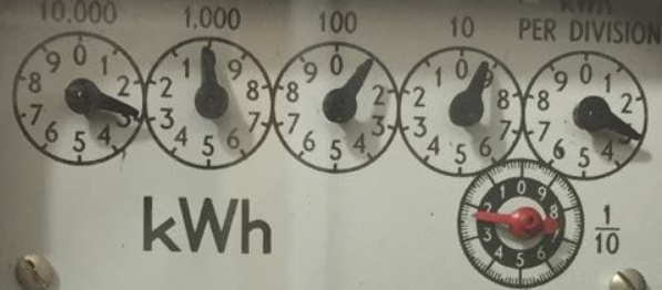

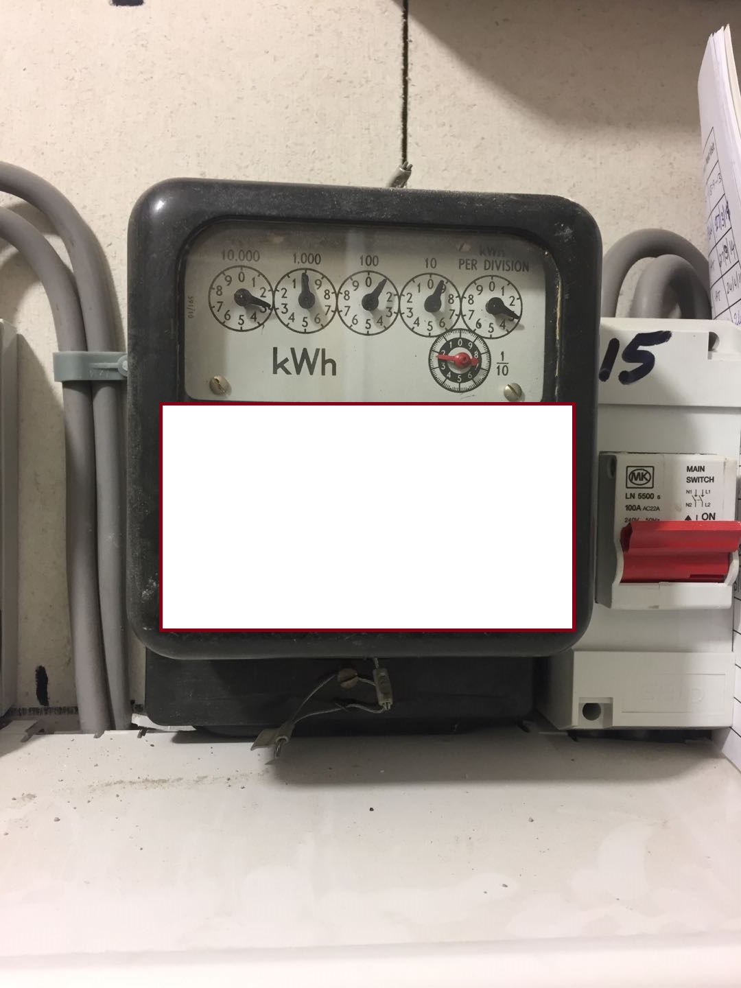

I got confused reading my dial meter. According to the guidance, it should be 20093, but as the position of the first pointer is very close to 3, shouldn't the second pointer be like 7, 8 or 9, rather than 0?

If you know what the reading was last time, or if you take the reading again tomorrow after it has moved a bit, you may be able to deduce what the numbers are more easily.
If you look at them, or photograph them, dead-on, rather than obliquely, you will be able to see more accurately where they are in relation to the index marks of the dials.
Yes but it's the other way round.
As the pointer of the second is near zero, the first must be 3.
Start from the right -
Red pointer - .2
5th pointer - (clearly not .2 past 2) so must be 3
4th pointer - (clearly .32 past 9) so 9
3rd pointer - (not .932 past 1) so must be 0
2nd pointer - (clearly .0932 past 0) so 0
1st pointer - (not .00932 past 2) so must be 3 - even though the needle is not exactly where it should be.
Therefore 30093
Thanks, now I understand it should be 30093, but my landlord just gave 20093 to the energy supplier (he made this mistake reading). So I have to tell the supplier to change this!

Personally, I think the meter is likely faulty. These old ones rarely have so many pointers so close to a number. Your supplier would replace this type of meter for free.
Well, obviously it is rare but happens every 10,000 units.
As EFLI has said, that seems to be very strange logic. The meter may, of course, be faulty, but even a non-faulty one will, inevitably, occasionally show the sort of thing we are seeing here.
Another way of wording your comment would be to say that the meter is 'likely faulty' because the reading it is showing is very close to 30,000 - which would obviously be a little silly!
