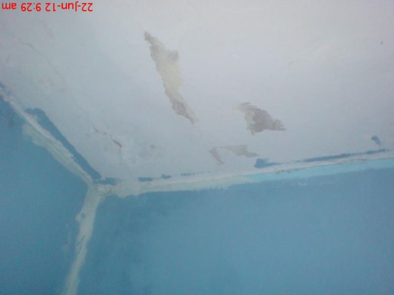

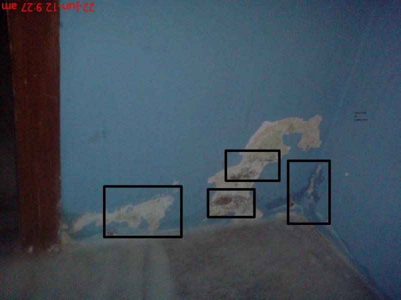

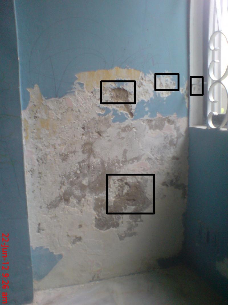

As i been scrapping the wall when i had the time. i have uploaded the pictures of the wall where i am facing this problem.
the wall is made of machine block, 6 inch size. with the mixing of clear sand and cement plaster of around 1/2 inch on it.

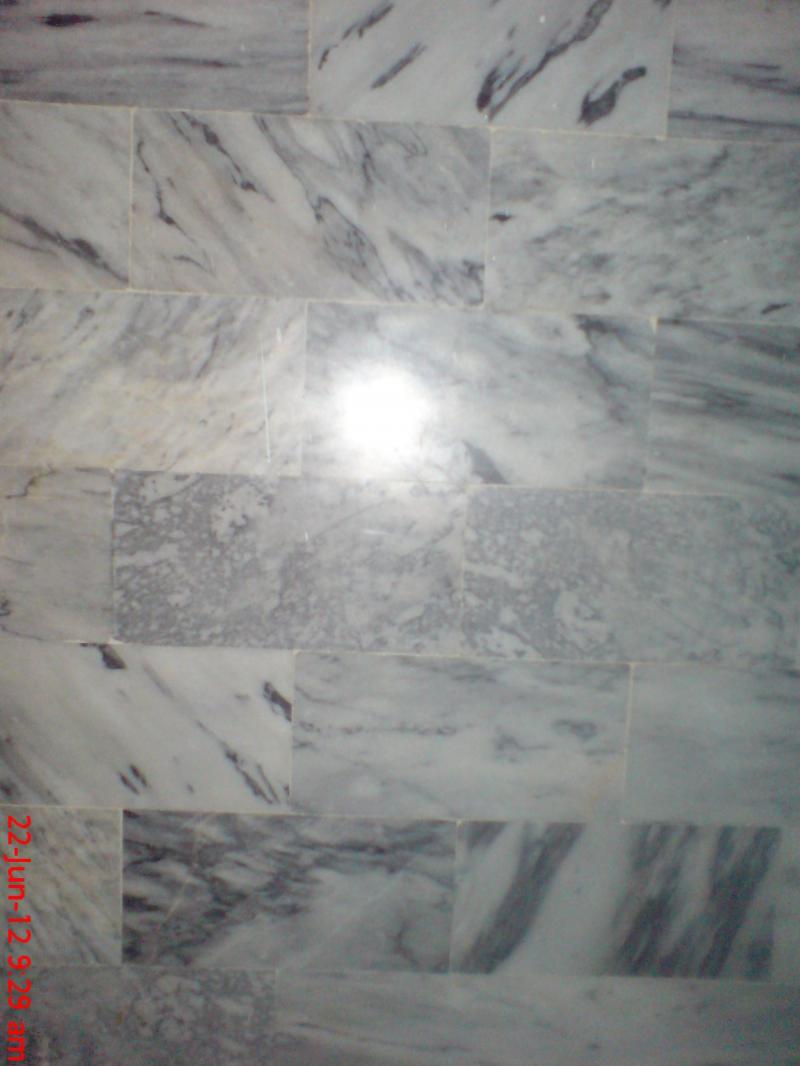

on the wall behind the bathroom i have notice only few damp in the paint but not coming off with like hair on it... and again not from below or up but somewhere in the middle eventhough the bathroom wall is covered with marble slab.
and thank you for any help and replying back
the final picture in particular looks like the wall is damp. What is on the other side of that wall?
If it is an external wall, is water dripping off the roof or gutter, or is there a bathroom or pipe?
no the other side of the wall is the interior wall main hallway into this room and strangely, that part of the wall is fine and have no such problem like these, just this room.
the other side have also have windows looking into the garden.
