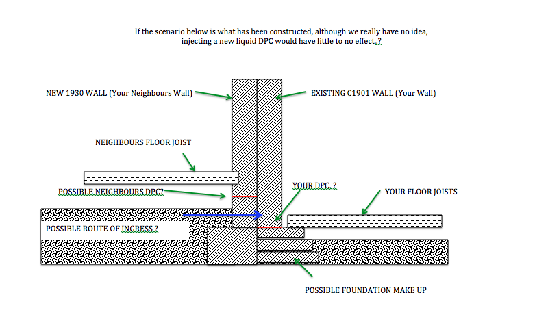

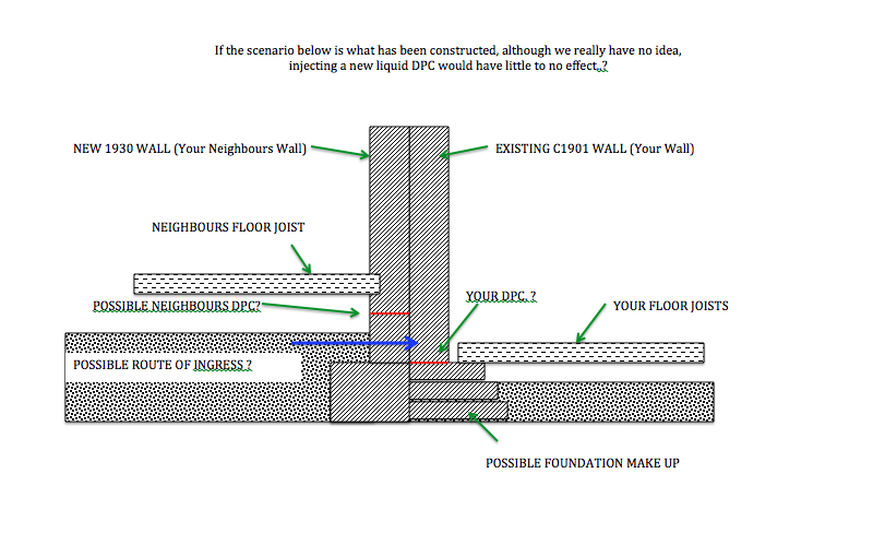

A thought.?
Great diagram, and exactly how i think the setup is here.
Every wall in the house has a step-out (part of the foundation) as pictured in your diagram. See the picture below of under the front lounge floor - you can see the wall plate sitting on this step.
View media item 77343
If the construction is as your diagram, presumably this is a problem caused by shoddy construction back in the 1930s?
The question is what to do about it? I can't really lift my neighbour's floor to get it tanked or dig his subfloor out so it doesn't bridge my DPC?
