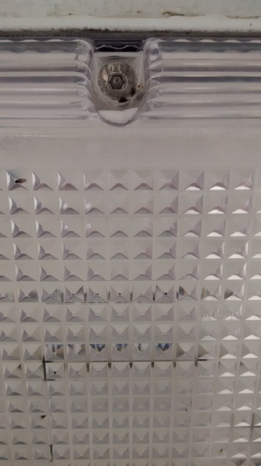

How to remove this light cover?
29 Sep 2015
67
Its an outdoor light. I want to remove the cover, I've tried a screwdriver but it's the wrong tool. How can I unscrew it?
security screwdriver bit. They come in sets. Looks like you want the hex with a hole drilled in the end.
There was perhaps one supplied with the lamp.
Thanks for your responses
I'm new at diy, do I need an electric screwdriver to use bits?
Adan,
Very good question - especially as the kit I showed you does not come with a screw driver (doh).
No you do not need to buy an electric screw driver for these, you use a special screw driver that has a hole in end to take the bits.
(the one at Poundland is just like that - a screwdriver and a several screwdriver bits.
This is a more professional screwdriver version from Toolstation (does your hole look like one of the bits shown?):
https://www.toolstation.com/shop/p57505
and here are some more (cheaper) bits:
https://www.toolstation.com/shop/p52910
And one frm screwfix that I bet they also sell at Homebase and perhaps B&Q:
https://www.amazon.co.uk/Rolson-Too...9930&sr=8-18&keywords=Ratchet+Screwdriver+Set
And Aldi (but these bits look very poor metal)
https://www.aldi.co.uk/22-piece-wrench-screwdriver-set/p/082842220129901
SFK
Why do you want to unscrew it? The fact that they’ve fitted a “tamper proof” screw suggests that you shouldn’t normally need to...
