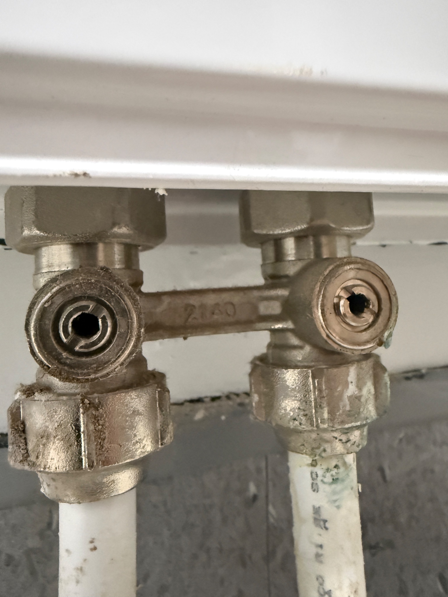

Hey all,
As per the title, how do I remove this rad?
Turn the two slotted bits on the valve near the floor, clockwise to close. You might need to use an allen key in the holes.
Loosen the larger top nuts to disconnect the radiator, there will be water in it.

Super! Thanks
