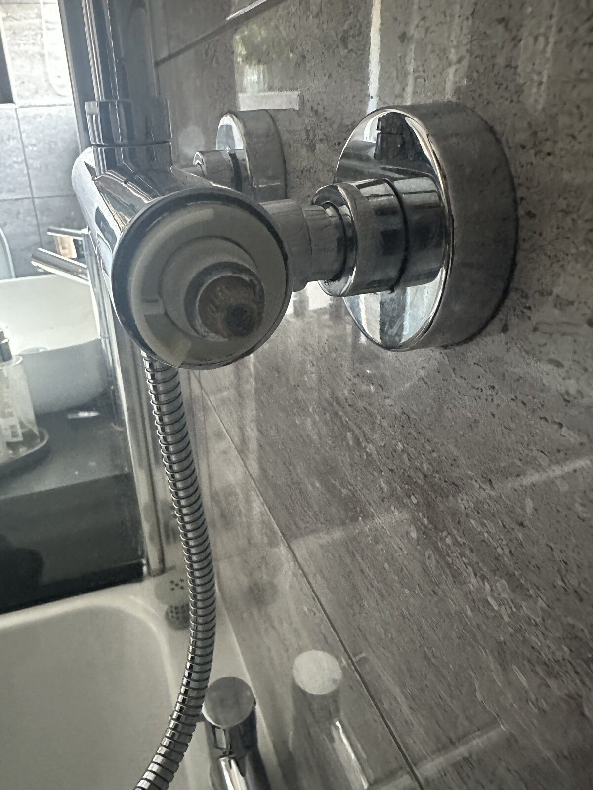

Hi, advice please. How do I remove the valve in my shower. The hot is not as hot as usual but I can’t see how to remove to check/replace
Photo attached
Pull the white plastic off.
Some are held with a grub screw through the body so run your finger around to feel for a hole.
Otherwise they are screwed in.
You will need the water off to avoid excitement.
Hi, just to close the thread. I’ve found the instructions, You remove the white plastic as suggested then use a 22mm box spanner to remove the valve/cartridge
