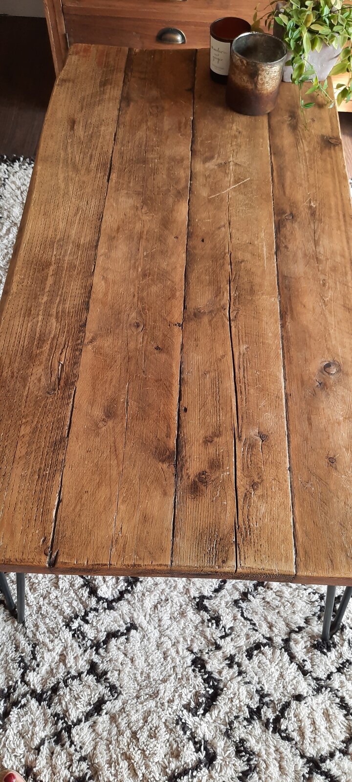

Good Morning,
I have a coffee table made from reclaimed scaffold boards and it was originally varnished in a dark stain but I would like to remove this varnish as I'd like to have a more natural, light-coloured wood.
Can someone please advise on the best way to do this myself at home? I live in a flat so I don't have a garden or shed so I need to try and do it in the least messy and non-toxic way. I do have room on my balcony though if it needs to be done outside.
Any advice would be appreciated.
Thanks.

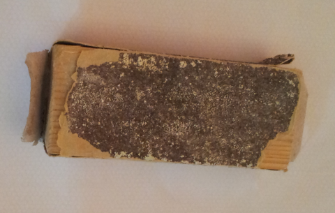

With a sander. Here's mine. I use it on windows, doors, walls, you nameit's. The dust stays close to the sander.

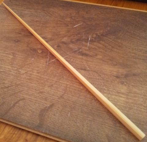

Here's one of my current work pieces for wood repair/adaptor. I need one end to be 1 micron thick. Impossible with 40 grit, but I try.

That does not appear to have been stained, maybe dyed making removing potentially impossible ( stain isn’t varnish and it looks unvarnished)?
end grain looks the same shade as the surface, may be it has just had a bit of wax rubbed into it
what type of wood is your guess ? I'm thinking soft, maybe poor quality plain sawn douglas fir ?
one of the knots looks like it is not far off being loose and the third board is cupped and split.
it could still look OK if plained, scraped, sanded, danish oil, and buffed up after a month or two.

She states reclaimed scaffold boards so probably spruce .
They don't look like scaffold boards to me. They are often 38mm thick and and 225mm wide.
