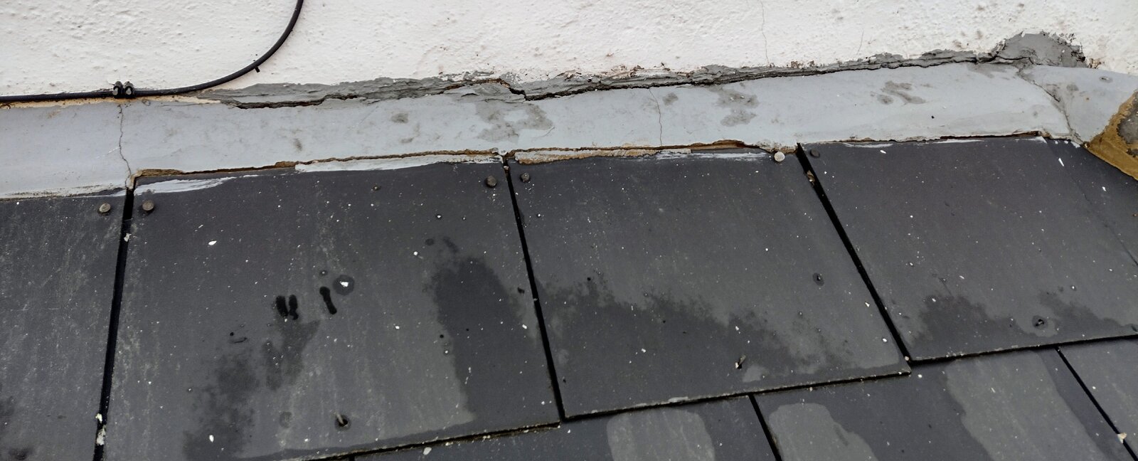

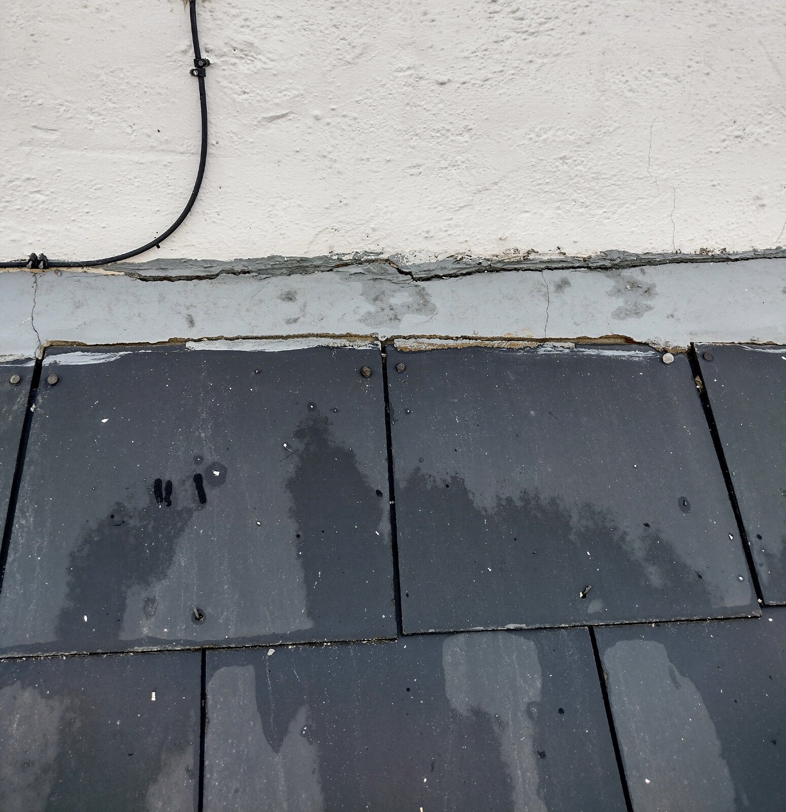

Pitched roof above bay window has cracks and gaps between roof tiles.
Subsequently, a little water is seeping in
Based on the pics, can any roofers explain the best/simplest way to repair this job

A lead flashing - ANY lead flashing, would be good. (y)
The correct way is to have say a 150mm margin of un-rendered masonry between the roof surface and the the render bottom. The lead flashing should travel a distance horizontally so that it weathers the tile head (100mm+ or so) and vertically about 150mm. The render bottom is then finished with a bell bead, so that drip of the bead just covers the lead chase joint.

I am not confident/comfortable using lead due to a lack of experience at the moment.
Is there a simpler/ solution for the DIY'er?
Like perhaps chasing the crack and filling with some sand/cement/silicone?

Warm sunny weather and chilly nights are your enemy. At the moment that roof is flexing and moving. Unless you fit a product that has separation from the wall-to-roof, it is likely to split again. Mortar does not like to stick to smooth slate. You may get away with a flash band repair on a nice warm day.

can a diy'er with no roofing experience, but with patience and research do a decent lead flashing job?
Depends upon access, dexterity, available tools etc. Not the hardest job, as long as you understand gravity and water travel. Always begin at the lowest point.
I will give this a punt, when i have the chance and after some research.
