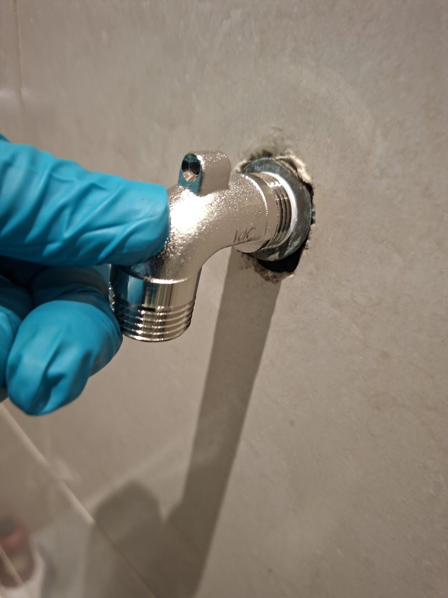

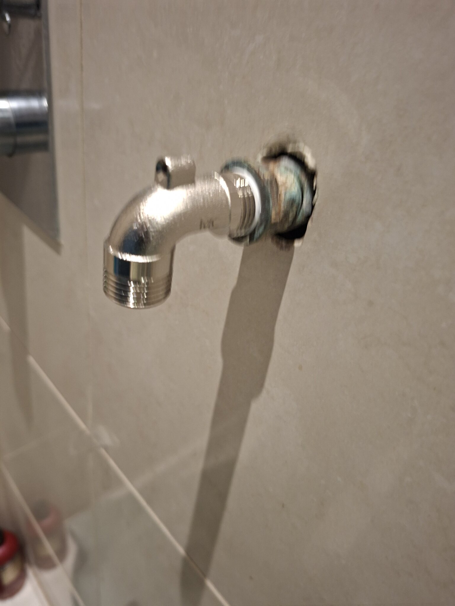

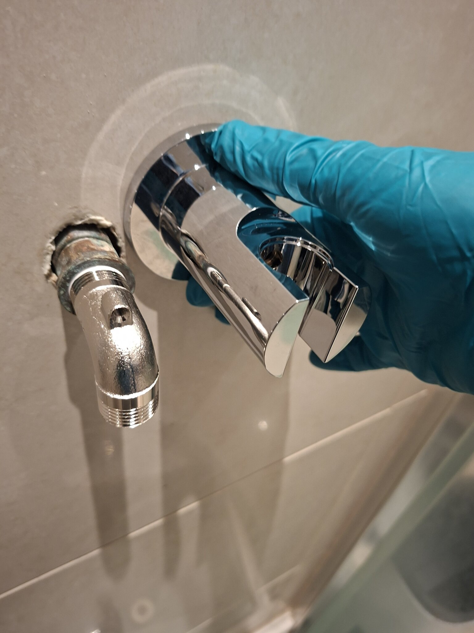

I wonder if someone could advise me. I am replacing old Groche shower handle wall integrated bracket. The pipe was secured somehow but came loose behid the tiled wall (see photo). The connector has to be pushed back and stay in for the bracket to be nice and flush (see photo) but the pipe pushes it out so strongly that it's hard to hold it in place by hand. Is the a way to secure it somehow? I did try to wedge something and glue it perhaps but everything I tried just slides out. I want to avoid drilling as they are extremely hard porcelain tiles ( wasted 4 diamond drill bits to secure a radiator!) Any ideas? TIA

Fastening a tie wrap aroung the pipe part and then tap it through the hole with the fastening at the bottom of the hole may secure it. But you may need to try different sizes

Thank you gentlemen. Looks like the resin is the way to go. How long does it take to set?
If its warm... Minutes.
Rig up a brace to hold it back into the wall or just hold it there by hand.
You could probably also use 2part filler like isopon.
