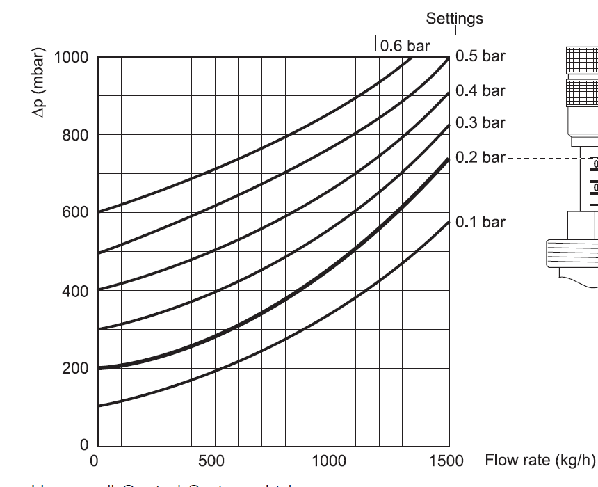

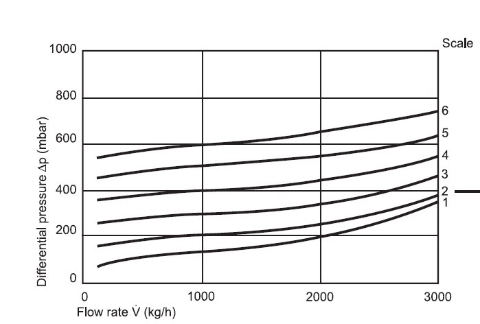

Is the by pass a (angled) Honeywell DU145 and what setting is it on? these angled ABvs for some reason or other give huge bypass flows. Would suggest setting it to index 3.5/3.8.

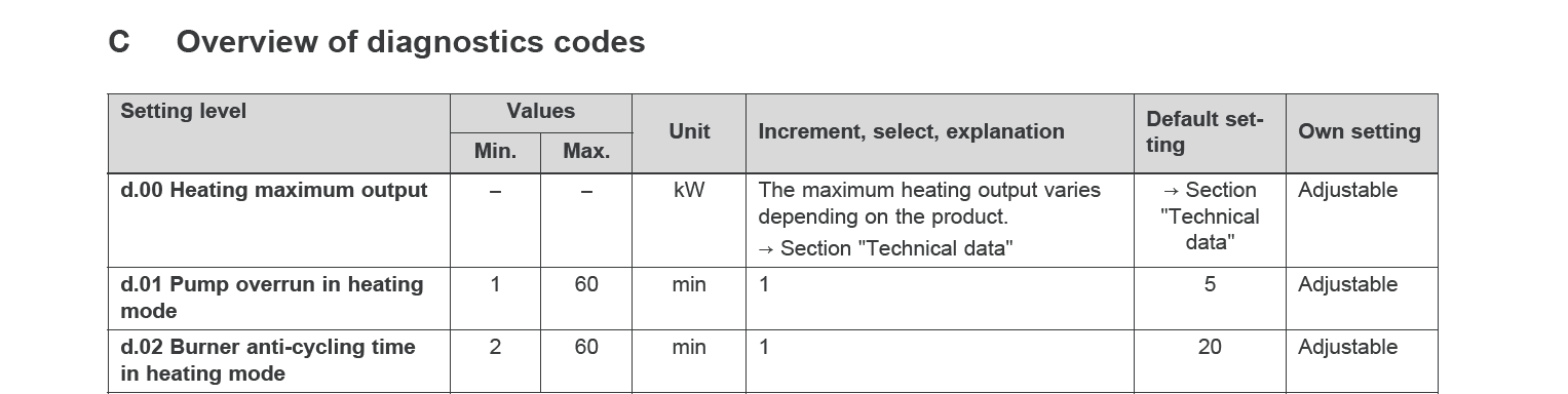

Can you check these boiler d settings.
Should also have asked what is the target flow temperature?, and when/if its running can you check the flow/return temps d.40&d.41.

Honeywell straight connection which is set at 4. Boiler is firing up from cold and continues up to running temperature which is set at 62C flow. It seems happy with all TRVs open but temp starts rising beyond the 62 and in anti cycle mode once TRVs start closing. Temp then goes to 66 and into anti cycle mode.
d40 63 d41 53 ish.
I am now also looking at the partial load setting. 24kW boiler but my loading is about 12.5 kW. Tried putting it down to 16kW but it did not like it nor when set in auto. I've put it back to 24kw for now.

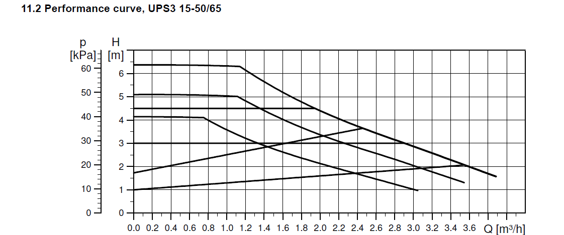

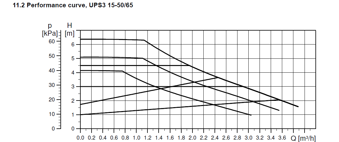

Its a UPS3 set on constant pressure 1.
Therein lies the problem.
CP is for UFH and doesn't play nice with AVVs.
Either fit a manual bypass (tacosetter) and use PP or use CS.
You'll go round and round in circles unless you set the pump to match the bypass.

Your ABV will be doing absolutely nothing at a setting of 4 as the UPS3 CP1 setting is a constant 3.0bar, maybe worth looking at this and also note carefully d.41 as the TRVs start throttling in.

Yes, even though I have set up one (UPS3) + ABV running on CP1 without a manual bypass, it is better although the UPS3 in effect doesn't have any CS curves, it has 5 CP settings and 2 PP settings, (you should have a look at the UPS2 8M pump), If yo.u look closely at the CS settings there is a very very gradual fall off in head, any "true" centrifugal pump head will start falling as soon as it starts pumping
Yes, even though I have set up one (UPS3) + ABV running on CP1 without a manual bypass, it is better although the UPS3 in effect doesn't have any CS curves, it has 5 CP settings and 2 CP settings, (you should have a look at the UPS2 8M pump), If yo.u look closely at the CS settings there is a very very gradual fall off in head, any "true" centrifugal pump head will start falling as soon as it starts pumping
There is a good paper by grundfoss on this issue.
It effectively negates the benefits of a PP pump with pressure controlled bypass arrangements.
After fannying around with multiple configurations to see if i could get a pp pump to play nice with a external bypass, i ended up using a NO actuated valve between flow and return (there is a paper from WB on this).
Works perfectly now.
The pump does seem to be quietThank you BlueLoo and Johntheo5
I am a real novice when it comes to central heating unfortunately so any advice gratefully received. The pump does seem to be quiet powerful to me as some of the TVRs (TRV4s) are noisy with water velocity. I believe from Grundfos data that using PP2 as an option is not a good idea with a ABV. What setting would you suggest for the ABV with the UPS3 on CP1.
