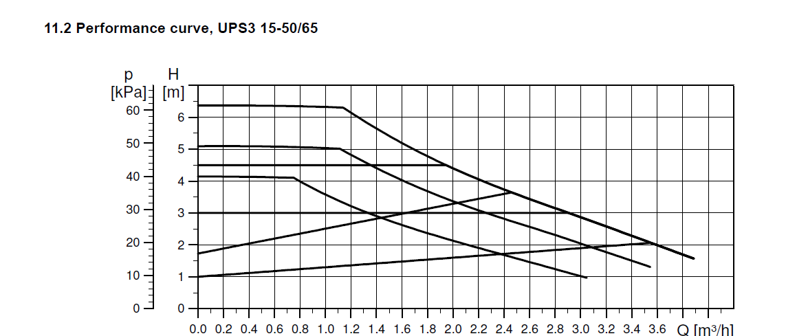

Can i ask why you are continuing to think CP is a valid pump mode?

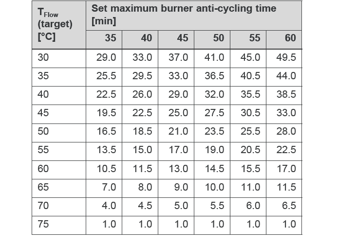

I don't think you really have any options if the heating load falls below the boiler minimum load except to ensure as much as you can that the boiler fires up on one attempt after recycle and runs until the flow temperature again trips the burner at 67/68C., that is as good as it gets then as a boiler cycling should really be no big deal, my 18 year old oil fired boiler constantly cycles (since it can't modulate) with no problems.
This bit puzzles me though
Burner tripped and anti cycle started ( 6 minutes)
Pump stopped at 1 minute remaining.
Pump started after 2 minutes.
Burner fired back up.
At a (max) anticycle time of 20 minutes and a target temp of 63C then the anticycle time should, theoretically, be 5.1minutes, say 6 minutes actual max, the pump stopped with 1 minute remaining which "proves" the actual anticycle time of 5.1 minutes, now I wouldnt have thought that the pump would/should then stop and restart after a further 2 minutes but this is possibly normal for a Vaillant, what I can't figure out is why increasing the overrun time from 5 minutes to 8 minutes helped since overrun should not have been requested, are you saying that the "anticycle"time then lasted for 8 minutes?.
What you might consider doing is reducing the overrun time back down to 5 minutes and increasing the (max) anticycle time to 35 minutes to give a actual anticycle time of 8.4 minutes and note again the actal anticycle time and pump stopping/restarting again, it wwoud/will be interesting.

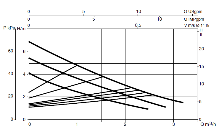

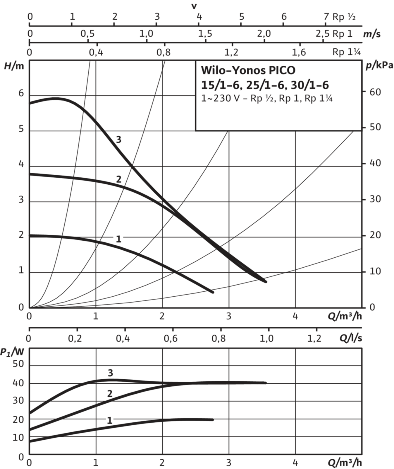

Apart from getting a ABV to operate as designed, ie to start opening as the pump head increases on reducing flow rate , radiators can and often are serviced by a pump in CP mode, I have a 10 rad system with a 6M Wilo Yonos Pico pump with 3 CC settings and CP and PP modes that can be incrementally changed in 0.1M steps to give any desired flow rate. I run my pump in a PP 4.7M mode which gives me my required flowrate at a head of 3.5M with all TRVs opened, the pump head then falls as the TRVs throttle down and my kitchen rad, on the end of a very long run is a little slow in getting up to temperature, in very cold weather (very uncommon here) at say < -2C I run the pump in CP mode at 3.6M, the kitchen rad then heats up almost as rapidly as the remainder of the rads. I don't have either a manual or a ABV, oil fired boiler, non required as the 25L boiler HEX soaks up any residual heat. (CC2 on my Wilo gives a reasonable constant curve for setting up a ABV).
The UPS3, IMO, does not have any CC curves, valid or otherwise, one of the few pumps I've come across in the past few years with true CC curves was a DAB Evosta 4-7M, see below, I installed one for a neighbour a good few years ago (rad system) and had no problem whatsoever setting up the DU144, ABV.

CP really demands a low loss system with very little friction losses or delta between emmiters. It is a pressure biased system, not flow and flow is the primary condition we should be worrying about (ignoring knackered plumbing).
I could get away with CP in my system because it's clean and uses distribution and return manifolds and has a electronic actuated bypass.
However, for ABV, the CP is beyond useless because you get xero Delta P. Which the ABV works on.
On older systems without manifolds and variable losses, i don't see how that works in CP mode either and then you have the energy wastage of it.
Ymmv. But moving from a CS pump to a VS pump needs careful system consideration.
In the OPs case, i cannot see how anything other than CS works.

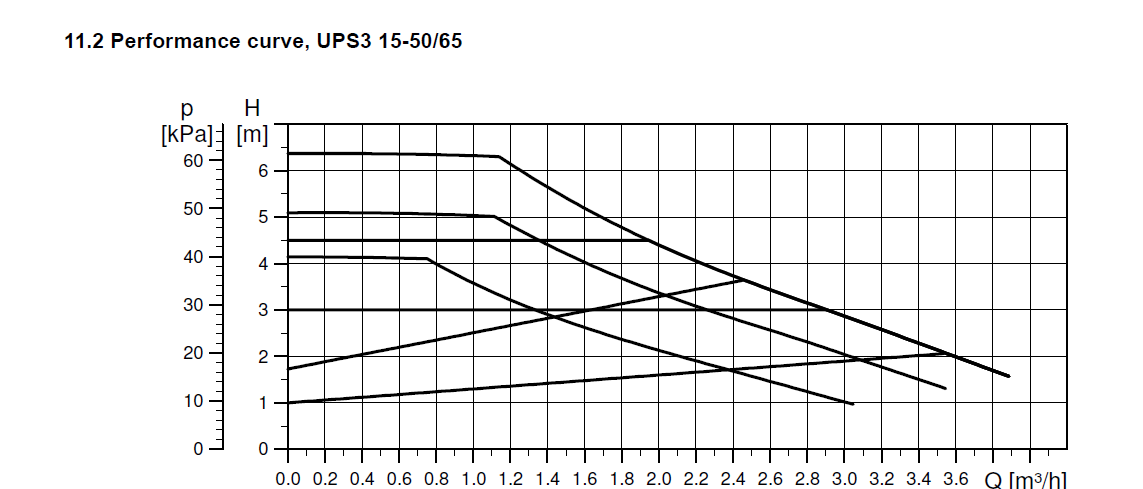

Grundfos recommend the constant pressure setting for the UPS3 pump on central heating systems fitted with ABVs. Ie fixed speed 1,2 or 3. The pump does have a proportional pressure setting but as they state, only to be used on a system with no ABV.
An option I am considering and Johntheo5 could you advise please as a trial for my issues. I feel that the UPS3 even on CP 1 could be to fast / pressure for my new pipework and rads. Thoughts are, close the ABV and remove the TRV on one of the downstairs rads and balance a constant flow through it. Use this rad ( and the towel rail for upstairs) as heat sinks / pressure release. Set the pump to PP2 ?.
Your new pump is a UPS3 and not a UPM3??
Not sure where you are coming from re above but you can certainly try the above, its only a few button presses.

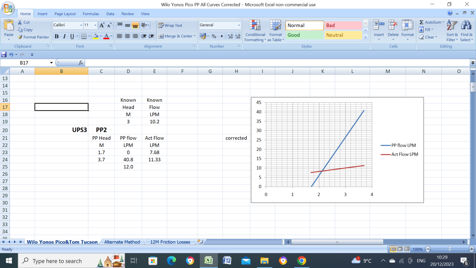

I reckon that with the TRVs open that you may have a boiler load of ~ 10kw, if so, then a dT of your 14C will require a flowrate of 10.2LPM, when/if you change to PP2 then the result will be a 8.4LPM flow at a head of 2.1M.
They actually don't.
They say "if... must"
It's a fudge solution which they admit isn't ideal for obvious reasons.
The last paragraph is the key. "Use a manual bypass".
Grundfos operating instructions for the UPS3 attached.
Section 6
6.2.1 Refers to the factory setting of Constant curve or Constant speed 1,2 or 3.
6.2.2 * Proportional pressure mode is not recommended in heating systems that include an ABV.

A TRV will work with any pump mode you wish to use. As stated above, if the pump head is too high either in constant curve or constant pressure mode then this may lead to noisy TRV operation and will also lead to unnecessary energy usage. The UPS3 so called CC1 is 4.2M which will waste power as its not required at your flowrates and may lead to noisy TRV operation, its useless used in conjunction with a ABV as it effectively gives a constant pressure (head) of 4.2M up to a flowrate of 12.5LPM, this pump has, to all intents and purposes, 5 CP modes and 2 PP modes.
