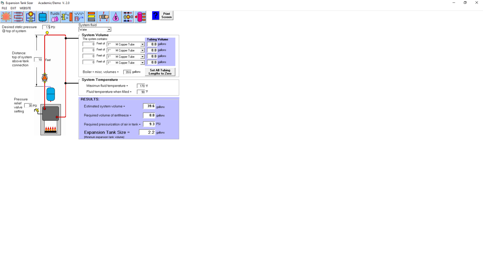

How to size etc. CH expansion vessel
Would you mind using it to calculate the EV size required using the above with the following conditions.
System volume 150 litres.
Flow temperature 70C
Return temperature 60C
Mean temperature 65C.
precharge pressure 1.0 bar
Filling pressure 1.5 bar.
Diaphragm Type inserted bladder
Fill in these details and I can calculate it for you.

A 8L EV with pre & filling pressures of 1.0/1.5bar will have a final hot pressure of 2.5bar with a system volume of 83L. If the pre & filling pressures are both 1.0 bar the final hot pressure will still be 2.5bar with almost double a system volume of 157L.
