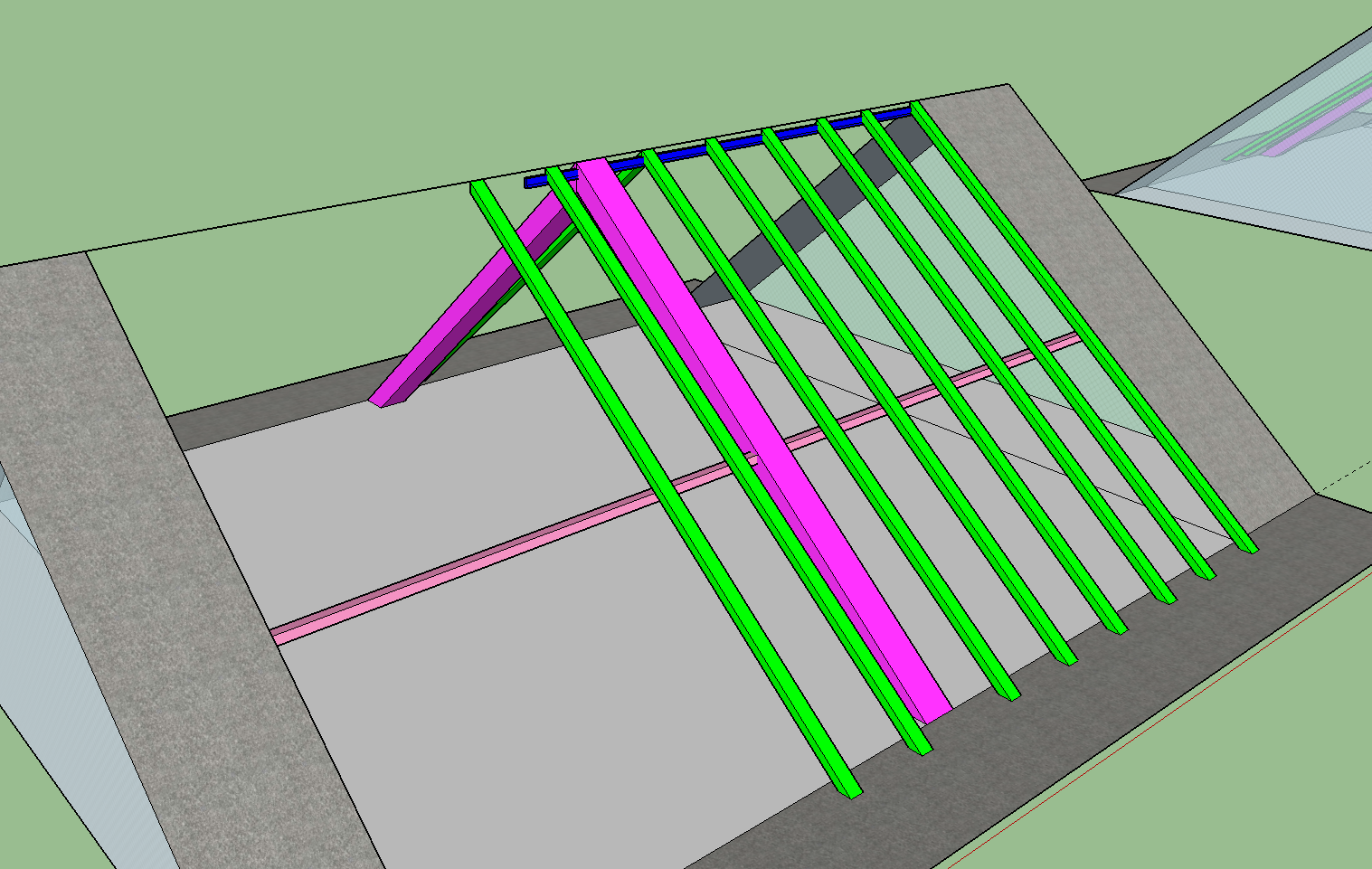

I've got a gabled roof made up of two chunky pairs of rafters, and two dozen much lighter rafters that sit on purlins resting on the larger rafter (and the stone gable-ends of the property).
It looks a bit like the diagram below:
1) Green 'lightweight' rafters
2) Purple 'heavy' rafter (which also has a lateral tie 1/3rd up I've omitted from the diagram)
3) Blue ridge board
4) Pink purlin
The purple rafter is buried into the stone wall, and the green rafters sit on top of the rubble wall, and the purlin. Some of the green rafters are attached to ceiling ties, but most aren't, so the only thing preventing the roof from spreading out is the tie on the purple rafter.

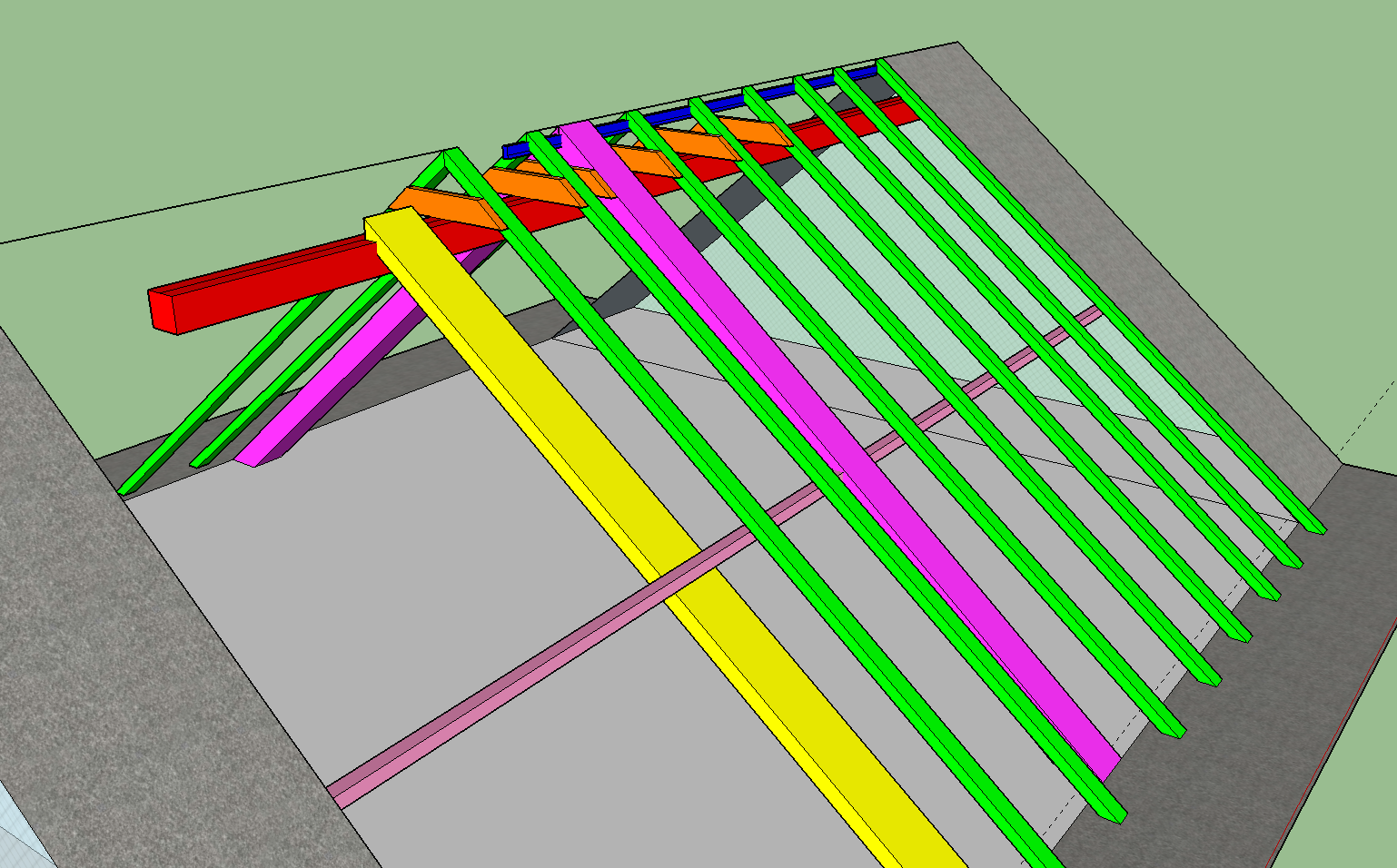

Here's a diagram of what I'm thinking:-
1) Orange collar ties
2) Red ridge beam
3) Yellow new rafter

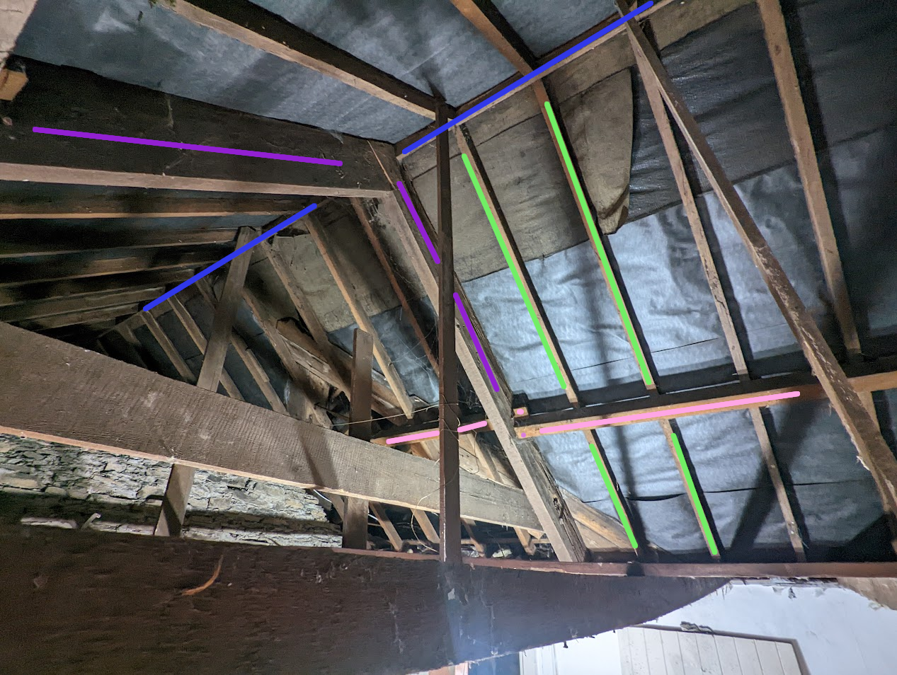

For further context, here's an image of the inside of the roof colour-coded as above
