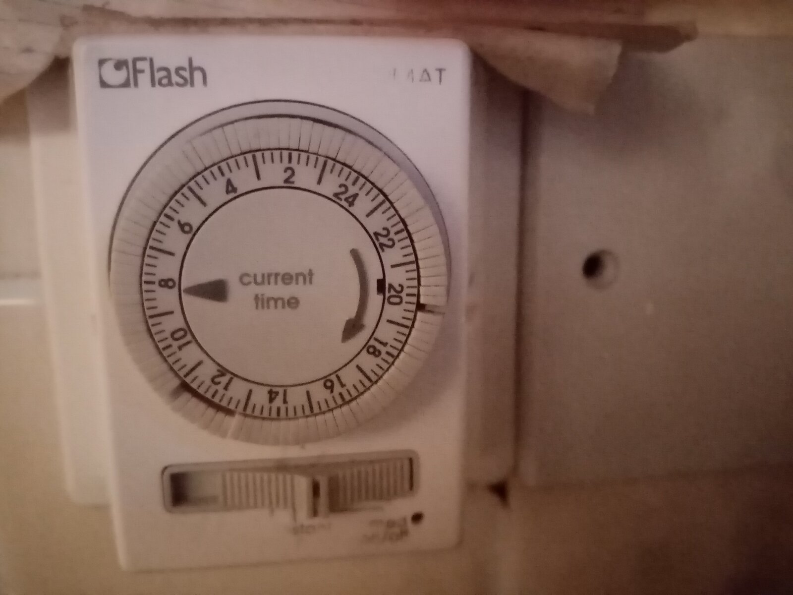

Simple question this time, but can anyone give me a step by step of how to time the immersion switch in the photo below to heat a house at a certain time every day?

Start by pulling all of the plastic 'fingers' around the circumference out with a finger nail, they will click. Then just push the ones in for the times you want it to be on for. There are four fingers per hour, one per 15 minutes - note you may need to rotate the dial, to adjust some of the fingers and it can only be rotated clockwise. Then set the time to the correct time, against the pointer on the left.
Below the dial is a slide switch, which allow you to override the times of switching, it will have three positions - on all the time, off all the time and normal operation based on the time clock.

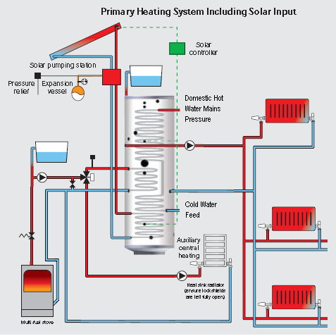

That does not seem to make sense, the standard immersion heater heats domestic hot water (DHW) not the house. This diagram Torrent pipe example.PNG shows how many heat sources can be used both to heat domestic hot water (DHW) and central heating (CH) so there are cases when the immersion heater can heat the house.

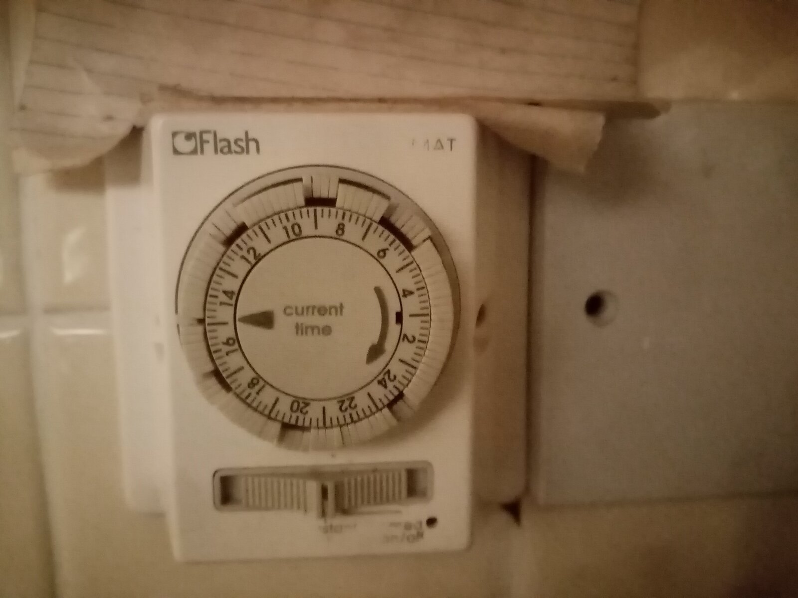

Thanks, set it to heat from 11am to 1pm every day.
