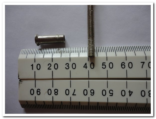

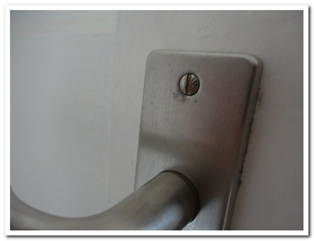

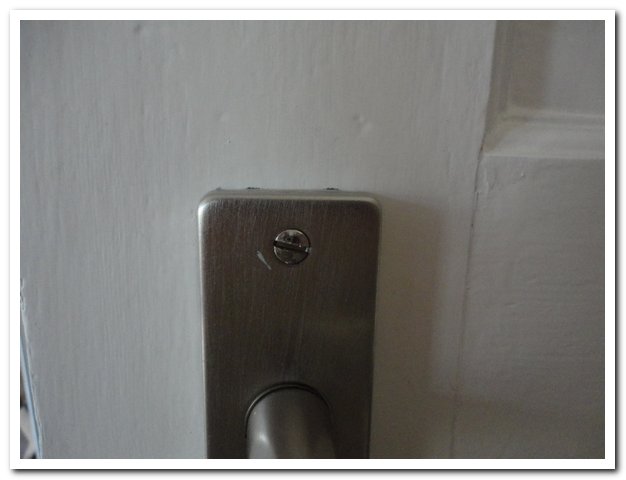

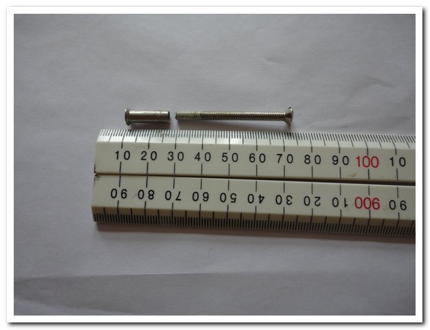

I need to undo the connecting screws which are holding door handles on. After I first fitted them (many years ago) I got tired of them continually coming loose, so I applied what was described as a removable thread-locking fluid; for some of them, this has turned out to be more permanent than I wanted.
I have tried applying heat (using a 50W soldering iron on one end and a 25W ditto on the other) but that hasn't worked.
All the usual suggestions for removing stubborn screws assume that the thread is firmly attached and rigid; in my situation, the screws will rotate together and I cannot apply enough torque (holding a slotted screwdriver into each end) to break the seal. I have removed one of the screws that will come apart - see photos - there is about 10mm of thread that needs to be undone. The bolts are 4mm diameter and 40 mm long, with domed heads and screwdriver slots 1mm wide and 7mm across. The material is not very strong - on some of them it has got a bit chewed up.

No point in heating the long screw side as the heat will take an age to travel the length of the screw and I doubt it will ever get hot enough to soften the thread locker.
I agree - my problem is that I can't tell which is the long screw side - both ends are similar.
Stronger wrists or maybe impact driver on one side while holding the other as steady as possible .
Someone with a good screwdriver on one side and you with an impact driver on the other. Only good thing is that you can easily buy replacements of those screws.
you need an assistant working from the other side
and two screwdrivers that are unworn and exactly the correct size to fit the slot.
you can get screwdrivers with an octagonal shaft that a spanner will fit for extra grip.
If one of the heads gets damaged, you can drill the head off. Once you have made a pilot hole in the centre, you can either use a drill the diameter of the shaft, or a conical countersink. As soon as the head comes off you can push it through.
