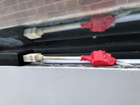

The cable from the switch is wired into a connector (covered in red tape) which connects to an old white 'kettle' lead which I cut the plug off:

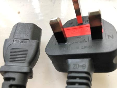

The original kettle lead (now unused) - the white one I am using also has 10A 250V stamped onto it):

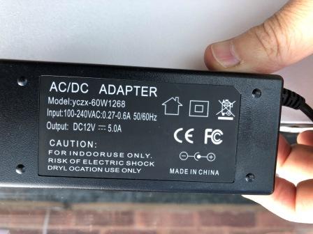

The kettle lead plugs into the "Brick" (the term used by the retailer):
From the Brick to the LEDs:

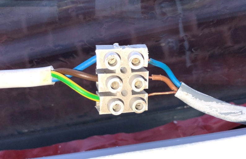

After reading all the replies above (thank you) I removed the red tape and revealed the connections. The cable on the right comes from the light switch. The cable on the left is the de-plugged kettle lead:
And that PSU is unlikely to work on a dimmer. Bypass the dimmer and use the remote control to control your LED things
Until the OP understands that he needs a neutral (unlikely to be available at the light switch) then everything else is pointless. But this is going to end up as such a mess that an electrician would be the best answer.
Also no kettles will function with that original lead, so not a kettle lead ;)
