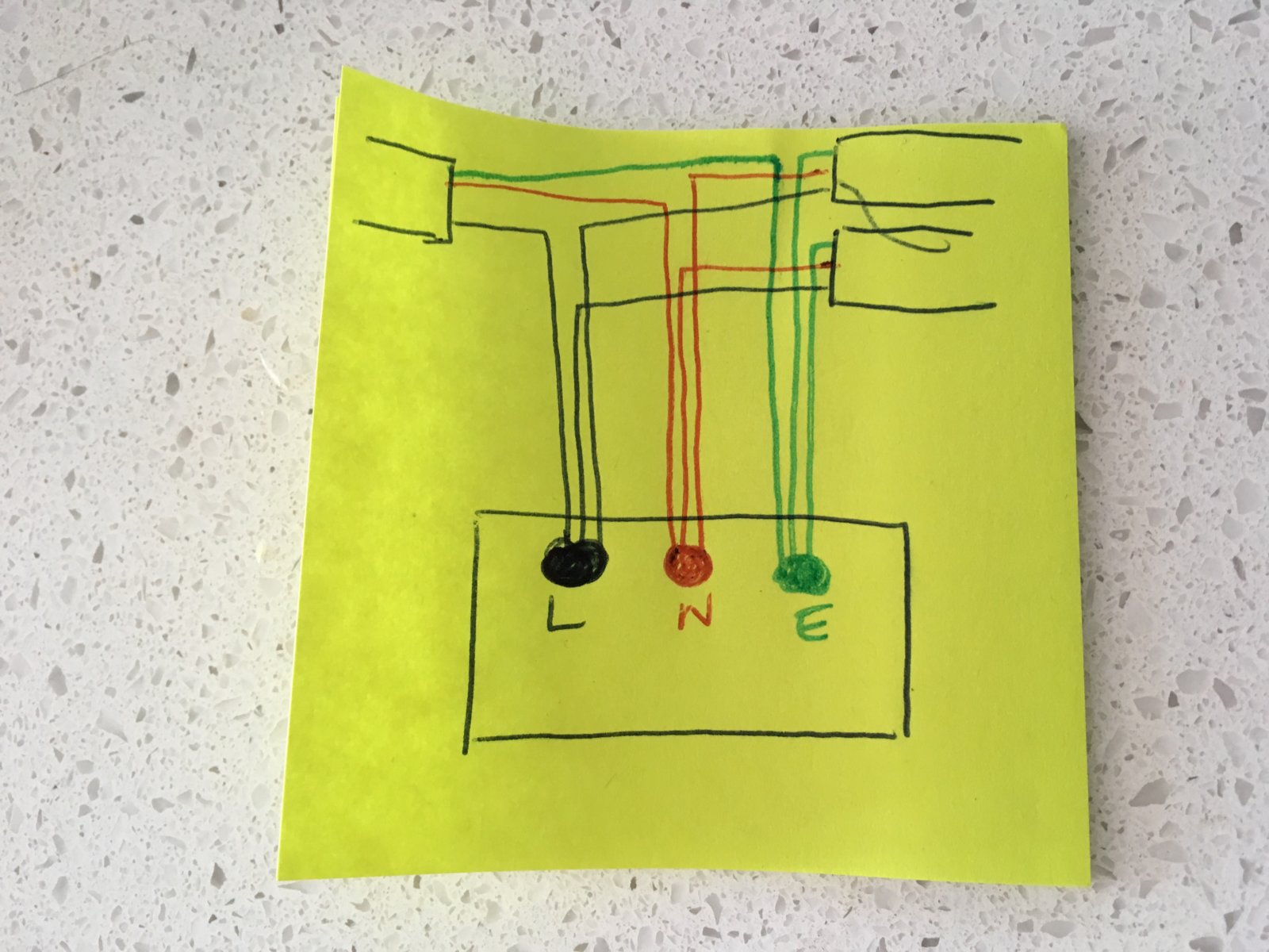

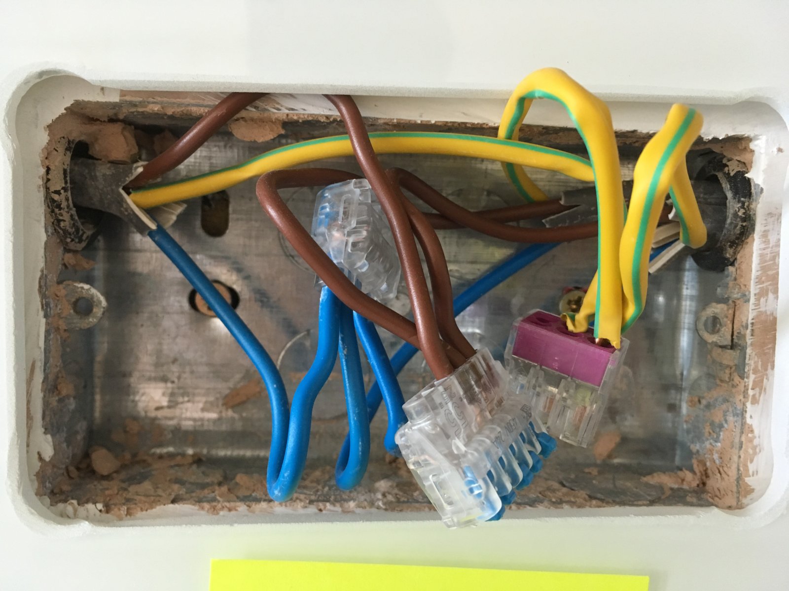

My builders have left me a half finished kitchen before doing a runner.
One of the outstanding items is this plug socket. How do I wire it? I’m used to there being 2 sheathed cables - not 3. Thankfully they had the common sense to use a wago.
Can I just wire all three, N, L and E wires into the respective terminals on the socket? (See diagram)

Well that's how is currently connected together (unless I'm not seeing straight)
Ah, I was under the impression that these wago connectors were end connectors and isolated the cables from each other? Or do these ones have a bus bar to connect them up?
All Wago terminals connect all the conductors in them together - that's the whole point.
I expect one is a spur to another socket or a switch. You should be able to see it aligned horizontally with the one in your photo.
