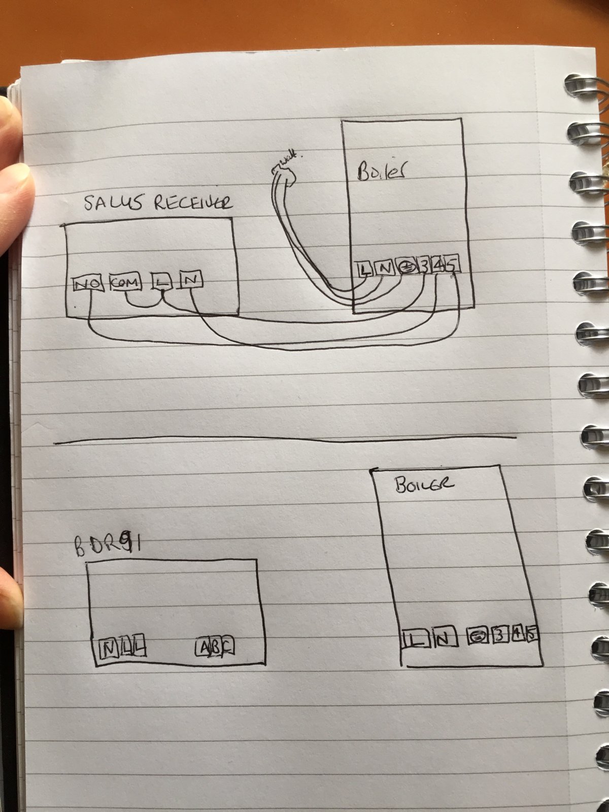

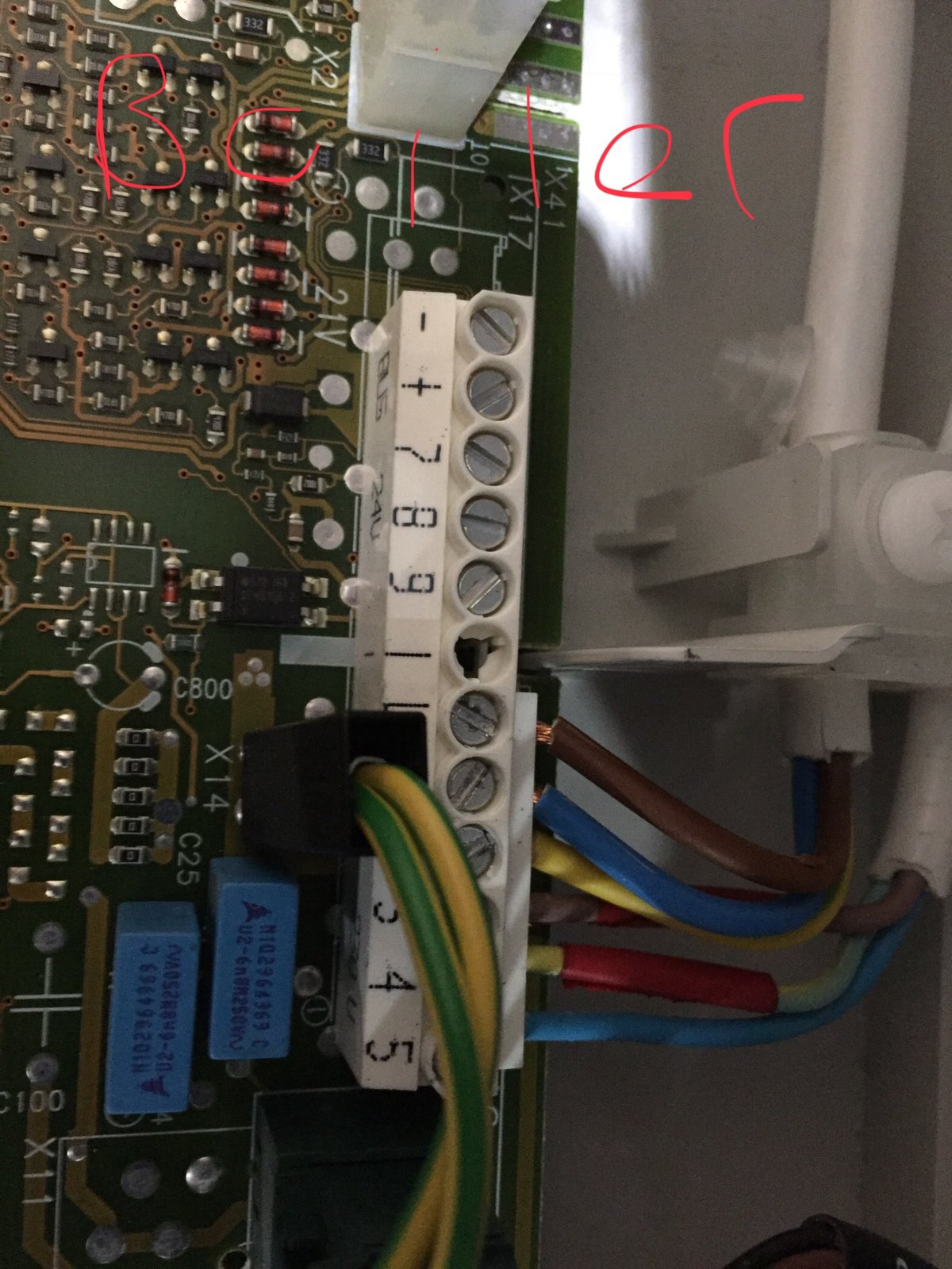

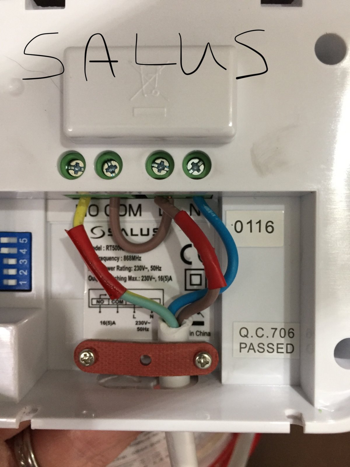

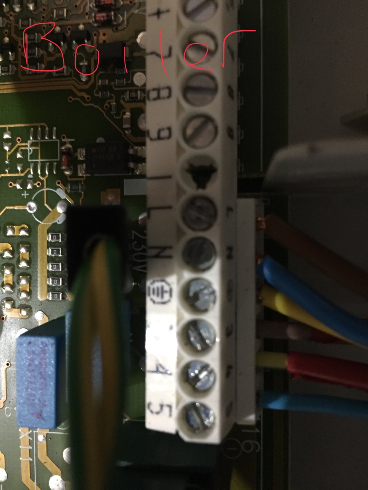

Hi
I am looking to replace my Salus RXRT505 wireless receiver with a Honeywell wireless bdr91 receiver so i can use evohome.
I thought it would be a straight swap but the bdr91 has different labelling. My boiler is a valliant Eco plus about 12 years old.
The salus was so installed a year ago so i have a wire from the boiler to this receiver. I thought the new receiver would be the same but clearly not . Can anyone let me know what should i connect to ABC on the bdr91?
I’

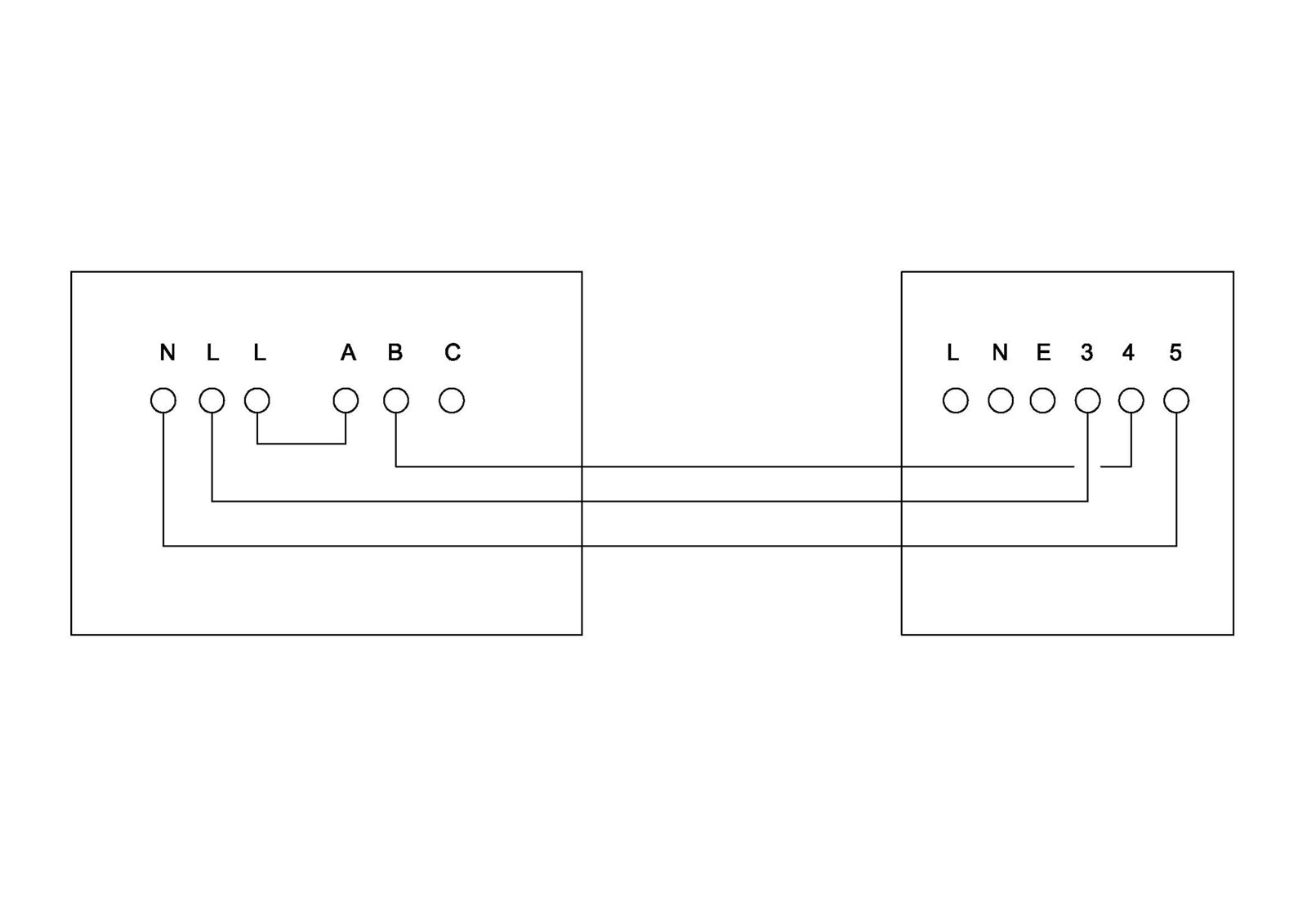

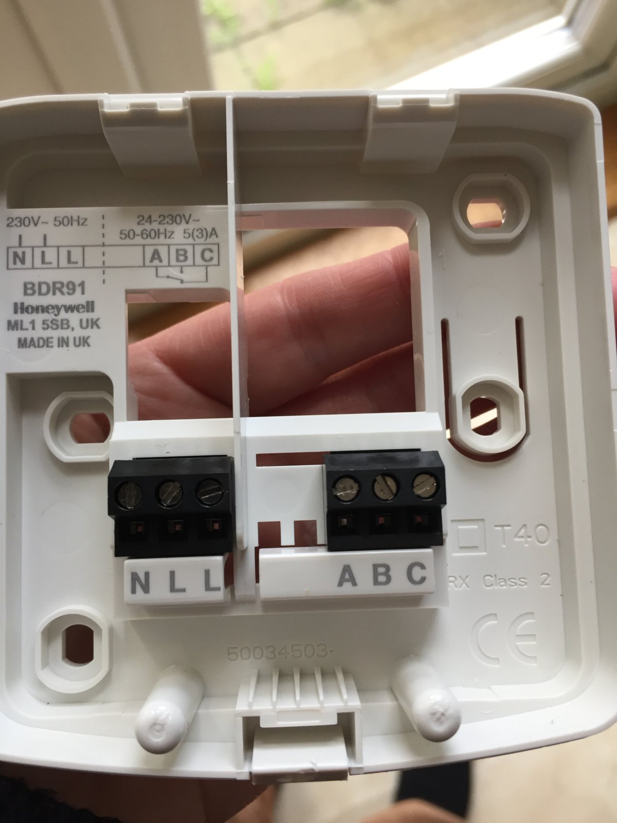

It's just a matter of moving the wires from the terminals at the Salus to the terminals at the BDR91 that have the same function. Before I start, I should point out that whilst it will work as indeed it has been doing, the wrong cable has been used. Because an earth wire is being used as a live conductor.
However the wiring will be:
1. The "earth wire" with red tape at Salus 'No' (switched Live) goes to BDR91 'B'
2. Brown wire with red tape. Salus L (Live) goes to BDR91 'L'
3. Blue wire. Salus N (Neutral) goes to BDR91 'N'
4. Add a link between BDR91 'L' and 'A'
No connection to be made to 'C'
EDIT . Drawing added.
Stem, the concept of using the mains voltage at 3 to power a control unit is often missed. Useful when a midposition valve needs to be used along with non voltage free programmer
Indeed, some Salus instructions in particular are quite poor, they just show the voltage free contacts wired to a 230V boiler that has two terminals provided for the switching circuit. The BDR91 on the other hand provides a useful second live terminal for the loop to A, to make installation easier. Hopefully diylady will let us know how it went.
