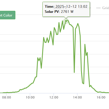

At 20 watt, if I look at my own panel's 6 kW which today don't even get to 3 kW 1765571914134.png I would not expect over 10 watts which with a 60 Ah battery could be left charging at that rate 24/7 without a problem.
