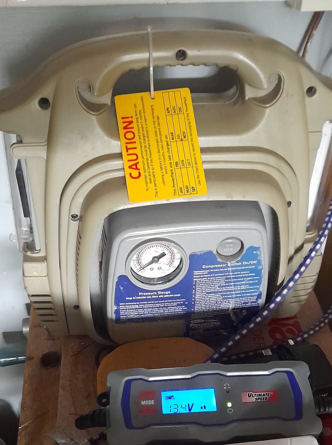

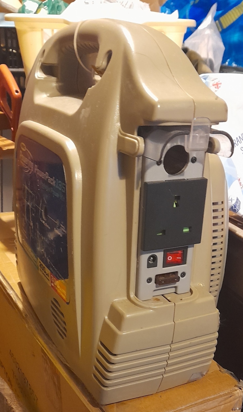

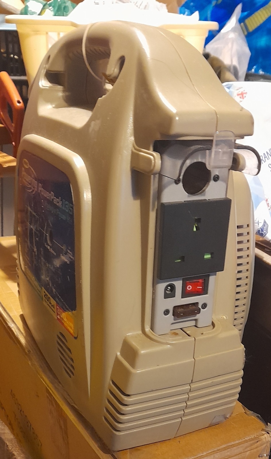

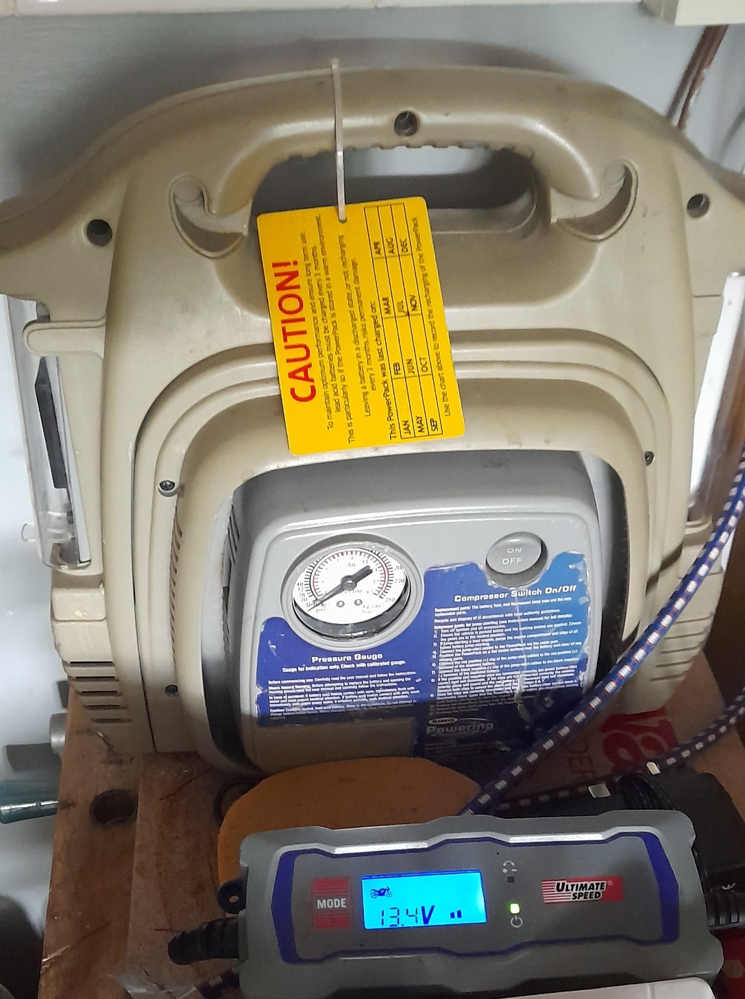

I have had one for years, Battery pack and charger.jpgBack-up-power.jpg but the 300 watt inverter built in, is very different to the modern units. At £400 not cheap
but it will power a lot more, it would, I think power a kettle
as shown (750 watts) however, it may also have some uses at home as well, like transferring off-peak to peak times.
EPS: Emergency Power System.
Once you have connected the mains and the AC input port of the product via the AC charger cable, you can use the AC output port of the product to power your unit (at this point the AC power comes from the mains, not the battery of the product). In the event of a sudden loss of mains power, the product can automatically switch to battery mode within 20ms.

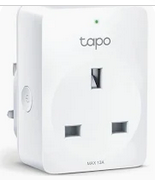

so add a smart socket, 1775224865618.png and one can charge it off-peak, and once the smart socket turns off, all will be powered from the battery.

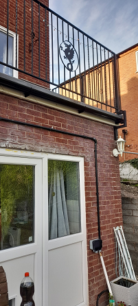

I looked at base load, and considered what causes the base load, and in the main it seems the freezer account for most of the base load. I have three in a block together, including the central heating, they are all powered from the existing batteries, a pair of double sockets in the kitchen, with a junction box outside, so splitting the supply into a plug and socket, would allow a battery pack to be inserted, and a simple timer could turn off the supply so forcing it to go into UPS mode, and removing some load from the main batteries, those extending how long the main batteries last.
Cheaper due to being smaller, so kWh to the £ no real gain, but they offer as secondary use in summer. The answers from @Wayners and @Ragnar_AT but assume talking about grid tie, I was not really talking about grid tie. None of the units shown are grid tie. The new units will allow solar panels, and I had considered installing a part roof over the balcony to hold solar panels, I looked at the balcony railings,
and not sure if the fixing are good enough to counter wind resistance on the solar panels, so safer not to use to hang solar panels. On the wall above the living room window would catch the morning sun, but the time of the year when I need the extra, don't get much morning sun, the hill opposite 1775387874920.png means it is nearly midday in winter when we see the sun, yes I know it is light which generates power, but the solar would be so low in winter, and in summer the existing solar produces enough. At the moment exporting 4.7 kW, at 11:20 UTC (12:20 BST) I have already exported 3.2 kWh. I do not really need extra solar, but extra battery capacity may help.

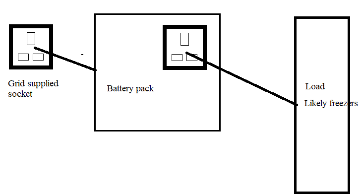

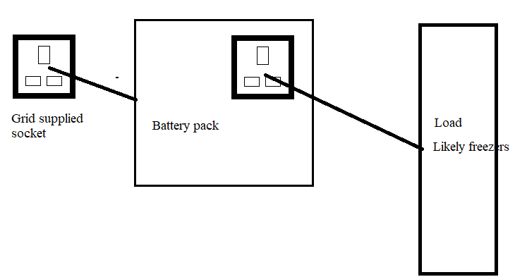

Seems I am not being plain in describing system without grid tie. 1775473463024.pngThe load for example freezers plugs into the battery pack not a grid supplied socket. The solar, if any, can also plug into the battery pack, there is no way it can back feed.
What I am saying is a freezer which has an energy rating of 350 kWh/year is going to use 760 watt/hour in 19 hours, an 800 watt solar panel will likely produce 2.5 kWh per day in summer, in my case three freezers in the kitchen so they would just about run off solar and battery in the summer. Other household may find other items which can run from solar.
The battery packs will work as an UPS, so using a simple timer each night to recharge in case not enough sun, hence 19 hours not 24 hours, the grid supply will work direct for 5 hours.

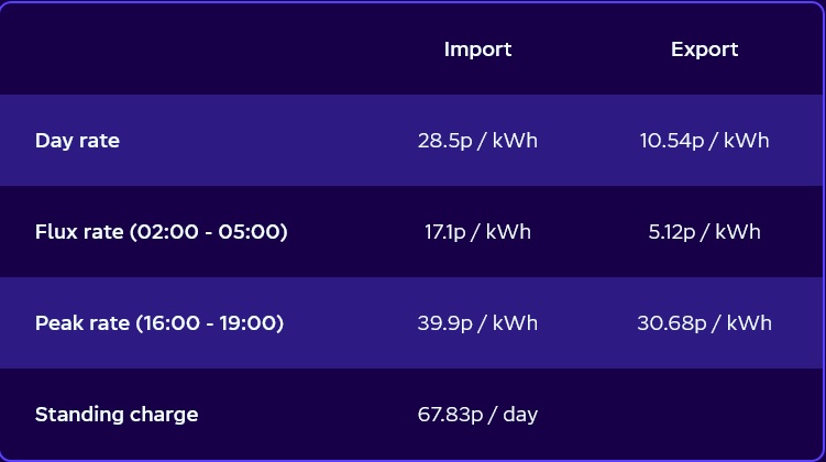

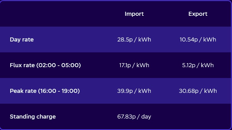

If the goverment required a tariff where there is peak and off-peak but peak no more expensive to standard rate, then small scale solar would work, but it is the tariff which kills small scale solar. This was this time last year, Oct Flux end April.jpg but it shows the problem, 39.9p/kWh from 4 pm to 7 pm, one has to be really sure you have enough battery to cover that time, the EV charging tariff was better, the peak rate was not so high, but the big problem was, they this time last year were changing all the time, and this year also changing all the time, so export went down 3p and off-peak went down 2p so there is still more paid for export as to what off-peak costs, so I can fully charge battery with off-peak and it does not matter if as a result I can't store solar. So I do not need to watch the state of charge of the battery like a Hawk, I can let it do its own thing.
