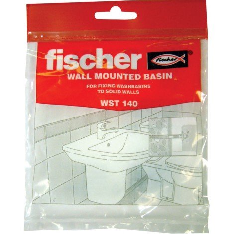

These...
https://www.diy.com/departments/fischer-sanitary-fixing-kit-15-pieces/1117905_BQ.prd
Plus screws through the holes, plus some GPpro on the back of the basin - do all of those and it won’t budge... but be prepared to do a lot of making good if you ever want it to come off in the future.
