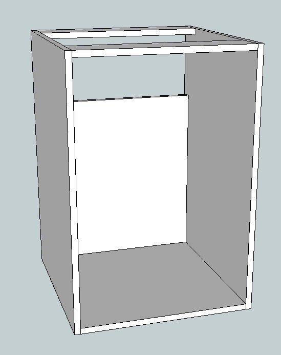

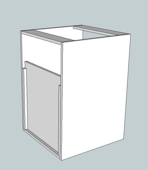

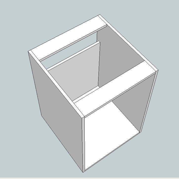

Have you considered getting some pre-edged MFC and making your own? They are hardly rocket science - for 18mm thick stuff a 600mm wide unit comprise: base 570mm deep x 564mm wide (ex-600mm stuff), sides (2 no) 720mm high x 570mm deep (ex-600mm stuff), front/rear bracings (2 no) 120mm +/- deep x 564mm wide, back 564mm wide x 600 ~ 702mm high. Screw together with black carcass screws. Takes me about 20 or so minutes to make-up one carcass after I've cut the stuff to size. add an extra 15 minutes if you need to edge-band the stuff with the iron
Note: back is fixed in place using 1 x 1in softwood batten (2 x 1 will do, though). Feet screwed to underside or plinth box made-up to support cabinets above
