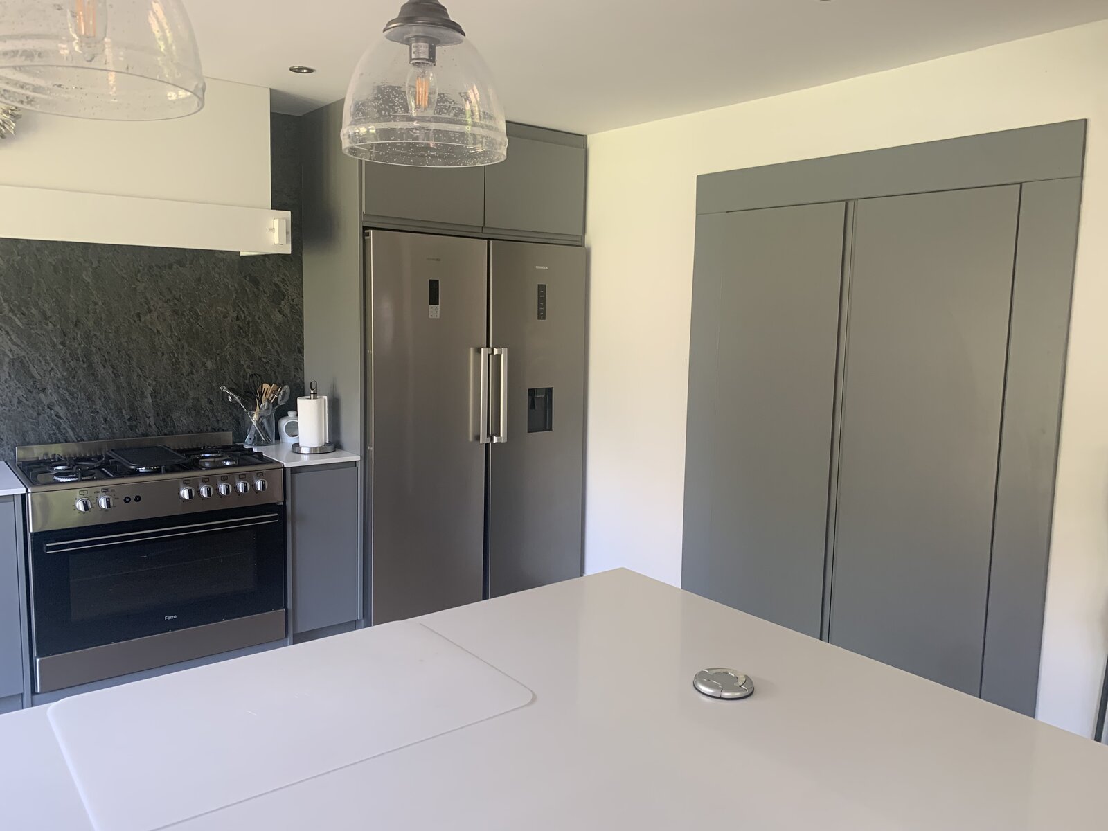

Pantry doors on right are from DIY kitchen , made a mdf frame up and used B&Q colour match service to paint them . Hard to tell slight colour difference .
