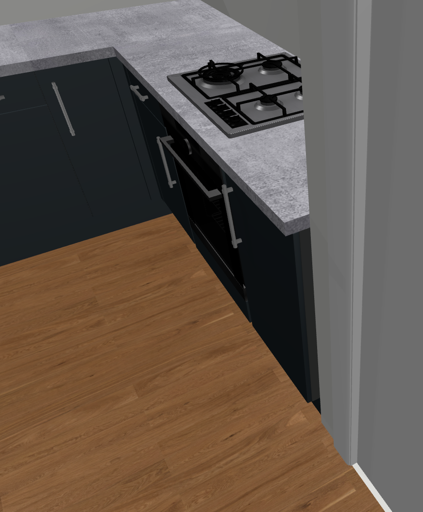

Gonna be a bit naff that thin. Tell us more about the problem, not the issue you hit with your envisaged solution to the problem?So I need a small end panel made from 2.5mm mdf (diy-kitchen end panels are 18mm). I enquired about paint and have been told...
