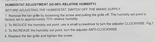

I'll give that a try, but according to the instructions that would mean I'm increasing the threshold, meaning it would need even more humidity before coming on. I'm wondering if there's a phone app to show humidity so I can see if the bathroom is reaching 65c. 65c is apparently the minimum humidity temperature before the fan is meant to kick in.
If, as seems to be the case, they have felt it necessary to include a pull switch to trigger the coming on of the fan, that doesn't speak well for how effective the humidistat control is!
Kind Regards, John
Agreed!

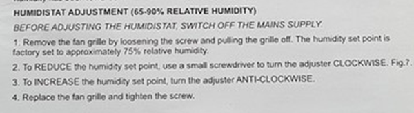

Fair enough, but if it's a model without a humidity sensor, then (a) what is this ...
... and (b), how could one explain ...
... It works and in the first week or so it would come on by itself when it detected humidity.
... and ....
... The fan works fine but it just means I have to pull on the white string to turn it on and off. But it used to turn itself on during taking a shower.
Kind Regards, John

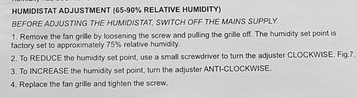

upload_2021-5-21_13-27-20-png.234175
OK, but due to how the OP posted the photos - that is the first time I have been able to see that enlarged version. Yes, I agree that is a humidity sensor.
