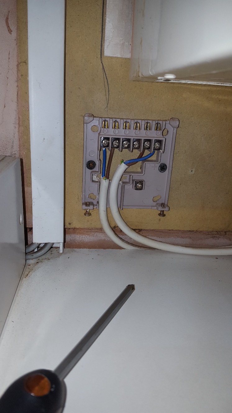

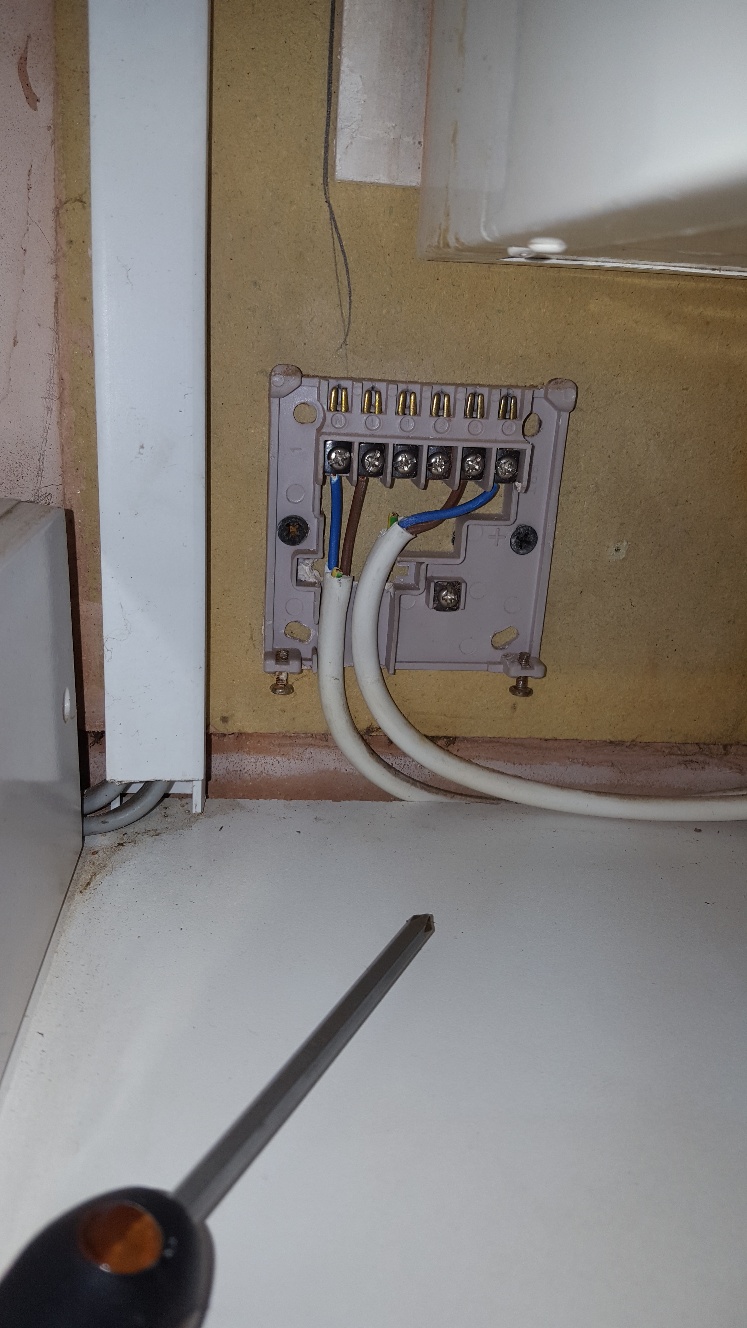

In addition to this repair, I bought a new programmer (ESI ES3247B) to replace the Landis & Staefa RWB9 programmer that had yellowed, broken backplate "hook" holes, cracked in other places and generally appeared unsafe. I wired the backplate according to the previous controller's configuration and one which was configured to switch on the HW whenever the CH was turned on (more on this later). So far, so good I thought.

Should the programmer be configured to be Gravity Fed so HW and CH come on together or Pumped so HW and CH can be independently controlled? I read on another forum something about needing the HW Off wired to the backplate for a Pumped system but the original backplate had only the HW and CH call connections wired (see attached).

post some pics of the cylinder setup and zone valves arrangement, you dont use HW off on an S plan only on a Y plan, you need to set the programmer to fully pumped, and most importantly you need to Flush that X800 out immediately

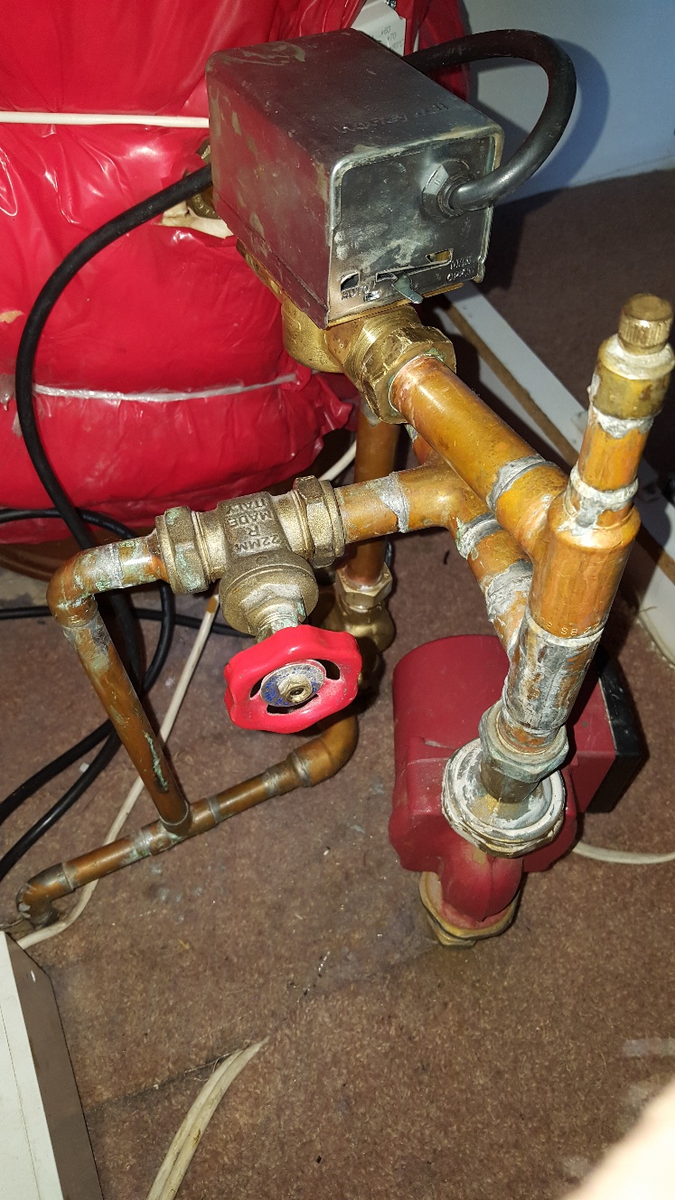

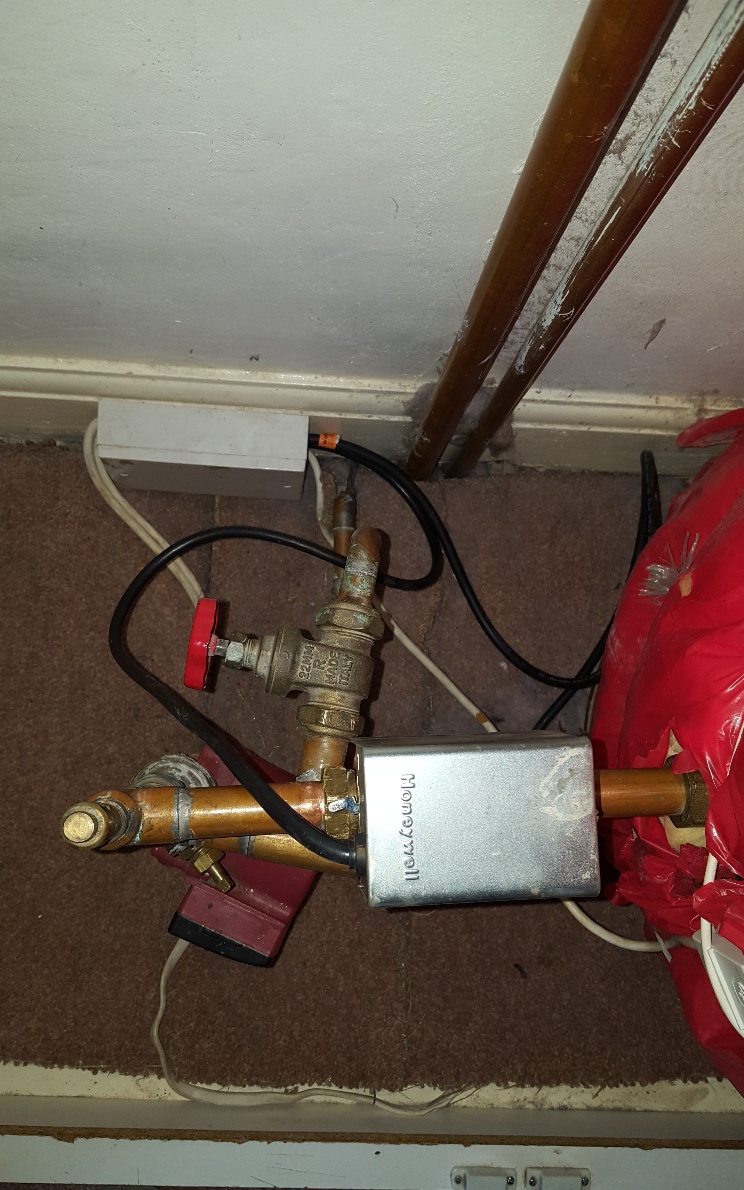

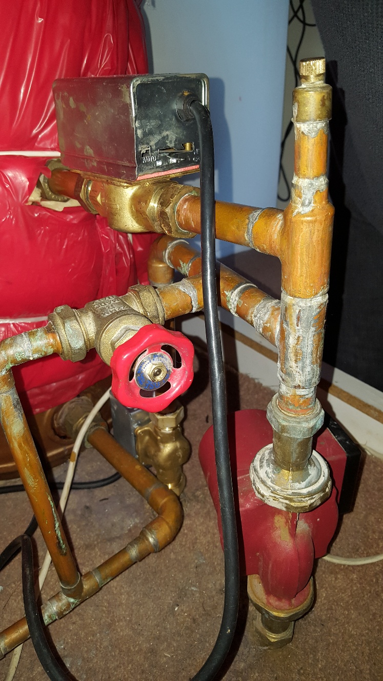

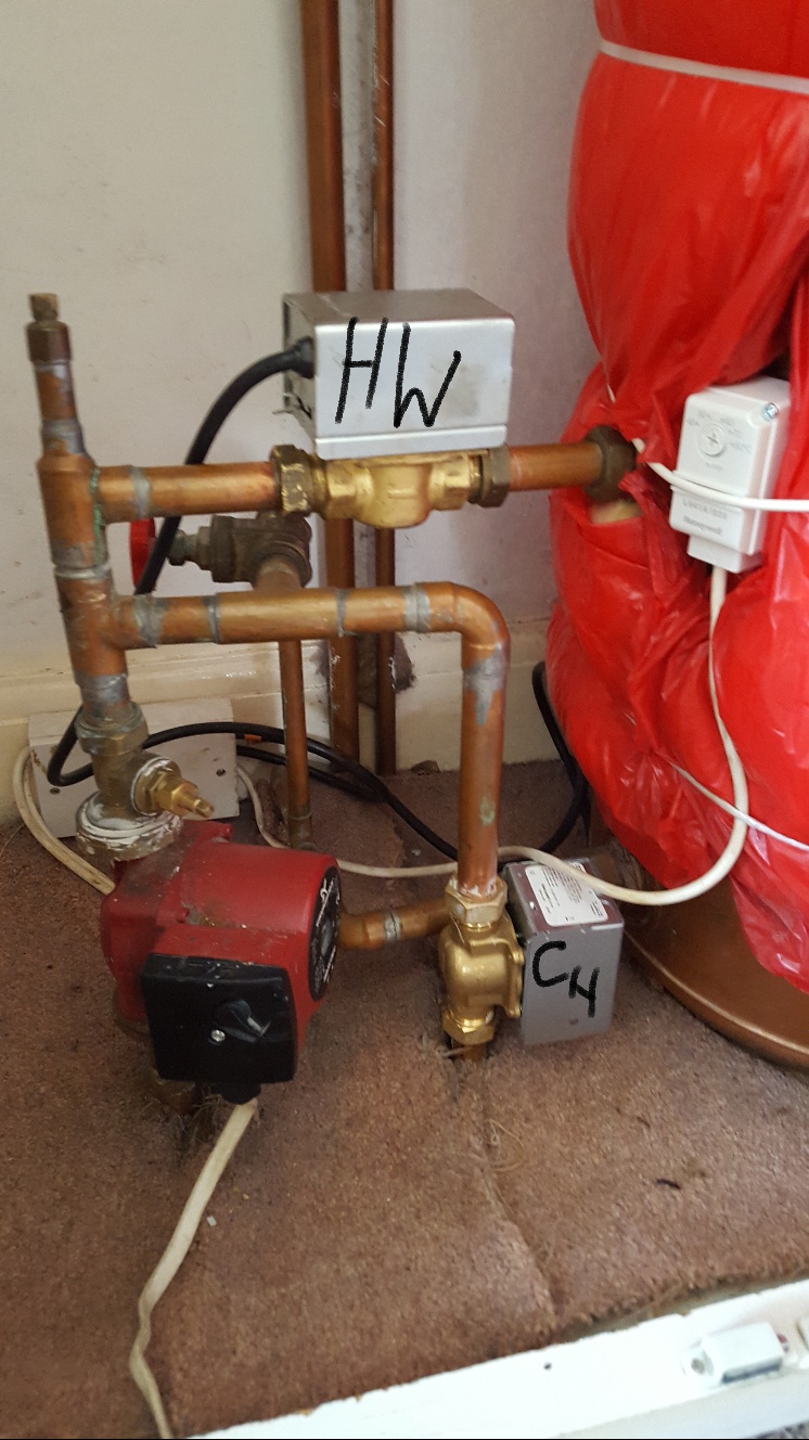

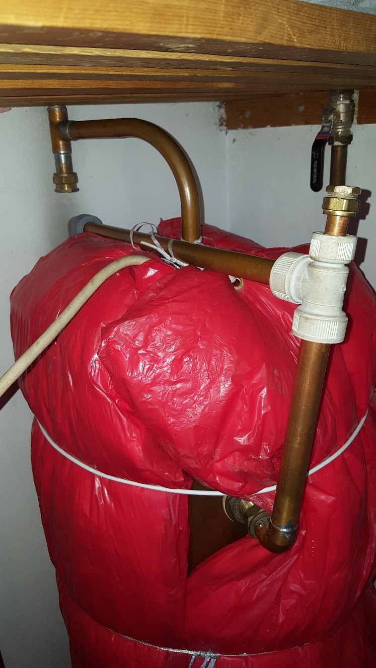

Here are the photos of the pump, zone valves and cylinder connections. Please disregard the drawing (now deleted) as I had the HW and CH zone valves marked round the wrong way. They are correctly marked in one of the attached photos.
Please note that the direction of water flow, according to the valves and pump, are as follows in the direction of the chevron: Pump - "^", CH - "^" and HW - ">".

your HW zone valve is the correct way round but your CH zone alve is the wrong way round, this is not causing your no HW problem though, but CH and HW on and latch the HW zone valve in the MAN position, does the water get hot now ?
Re the CH zone valve, that's what I thought but it's been like that since the system was installed in the 80s I'm sure?? I know that even though the valve shows the direction water should flow it is possible for water to flow in the opposite direction as it doesn't prevent that with just a rubberised ball blocking the water flow. I can't think why the original plumber would have installed the zone valve this way though as it's such an obvious mistake?? Is it because you're not supposed to have the switch lever facing upwards, so as not to allow dust into the valve?
On HW problem, the hot water gets hot as far as the right hand side of the HW zone valve but the cylinder remains cold. The pump is on right now with the CH and the radiators are hot and working perfectly. When I had just the CH on the pipe either side of the HW zone valve was lukewarm as you'd expect with the HW being off at the time. As I say, since turning on the HW on the programmer the zone valve actuator has moved to open the valve and call for heat but no hot water. Do you think I may have a blockage in the HW piping?
I was worried about leaving the HW on for long with the HW circulation being suspect but I decided to leave it on for longer than 20 minutes to see if the cylinder temp changed and it does feel warm now. It seems like an awfully long time to feel any heat and I've had it in for over 45 minutes, but the water was stone cold. Not sure if this is normal or I have a restricted flow problem.
The problem you get with the valve facing the wrong way is it can make a clunking noise when trying to close
I'm beginning to think now that it's just takes a lot longer to heat the hot water than my own hot water cylinder, which takes far less time and gives you an indication quite soon after turning on the hot water. Perhaps flow has become a little restricted over the years. Anyone know if it's common to get most scale and buildup inside the hot water coil rather than anywhere else in the hot water flow?
I can't say I've ever noticed a clunk when it closes but I think I may reverse the CH valve at some point to avoid it causing confusion. I've had the CH off for over an hour now (but the HW on) and below the CH zone valve it's only warm whereas above it the pipe is red hot, so I guess that proves the flow is in the opposite direction to the the way the valve is orientated.
Cylinder heated up eventually but took a while. I guess it's working less efficiently as it may have scale buildup on the outside of the hot water coil inside the cylinder and perhaps additionally sludge buildup narrowing the inside of the hot water coil. Thanks for your advice Ian.
