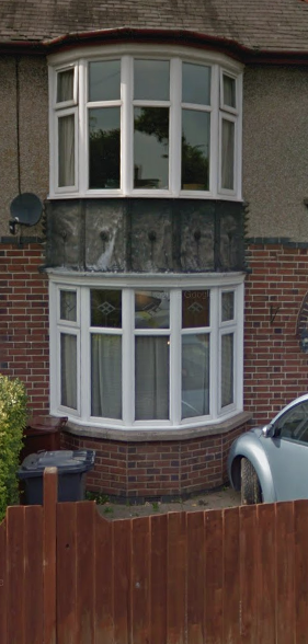

Check for cracks in the plaster below each side window assuming its the same on the other side, check for cracks outside the 'barrel' meets the house. This is jumping out to me that jacking poles haven't been fitted to the downstairs bay so it supports the upstairs, can you take a picture from outside of both bays stood back from the front and the side.

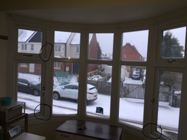

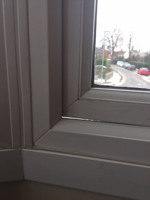

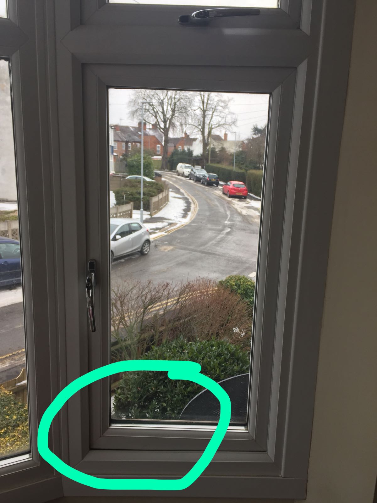

please see attached for details where I can see past it. Also the windows from outside.

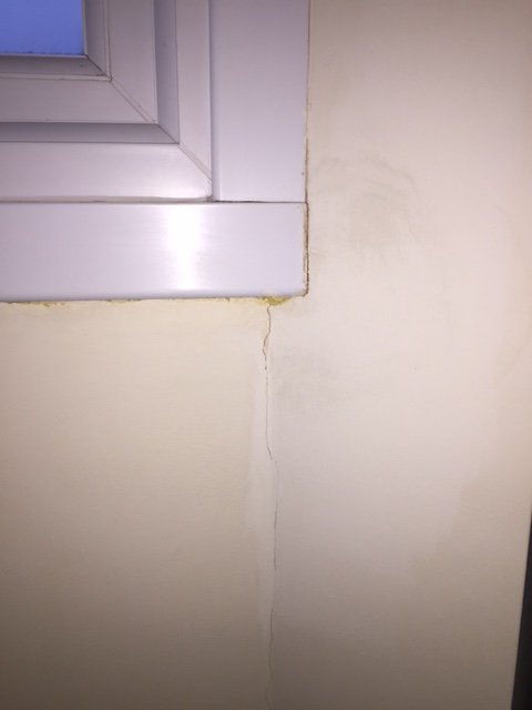

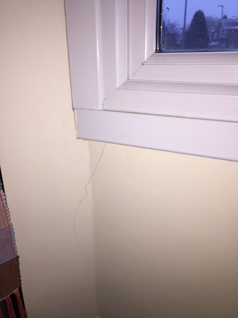

there are small plaster cracks see picture
windows open and shut ok, but not providing full seal.

The hinges will be fine, the opener is effectively a seperate entity only held in on hinges so if the frame moves and bends out of shape the opener stays in its original position hence you have daylight, the opener frame hasn't moved with the main frame

Your outside pic is small and far away, We need several from the outside. Front on side on etc
Like Crank I'm thinking your bay is dropping/pulling away from the house!

I took the beads out yesterday to try to toe and heal but I could not take the glass out since some spacers were forcing it in.
From what I understood from toe and heal is that it is used to use the glass door panel to force the opener shape to change ? From the picture I sent earlier you can see that the glass panel is not squared fitted with the opener. Should that be the case ?

If the window isn't square, then it was made badly, and they've tried to toe and heel it to correct it. Put a piece of A4 paper in the corner of the window, and the opening. If the opening is square, and the window frame isn't, then you'll need to get a new one made.
10-15 years old and I assume you haven't always had these gaps?
For the sash's to be this far out now your bay must have dropped at least an inch, Quite possibly more.
I would say you have a serious structural issue.
There is a good chance that the foundations are subsiding.
Bay windows quite often didn't have very good footings but it could be down to cracked drains or nearby trees too.
It could still be a problem with the structural posts on the windows. Inadequate baring at the top, No baypole jacks, It could just be that the timber frame between the 2 bays is rotting.
You could contact your house insurance people but once they are involved your premiums will likely go way up and it will come up in any search's done on the house if you ever try to sell so its worth trying to at least work out the cause before getting them in.

So post lots of pics from the outside.
Some pics of the large sash's on the inside of the downstairs bay (to see if they are out of square too).
