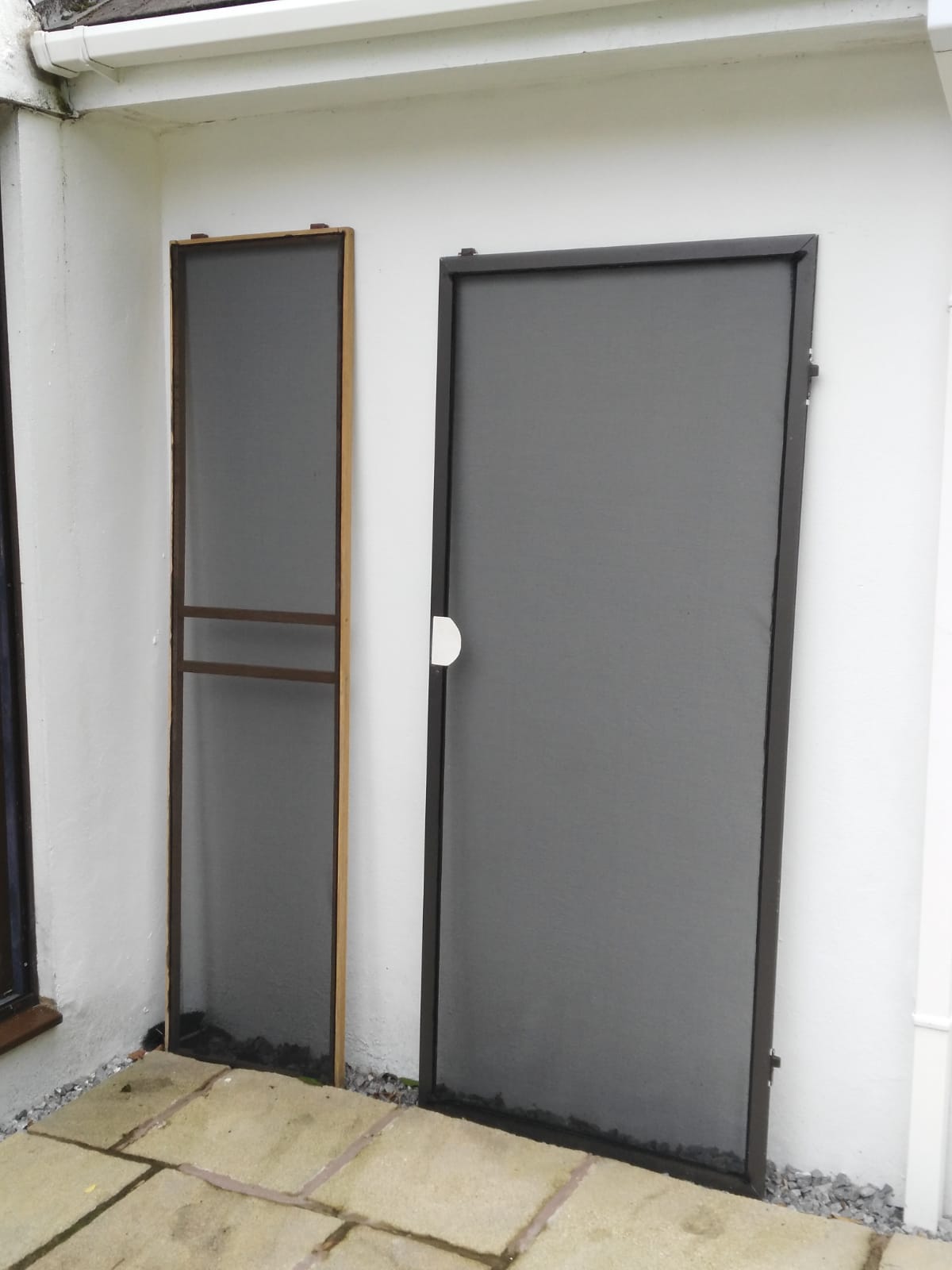

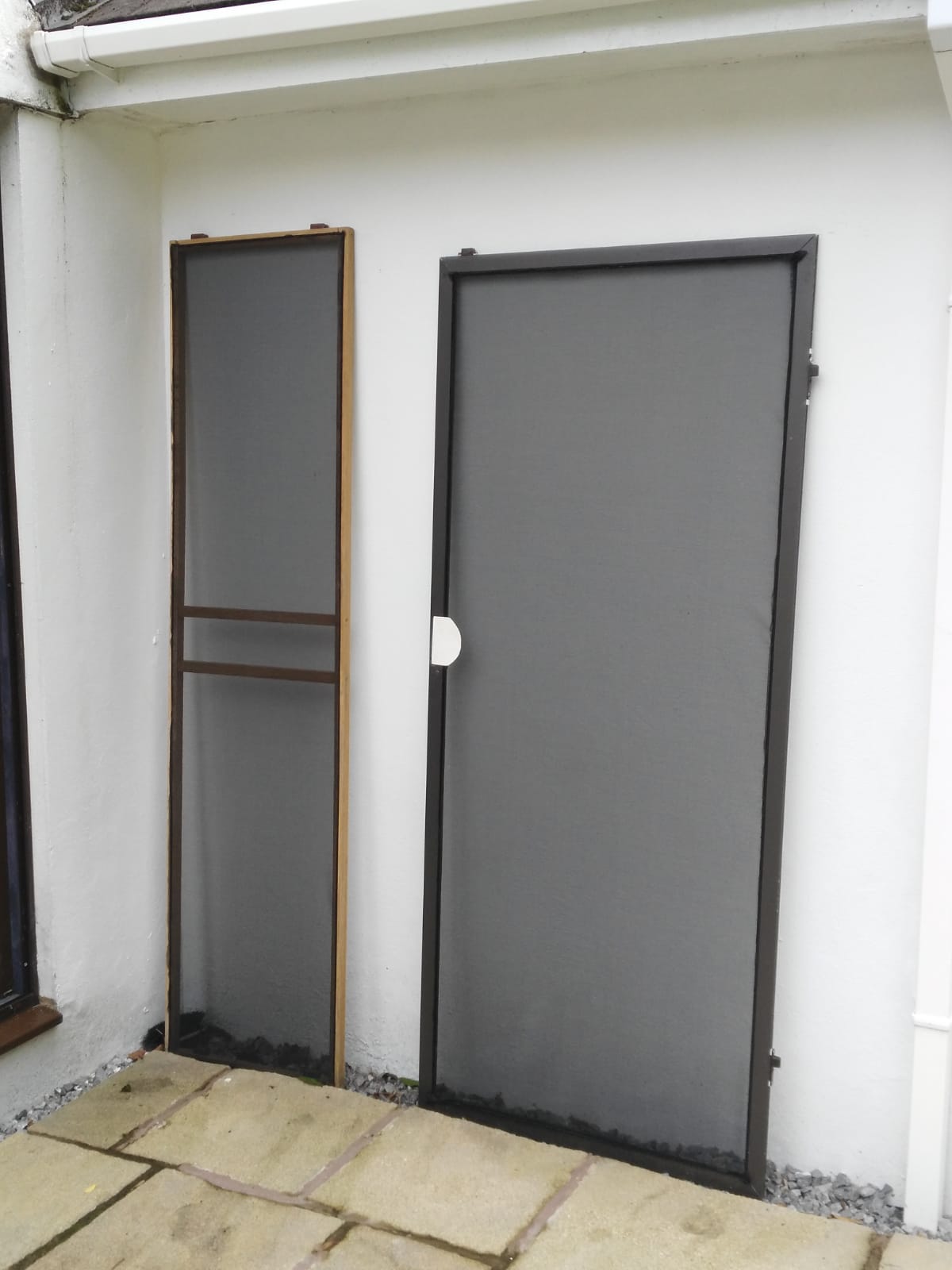

I use these to assuage my wife's desire to turn back nature, even tho' we live in it! Flies are a no-no. The narrow one works for my conservatory, which has externally mounted sliding doors. 4 cabinet magnets hold it in place, and we just use one door. Works a treat. Made from 1" sq oak and some mesh from Newblinds. The other one is aluminium, and I hang it in the exterior reveal of the back door. Magnets again to close it. Again, refurbed after 18 years with new mesh. (The mesh ain't cheap!)
