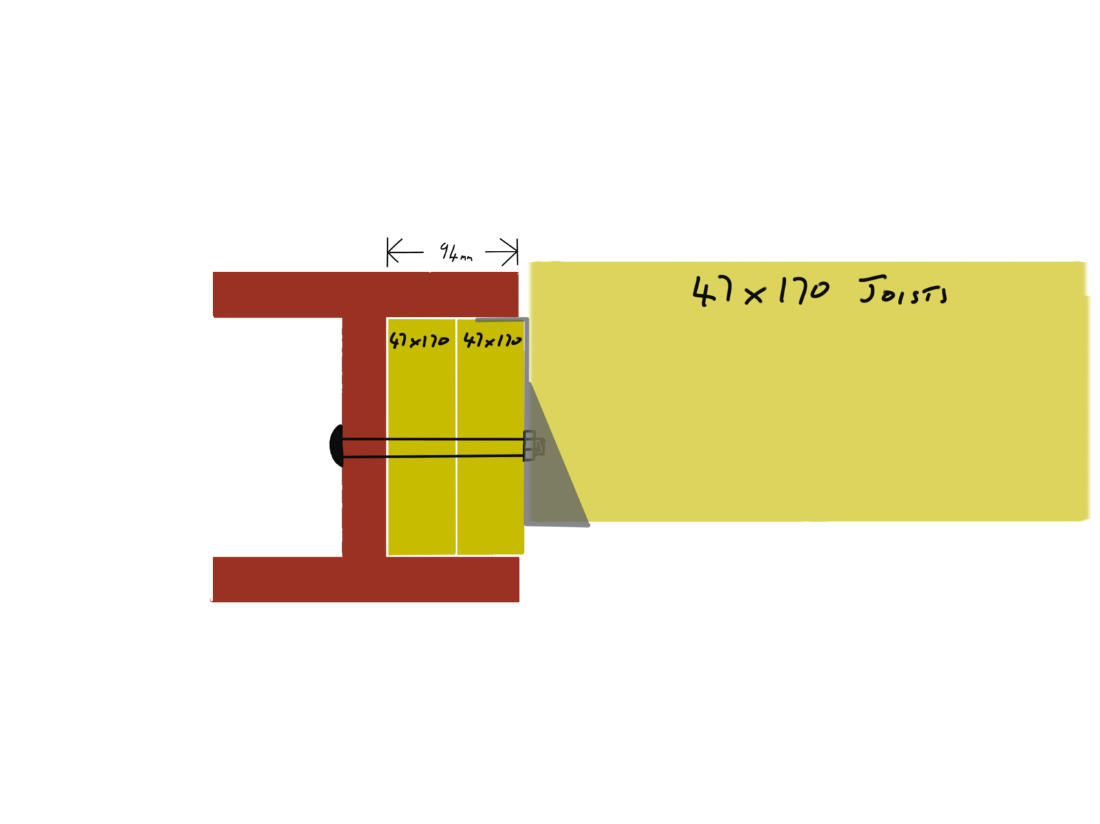

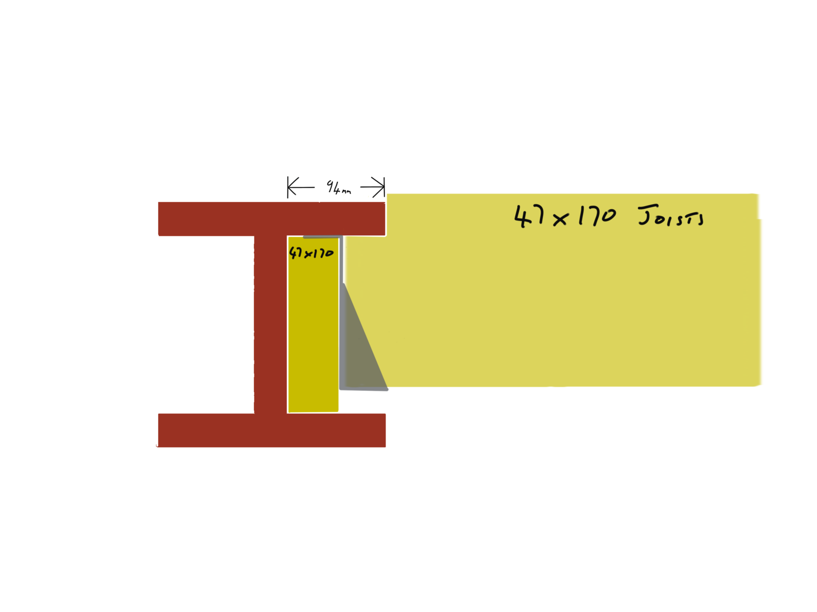

    Hi Guys,
    I have seen both these methods following internet searches, but in the UK with current Regs, which of these is correct please?
    Thanks.
    Option A
    Option B

    Why not deeper joists, rebated into the 'base' of the beam, and flush with the top, and no hanger?

    I was thinking about cost CG, the iBeam is a 203/203/46 so the joists would have to be at least 203mm high instead of 170mm. I will look at the cost difference though, when you take away the cost of 14 hangars and 5m plus web plate it may not be that much difference. Thanks.

    Plus the time involved in doing the steel drilling, and getting them all level?

    Christ, just tell him why you think both of them are wrong. I know at least one of those methods that has been specified by an engineer and accepted by Building Control.

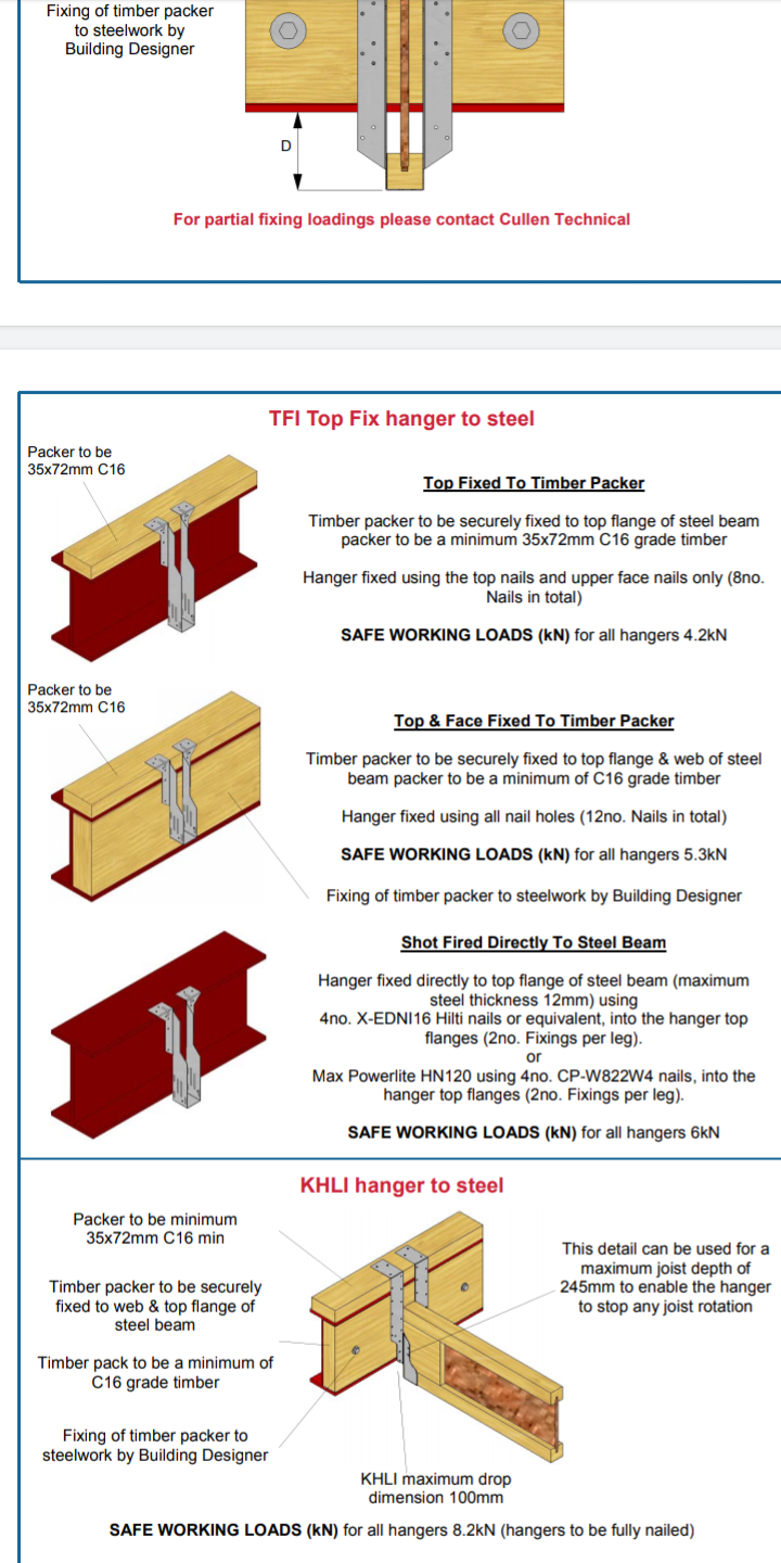

    I hope this helps:
    Alternatively you could fit straight into the web (with the additional need to provide suitable strutting to prevent rotation) but there's less info about this around - presumably because the joist hanger makers can't sell you anything if you do it that way!
