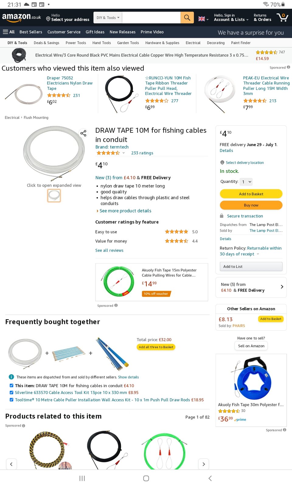

I ran some 25mm flexi conduit for 2 outside lights before I lined and plastered the wall. I didn't leave pull wires in them as thought they weren't needed for such a small run.
I didn't realise the inner face is not smooth and where the conduit bends at a right angle to go through the wall I can't get a cable or pull cable to get round the corner.
Are there any methods to resolve this before I cut holes in the wall to fish through?

Screenshot_20220626-213131_Chrome.jpgThis drawer wire many help.The bends could be a problem.
A few videos on YouTube showing using a vacuum to suck a piece of string with plastic on end through conduit. Give it a go and let us know if it works.
That's the wire I tried. Would pass the 2nd bend. Will get the vacuum out tomorrow
