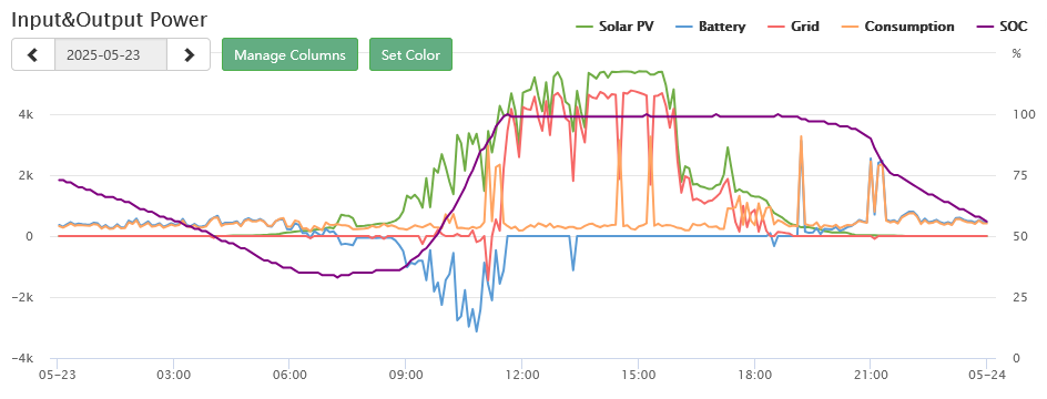

Next year I may change tariff, so seems pointless looking forward 10 years. Artisan Electrics did a video, and I thought until watching it, I had simply made a mistake, but watched the lengths he went to fitting it, this is with 9.3 kW of solar panels, and 27 kWh of battery storage, makes my 6 kW and 6.4 kWh seem rather small. My battery is not fully charged without using off-peak until around 11:30 am
Now I use off-peak, it is charged earlier, so back then
this was what went on that day, so even with my system had I got such a huge battery I would have had space left, but since only using 10.6 kWh next day it would be full, but the next day I only exported 0.7 kWh, so unless using off-peak, I would have been left with very little DHW.
So to ensure a supply of DHW every day central heating not running, having off-peak heat the water makes sense. So using an expensive device to use solar, seems to me, I have waisted my money. A simple time clock would have been better.
