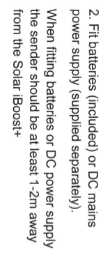

"When fitting batteries or DC power supply the sender should be 1-2m away from the Solar iBoost+"
Solar iBoost Installer Manual said:
When fitting the batteries the sender should be at least 1-2m away from the Solar iBoost+
1715333254354.pngNote the "at least" mine is two floors down. Same in your version to mine. I wonder if the guy fitting the Smart meter pressed the button, I quoted
