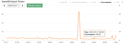

The peak was when I had a shower, but the software seems to smooth out some spikes, as it is not showing the 3 kW when making coffee, and have made 3 cups of coffee today. For a year now I have been moving my energy monitor around hunting for why background is so high, we have had power cuts, so any computer would have closed down, so two printers on line, one inkjet, one laser, there are SkyQ boxes, the router, three hubs, clocks, including smart central heating control, but these should be no more than one watt each, 4 TV's the same.

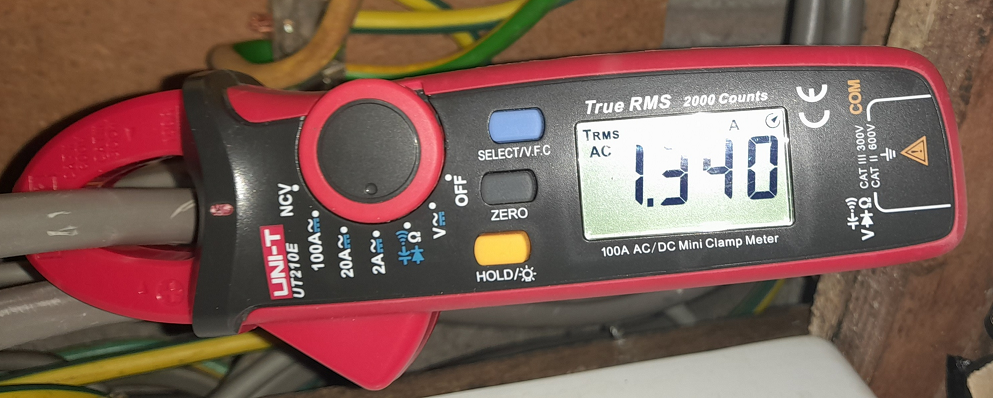

Using my clamp on meter, 1.8 amp approx, whole CU, (414 watts) turn off the 16 amp RCBO to immersion drops to 1.5 amp (354 watts) and the solar display did not change, 325 watt, until I returned to PC when it jumped to 493 watt. So it does seem there is a large delay with the solar panel display,
However, before going down to measure with clamp on the iboost+ said "Water tank hot" and on return also "Water tank hot" which means the thermostat on the immersion has turned off. So something on the DHW RCBO is using around 90 watt. So switched off next to tank, when down to measure 1.34 amps, (308 watt) so it does seem the iboost+ may well be using 90 watt even when tank is hot, clearly 90 watt 24/7 x 365 is a lot of power. Specially in the winter months, when the iboost+ never turns on.

Where does the graph come from, your inverter ?

To @fourtytwo Yes, graph is from inverter. I know the iboost+ feeds the immersion heater with DC, and it can feed it a varying amount of power. It is not in hindsight really required, as once we have the export tariff sorted, the amount we pay zero to 5 am is less than what we get for export during the day, so it would be more cost-effective to have a simple timer and heat the water overnight.

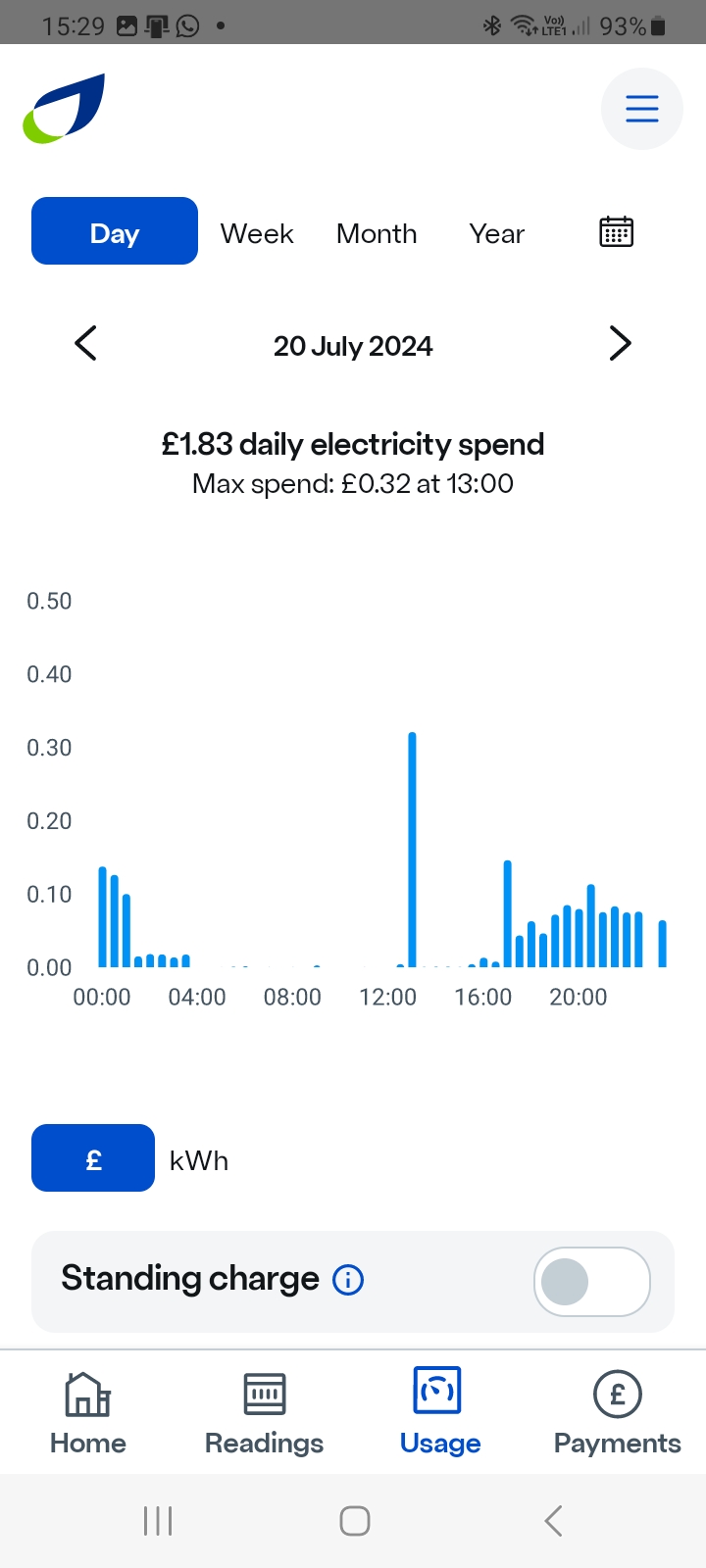

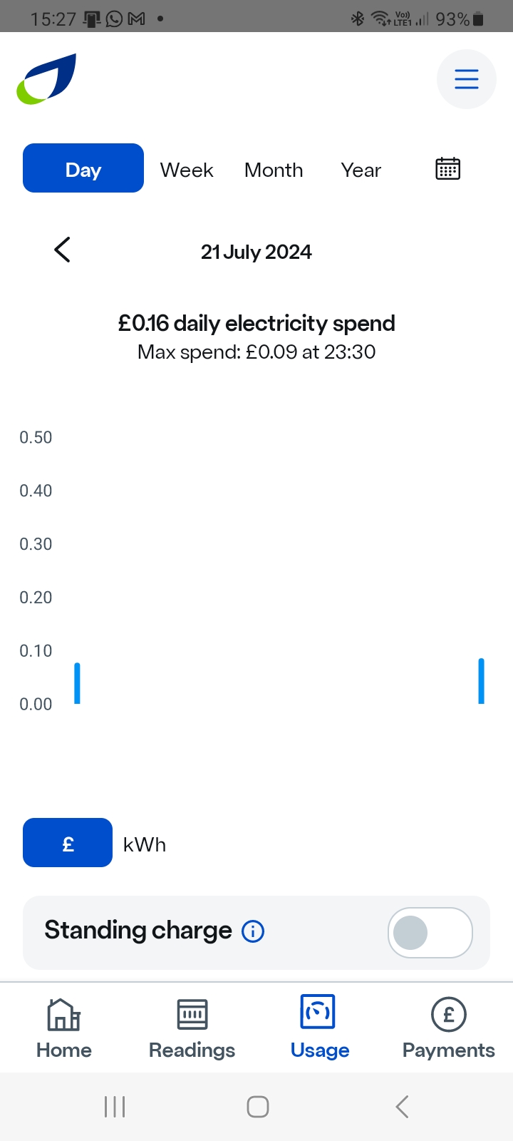

As to smart meter, I tried to read it direct, and it seems I have to press a button to scroll through the data, but in real terms no idea what I am looking at, the solar data may be a few minutes behind, but the smart meter on the phone has for the first time today since being fitted, shown power used today. 1721572117890.jpeg but lacks time, yesterday 1721572191650.jpeg more realistic. It cost £2.42 yesterday, of which 59.14p was standing charge, is it really worth worrying about power used, when it cost £1.83? It says max spend £0.32, so that's the cost of having a shower. The inverter can't supply all the power to have a shower, so today 3.410 kW was drawn from the grid for me to have a shower, it shows it used 6.522 kW I am sure my shower is at least 8 kW which is why I realise can't really trust the solar software to be spot on.
As to @big-all to be frank, 10 watt not worth worrying about, what I am looking at is 1.340 amps 1721573294721.png or 308 watts which does not include the freezers, I can account for 50 watt on stand-by equipment. But 300 watt is going a bit OTT, and I would like it to drop to a level where the battery lasts until cheap rate starts.
As again to smart meter, it shows direct debit of £81.35, and a account balance of +£740.31 and used in June £38.19 including standing charge, £20.45 without, I thought the whole idea of smart meters was you only paid what required, now I know idea is charge more in summer so you have same charge in winter, but I look at the year so far 1721574359782.png and I think they are holding far too much of my money, think I would perfer to see it in my bank not British Gas's bank.

As for your missing power presumably the chart is the total of all outputs (both to grid, micro-grid & battery) and may simply be inverter input power.
