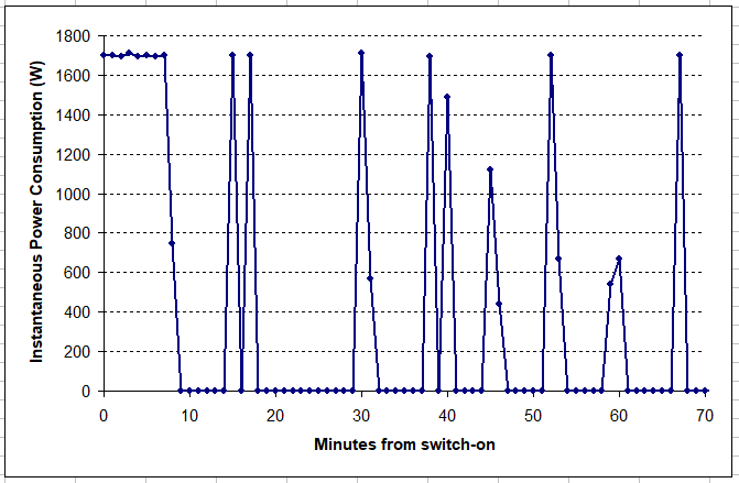

All of this discussion about temperatures/resistance of elements and power consumption is all very well, but in terms of (total or average) energy usage over a period of time, people seem to be ignoring the most important factor - namely that the thermostat will be turning the element on and off (more often 'off' than 'on' once the oven has warmed up), so that, no matter what the power used when the elemnt is 'on', the average (hence total) over a period of time will be much lower than that.

I've posted the graph below in the past. As I've previously explained, I don't have an electric oven, but I do have a (thermostatically-controlled) 1,700 W fat fryer. As you can see, after initially being 'on' for about 8 minutes, until it gets 'up to temperature', the element is just occasionally 'on' again for 1-2 minutes, to to 'top up' the heat to the required temp as it cools down. I would expect an electric oven (or a hob ring etc.) to behave, conceptually, in much the same way.
Kind Regards, John
I should perhaps have added ...... Although the peak power drawn was 1,700 W (about 7.4 A at 230V), the average over the first 60 minutes was only about 482 W (about 2.1 A) - i.e. about 28% of the maximum. In other words, during the first hour (from cold) the fryer consumed only about 0.48 kWh ('units') of electricity, as compared with the 1.7 kWh it would have been had the element been 'on' continuously.
