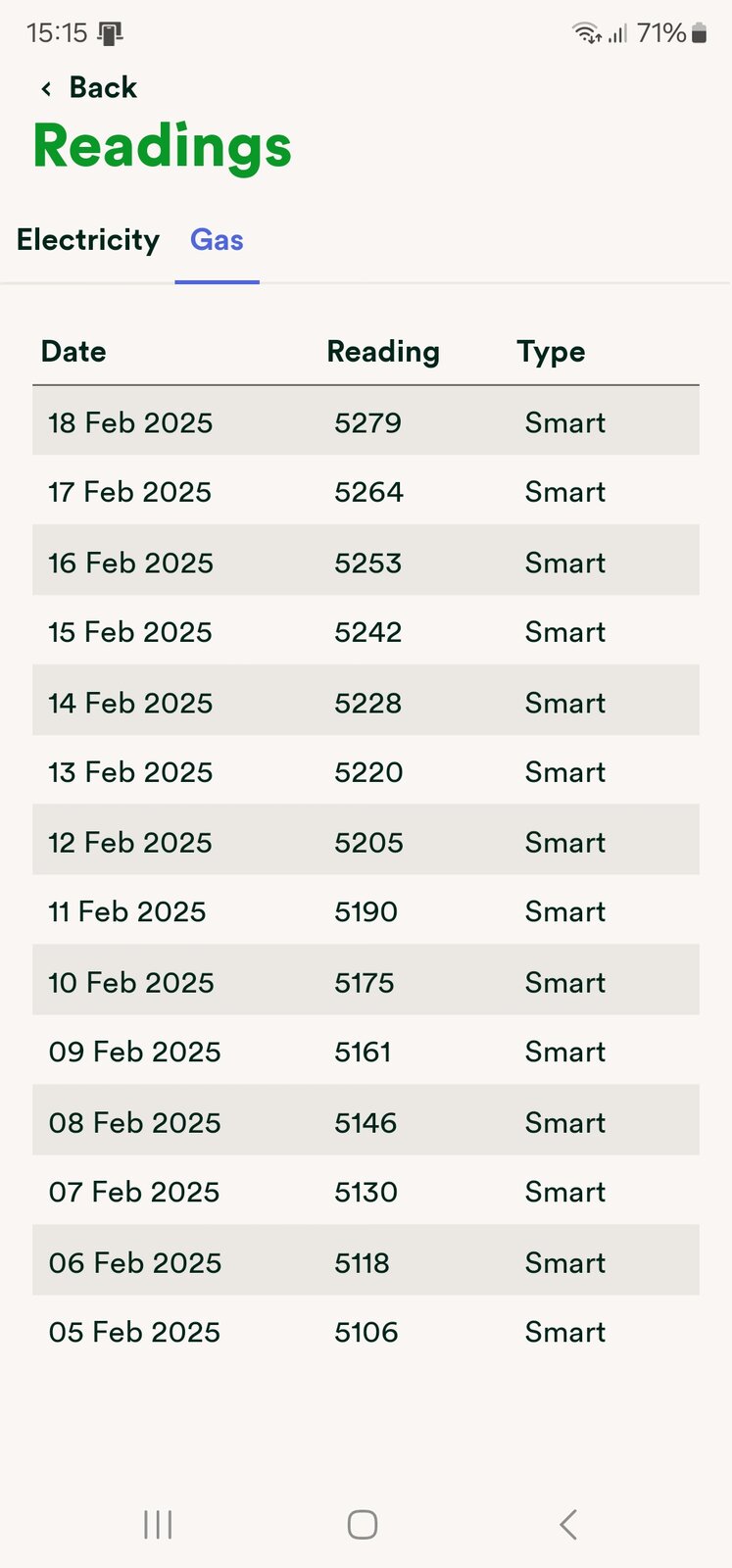

Yes, we have a smart meter. Screenshot attached for most of February.

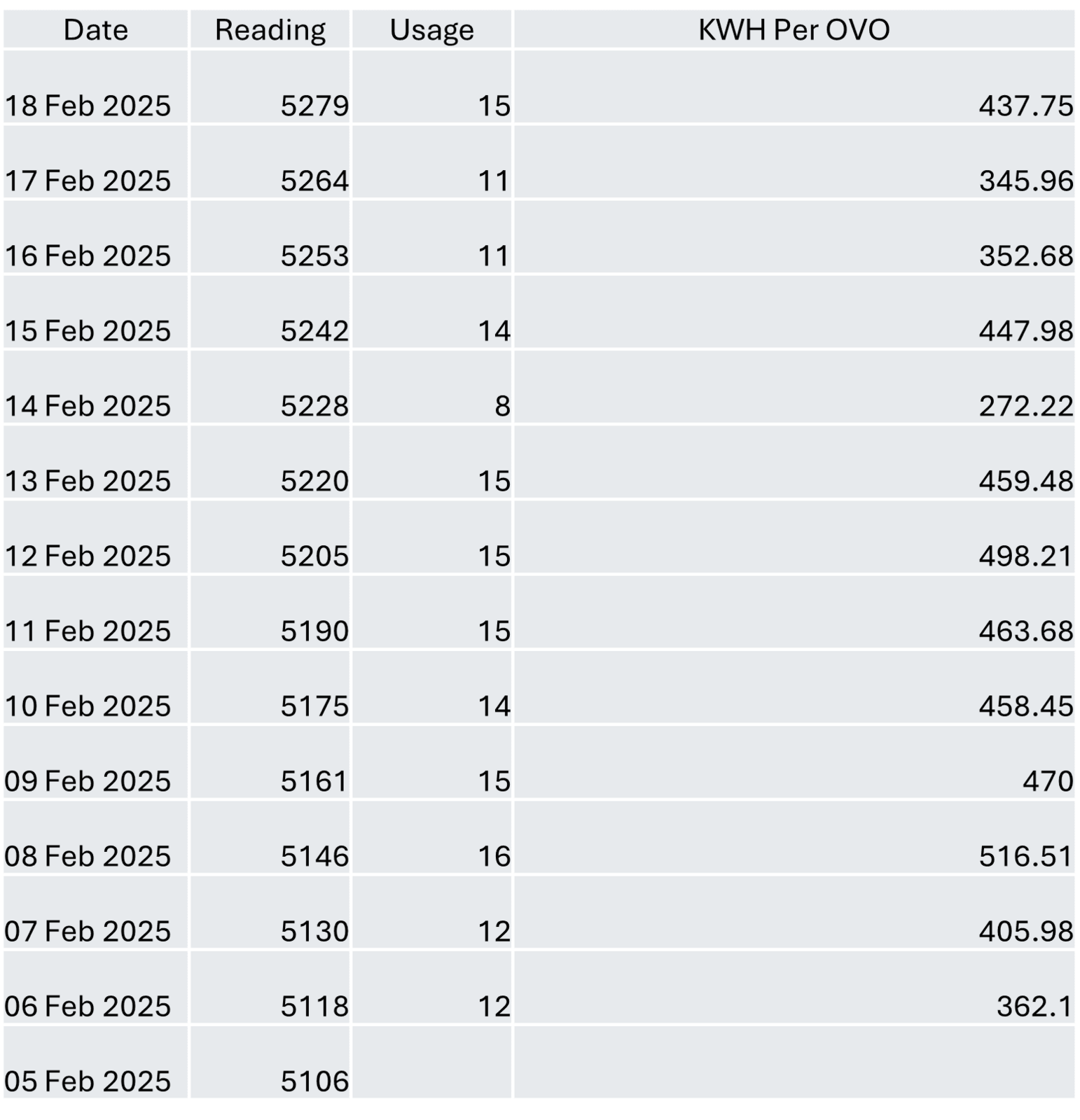

Unable to pull from OVO, but took the number they reported and added to the meter readings. Hope this helps.
Youv'e averaged 12.36m3/day, 12.36*11.0, ~ 136kWh/day.
They seem to have taken the unit readings as ft3x100 and x by 31.66 to give kWh, a nice little earner.
Oh that's a shame. The app normally shows usage in kWh as well as the meter readings in m3. I would have liked to have seen that screenshot! It's all very suspicious. I can't imagine how it's happened. Bizarre.

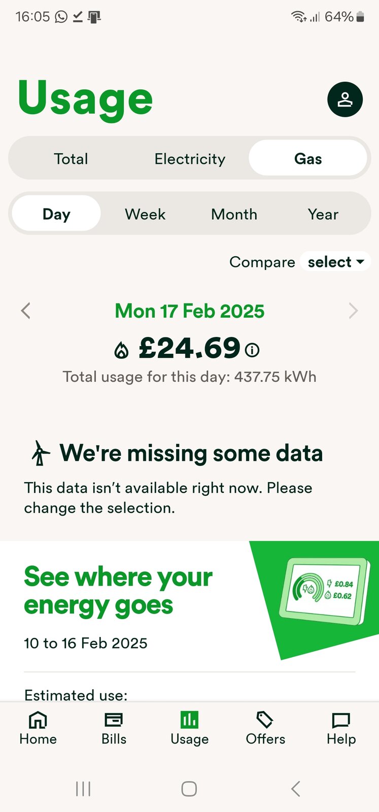

Those are the kWh numbers reported on the app daily. Just wasn't available in the same format. Here's where I got the kwh data from.
Thanks. It's crazy. It can't just be you. These things are done by software programming. Did you say others on a forum are having the same problem?
I would contact BBC Watchdog or Which magazine.
