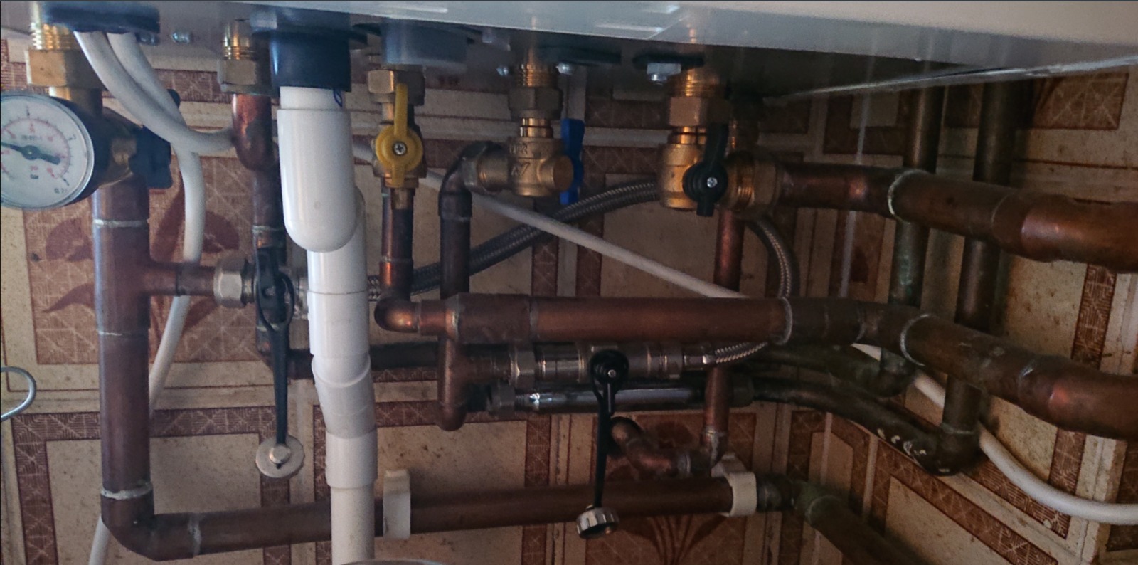

Hi, I'm hoping someone can help me with advice on repressurising my Ideal Esprit Eco - I'm trying to avoid having to have a professional come out just to turn a couple of taps and cost me a fortune!
The pressure has dropped below 1 and I need to repressurise, but I can't for the life of my work out how. I've seen some advice that I need to turn the taps on the filling loop (which is the silver pipe with the black taps which things hanging from them at either end, I believe?) but the bottom most black tap does not turn for anything even if I start to apply pressure. Not being an expert I don't want to break anything!
Anyone got any advice, or is it time to give in and ask for a professional to come show me how?

It is the two black levers ,each end of the silver braided hose. Try turning in the opposite direction to what you tried.

Thanks, I tried again but the bottom one will not move in either direction, applying more pressure than I was already trying just makes the pipe wobble. I don't know if it's been closed off too tightly by the last person to do the pressure maybe?

I would be the wife if I were married and I'm not sure more pressure will help since the pipe wobbles when I try to add too much :)
The next checkup is in a few months, but obviously that leaves me to get through winter with low pressure potentially meaning I won't get heating unless I can get that pressure back up which is why I'm looking for assistance without having an extra visit.
Supporting the pipe with one hand ,whilst turning the black handle ( with a pair of grips ,if you have any) should free it. They can't really be overtightened ,but they can partially seize up if not operated for a long period.

Get a pair of pliers Viki be firm bit not aggressive. Sorry I got your gender wrong!

I gave it a shot, supporting the pipe and applying a little more pressure than I had been and it gave in and moved. I've now been able to top up the boiler - thank you! Don't think the pressure had been touched since pre-covid so that seems likely :)
