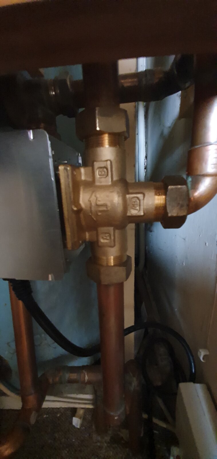

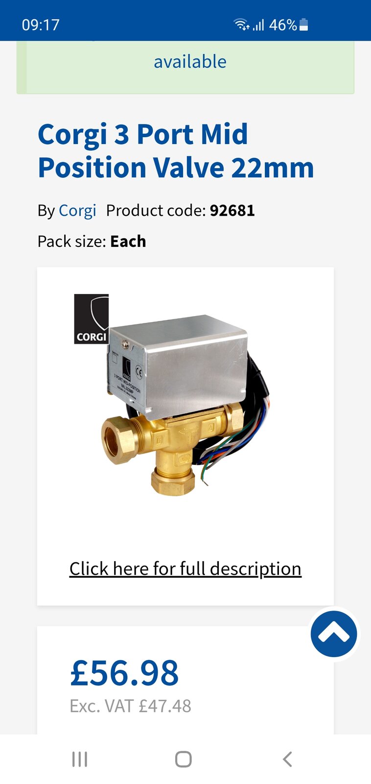

Did you change the whole valve including brass body ,or just the actuator ?
hi changed complete unit for one in picture

a few weeks ago it all started and just the actuator was changed and again it worked for a few days that time and then went back to heating rads so i just started using the emersion to heat water but sods law this packef up yesterday so had no choice but to try and sort the boiler,, so this time changed complete unit but like say it hasnt worked

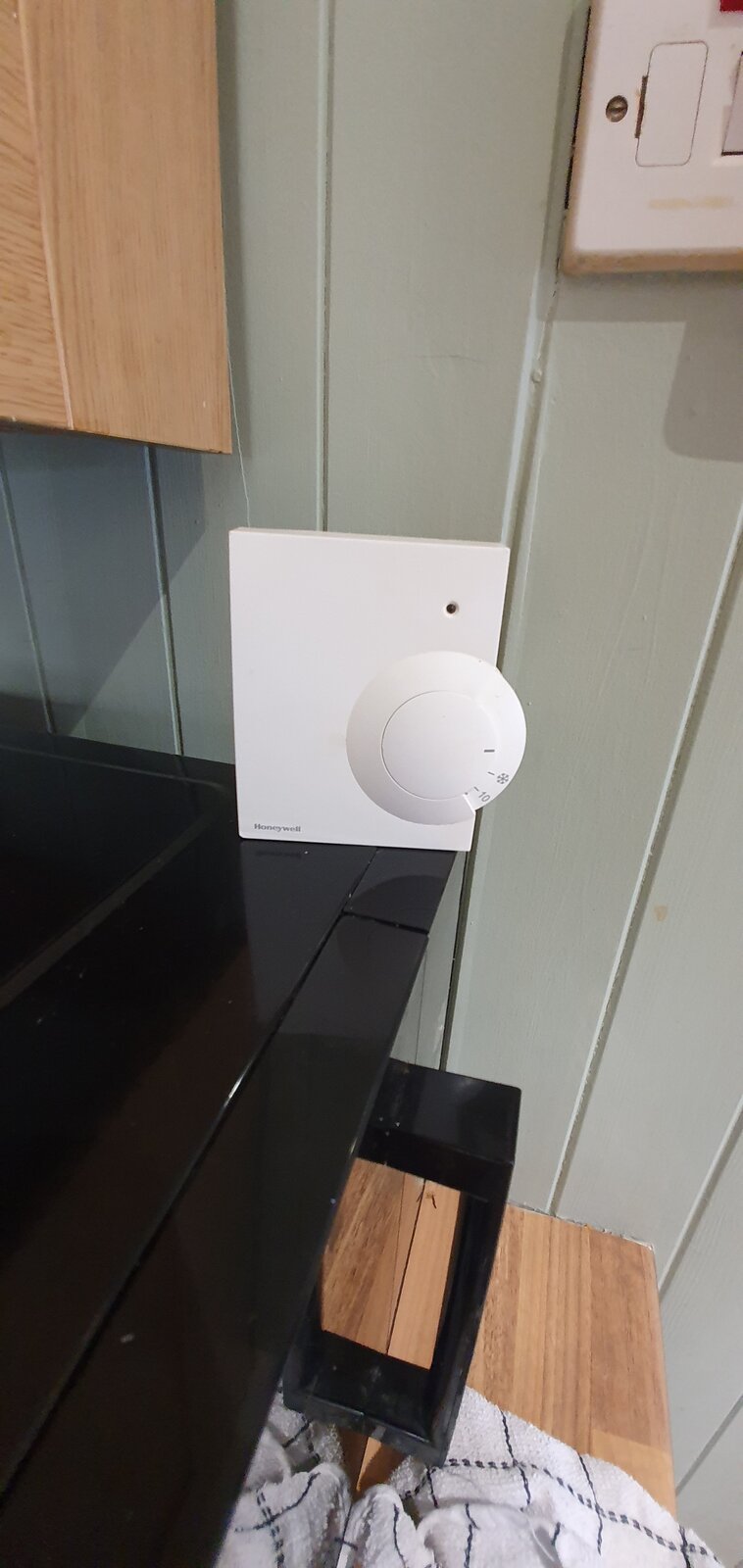

When the radiators are heating ,whilst programmer is set for only Hot water , if you turn your wall thermostat down to zero ,do radiators then start to cool ?
yes have a meter and think im competent , il try that when get home in hour or so thanks

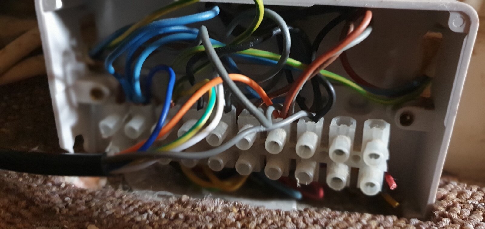

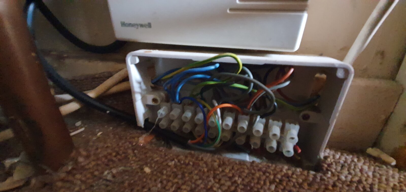

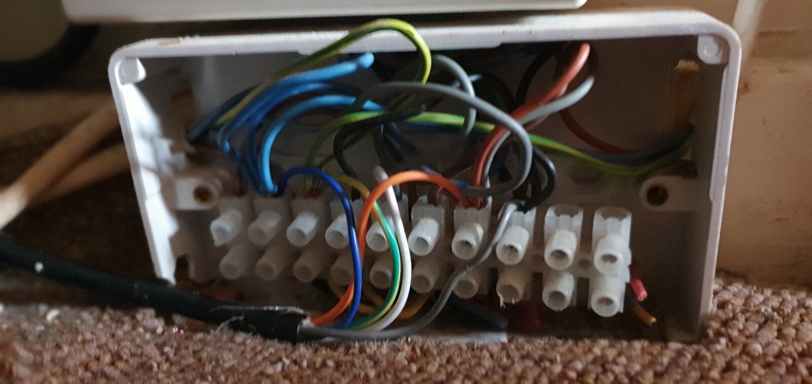

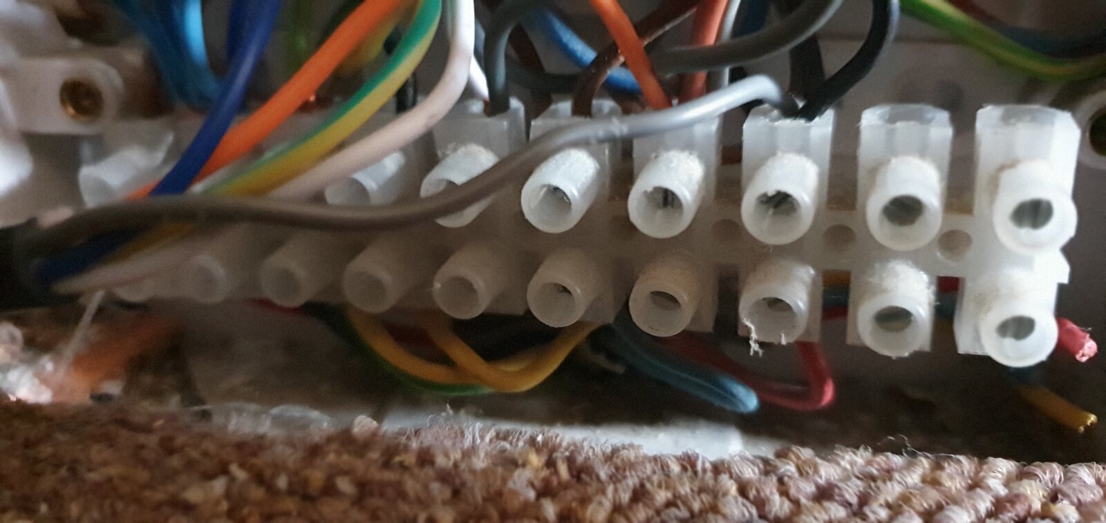

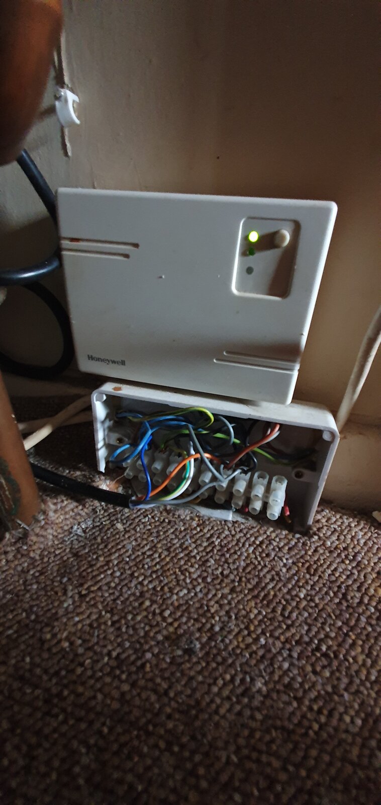

Would be helpful to show a picture of the wiring centres wiring / terminals.
hi home sooner than thought, turned water on and thermostat down but rads still get hot,, will post pic off wiring shortly

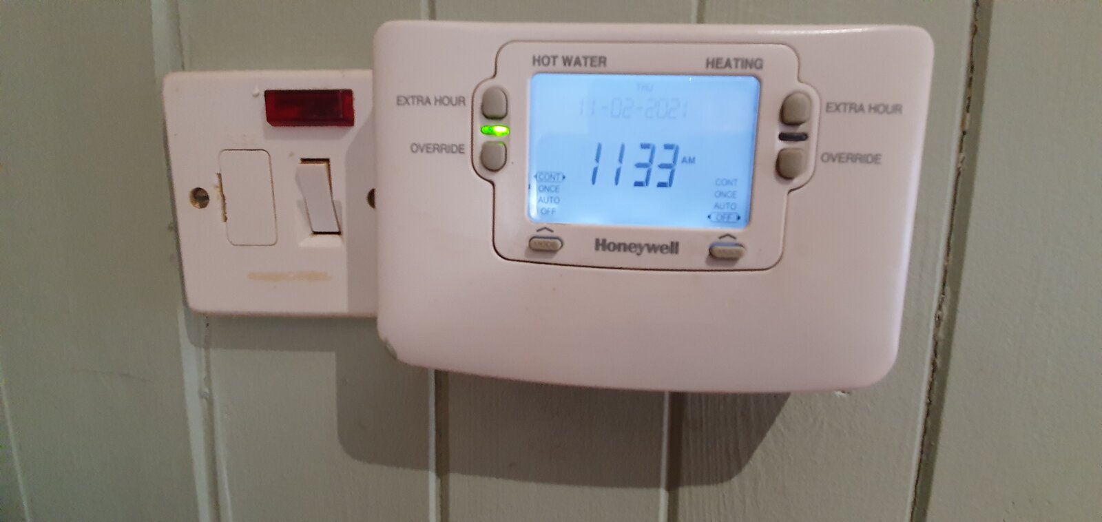

Pic of thermostat and programmer would be useful ,with programmer on hot water only mode.

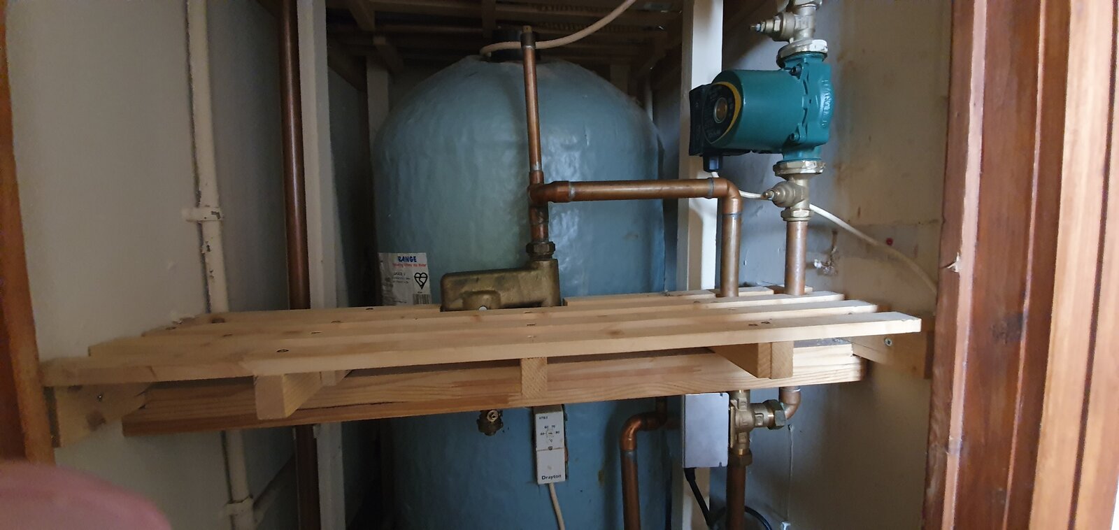

Post a pic of the Mid position valve and the pipe work it is attached to
hi few pictures off wiring , the mess off wires is not my doing lol
Going from left to right on terminal blocks ,terminal no 5 looks to have the white wire from MPV ( the 3 port valve) and one other wire ( looks like black ) is there any other wire in that terminal ?
If not measure voltage from that terminal to the Neutral terminal. Also from terminal 5 to earth .
And tell us what voltages are.
Programmer in hot water only mode.
And room stat turned up to 20 Deg.
