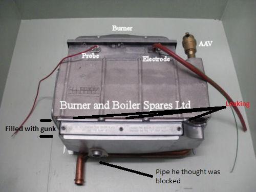

Just had the plumber round, he had worked on quite a few of these in the past and echoed what everyone here has said about it being total rubbish.
He took the cover plate off the bottom of the heat exchanger and it was completely full of some kind of ash like deposit which he cleared out and he thought this was blocking the pipework and sump causing the leak.
Unfortunately this didn't fix the leak and he said whilst he could change the heat exchanger (and had done one in the past) I should consider replacing the boiler because the labour time was about the same and I would still have a 13 year old boiler.
Worked on quite a few yet thought that was blocking the pipework? What would replacing the hex do?
He doesn't like repairing these, a very bad repped boiler but can be fixed, for the fault you describe much less than a new one.

The image explains it better
This part is called the Heat Exchanger kit.
He said the corrosion inside is caused by the unit retaining water which is slightly acidic and damages the alloy because the pipework is blocked.
I don't know if he is right about the cause but certainly the effect was visible for even me to see.
How much would you charge to repair this fault?
M0t, here is a VERY big hint. The bottom of the heat exchanger is full of muck- well, this should have been removed during service
If this muck is cleared out here and elsewhere then boiler will be back to normal. Sad thing is most run around saying how bad this boiler is ( show me make and model that is faultless) but fail to establish boiler operate sequence to then start changing parts.
m0t, go ahead replace the heat exchanger. You will find the new unit will also leak as fault would seem to be elsewhere. :wink:
The heat exchanger has corroded all along the front joint, the metal is no longer flat so will not seal. The part needs to be replaced, a service will not put the dissolved metal back where it came from.
The dealing face which I highlighted above looks like the surface of the moon. I don't doubt that servicing would have prevented it but there is no way it will fix it.
m0t, you are clearly missing the point.
Water is leaking from that area BECAUSE it cannot come out of the heat exchanger. Fit a new heat exchanger and water will still not escape from the new component.
So what should he have cleaned out in addition to what he did?
I got the guy back and he cleaned out the condensate trap properly (it was not free flowing so the water wasn't escaping).
2 weeks later and the boiler is peeing water again (much worse than before), it seems to only be when the heating is on but I don't want to take the chance of flooding the kitchen so have turned it off.
Plumber was supposed to come round last week to chemical flush the system in preparation for a new boiler but didn't get the time. Changing the boiler is now a bit more urgent, can it be installed and then flushed (he said the chemicals needed to be in for a week)?

I did get someone out who cleaned out the heat exchanger and condensate trap (as a previous posted alluded to but didn't clearly state).
