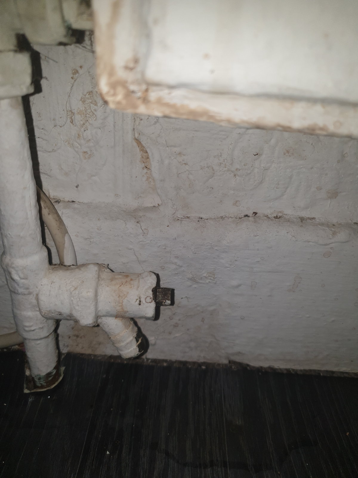

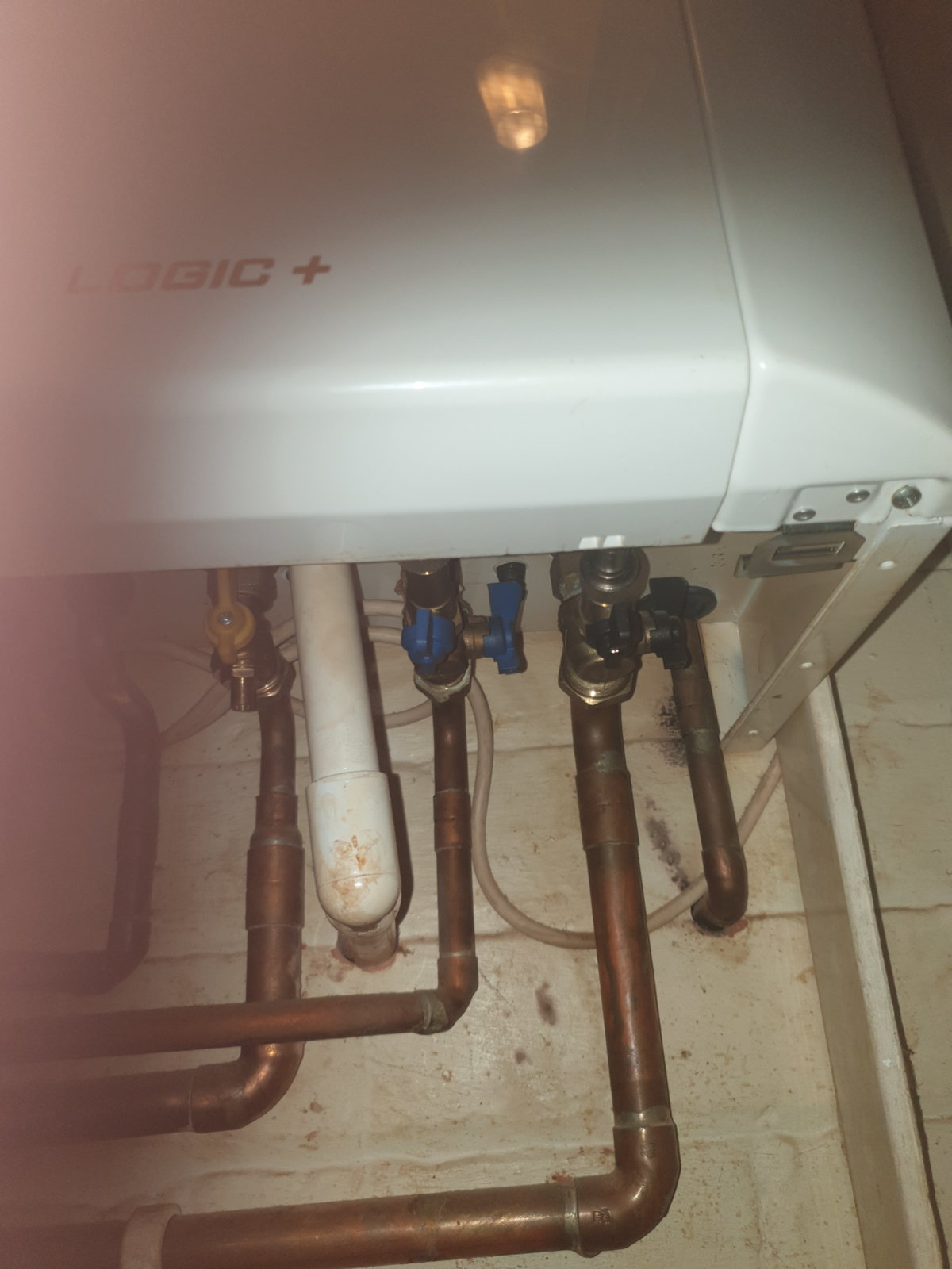

After a drop in pressure, I've managed to add too much into the system. I've been bleeding the radiators all week and the pressure has not dropped at all. I cant quite remember if I've turned the filling loop off... I'll try and upload a picture. Any other help how I can drop the pressure.

How old are radiator valves? You could try draining from a valve with a drain off (if fitted) which will remove more than bleeding. Post a pic of filling loop, also it could be passing if failed.
If that's the filling loop I can see in the pic then yes you have turned the wrong two valves off
The blue and black valves closest to you need turning off and the ones towards the back need turning on

Show a pic of the drain off valve ,for help on what to do.

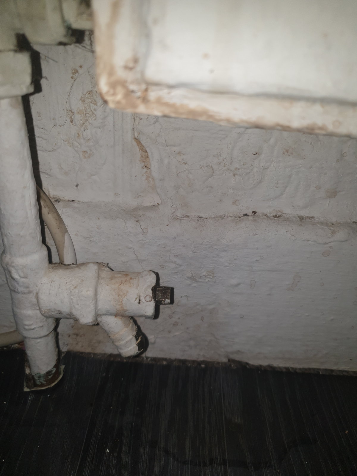

The square shaped shaft on the right hand side is turned ,anti clockwise ,with a spanner or grips ,to open the drain cock ,water comes out the bottom. You can put a garden hose on it ,or just a container below.

Is there a staining on the floor near the drain cock ? It may have been leaking,and causing your original pressure drop ?

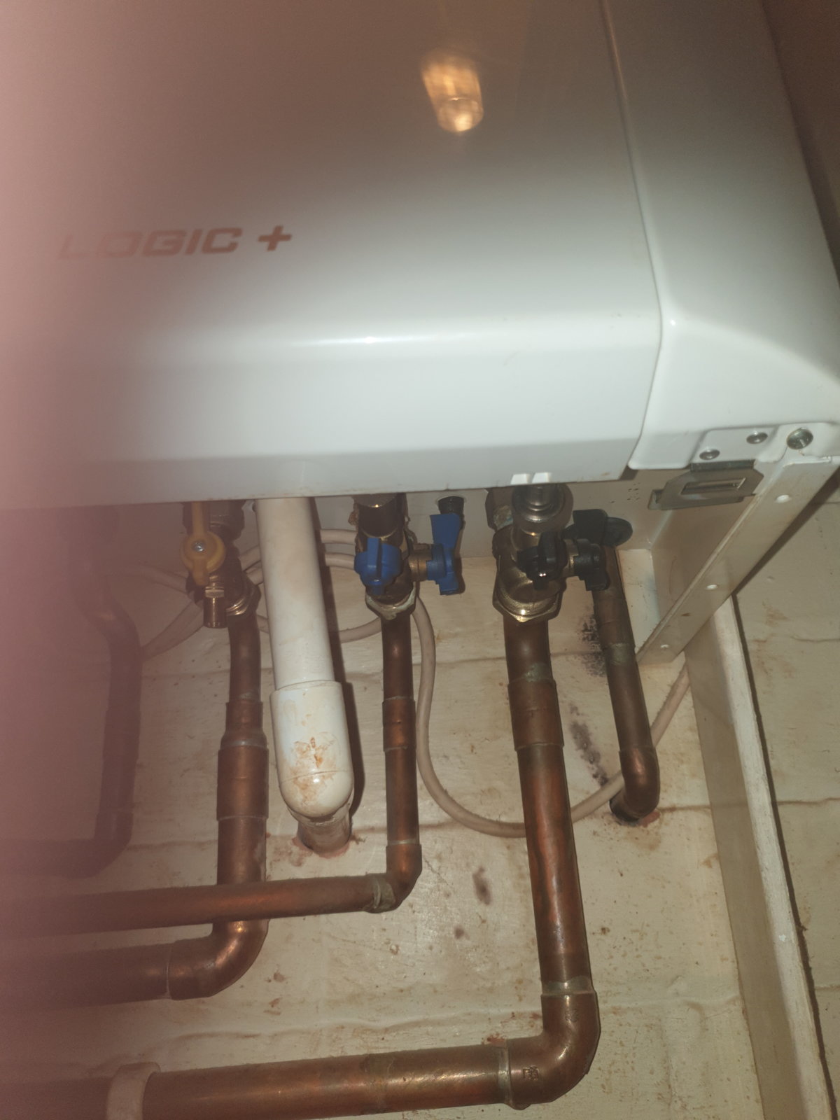

Actually looking at the rear black and blue valves I might be wrong about them being in the wrong position
However the front blue and black sure look like they are inline with the filling loop pipe , if that's the case they are on and no amount of draining will make one iota of difference until the filling loop is turned off ( any chance of a sideways pic of the pipework under your boiler?)
Don't forget you will probably need to put some fresh inhibitor in your system as you will probably flush all the old out
The valves at the front are isolation valves and nowt to do with filling loop.
Apologies mate ,took a closer look and you are quite right ,the filling loop looks open.
