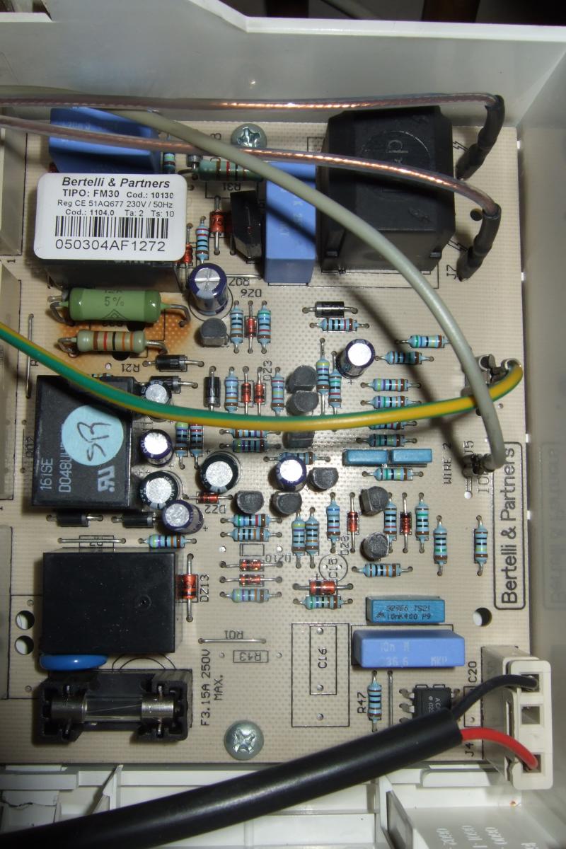

Thankyou Shambolic, I decided to check the wiring on the board as your detail and as you can see in the image the board is not in the best shape. So much for the help at Ideal!
I'll let you know if a new board solves the issues.
Thanks again
That PCB looks fine to me.
There can be so many causes of intermittent FF lockout that its not worth guessing but I find that 90% are a faulty ign PCB.
But as thats expensive then obvious its sensible for a competent engineer to eliminate the other possibilities first.
The fan was not likely to have been any problem.

that pcb may not be ok (you need to turn it over to inspect) and its too late to reply fully as im off out but go here
same pcb same probs same solution 9 times out of 10

It was the PCB got a replacement and boiler worked fine all over winter - thanks all for your help
