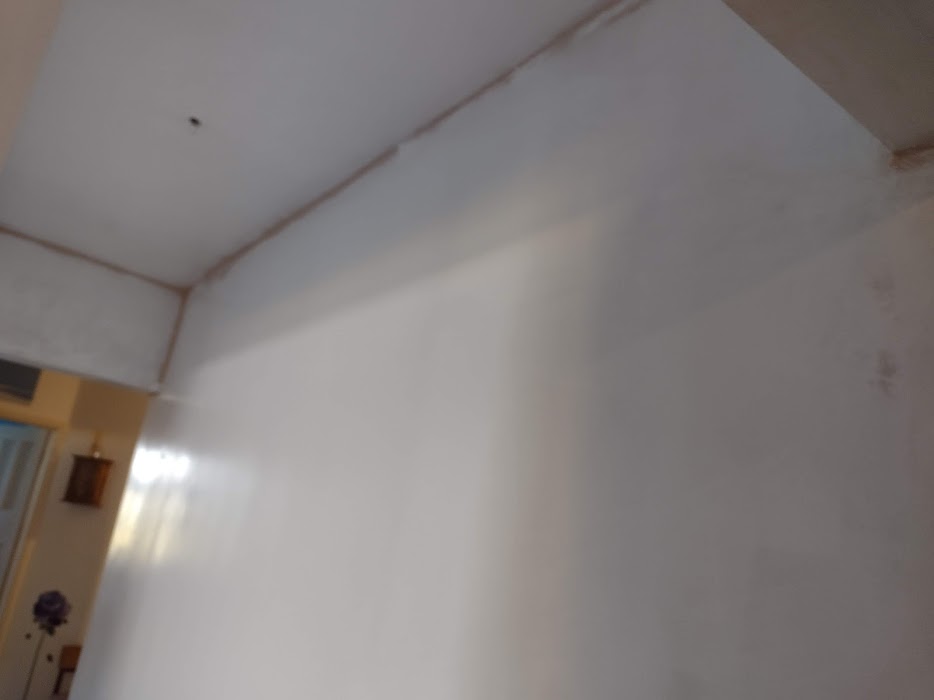

I have this space in the new corridor, and want to put in two shelves for DVDs (currently they are still in boxes and bags behind chairs in the living room!
The space is 45cm high and 290cm long. A typical DVD is 19cm tall and 13.5cm deep ....
So with 20cm shelf space, I could use 2cm thick shelves with a bit of space to spare - that will give just enough space to get a finger on top of a DVD
But, how to build shelves so they look OK and don't sag?
My current idea is to put in a strip of wood above where each shelf will be, say about 2cmx2cm, which will go along the wall and side walls, then screw a 290cmx16cm board on to the underside of these. This will mean the DVDs will also rest away from the wall, which might make it easier to get them out by pushing the ones next to forwards.
But is there a flaw in the plan, and a better option? Don't want shelf supports showing below the shelves if I can avoid it.

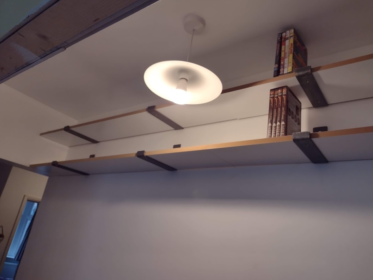

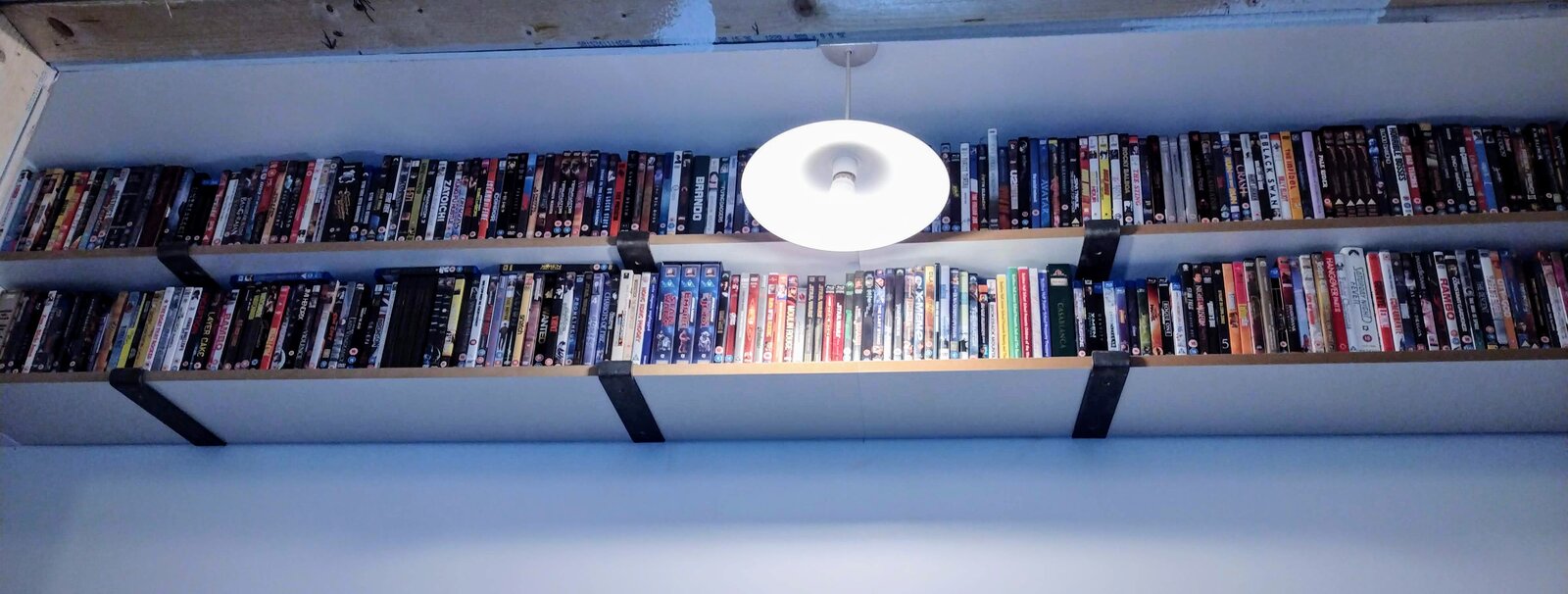

Shelves are up. Decided to get some scaffold shelf brackets and had CutMyPlastic.co.uk make me 4 shelves to fit. Bracket spacing and weight of DVDs won't cause sagging, and no brackets below shelf level. All looks pretty neat too! This is the second time I've used Cutmyplastic, very handy people if you want mdf (veneer and malimine options) cut to size and delivered to your door. They also do plastic! The brackets were ordered on ebay, made by VDS Metalworks.
Job done. Another box and several bags of DVDs (from when we moved 3 1/2 years ago) now emptied and out of the way.
